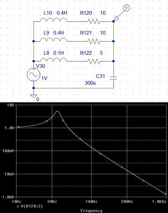

The three ports, all on the same box, "should" result in a single resonance similar to a single port of the same area as the three. Some adjustment for end-effect must be made. But designer sanity must be preserved.
I'd just figure what the three holes-add up to and compute based on that. It won't be quite right, but it won't be very wrong, and it is very unlikely to make much difference. (Note that none of your ports reaches -10dB level.)
True, but only if the OP adjusted the lengths of the ports so they all had the same tuning frequency. For example, depending on length, the two small ports could a produce their maximum output at 75 Hz and the larger port could have its maximum output at 40 Hz. We don’t know the lengths so it’s all conjecture I guess.
I can't see it any way except "sum of the ports" against the acoustic mass inside the box. Like three chokes in parallel, below. The L/R ratio of each port may vary some, but the resonance is all three together, not a separate resonance from each port.
(Assuming port spacing is not a large fraction of the wavelength.)
Fill a bucket with water and drill three different holes in it. The bucket will empty through all three holes in some time, not a different time for each hole.
