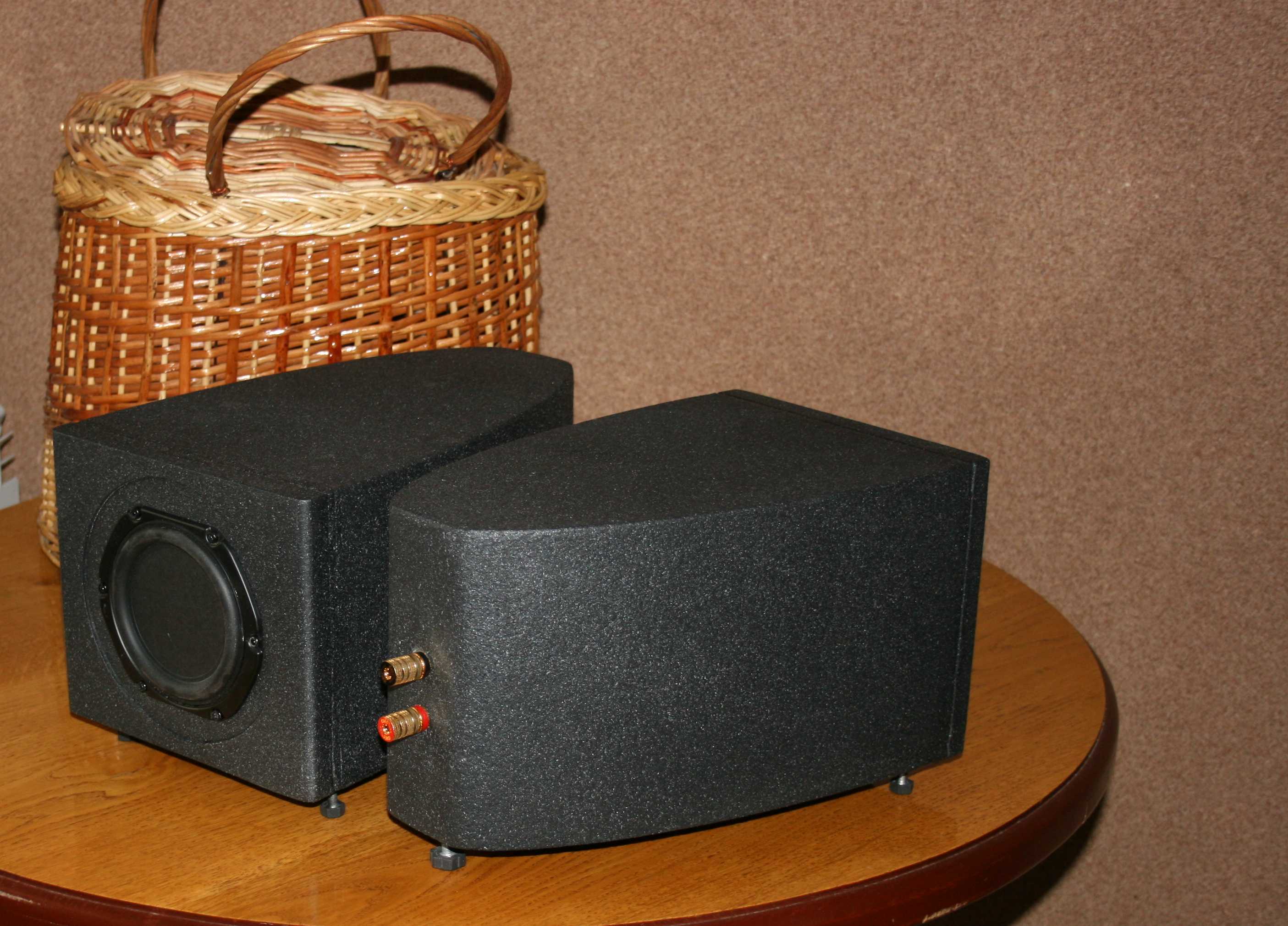

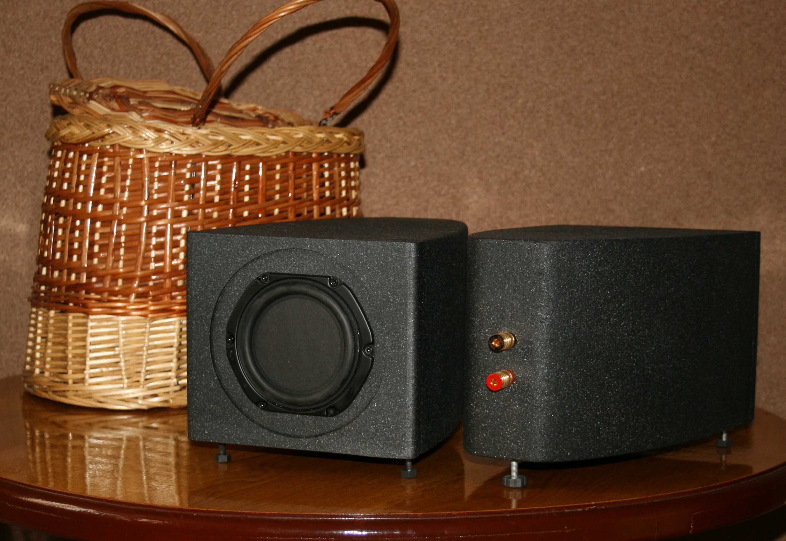

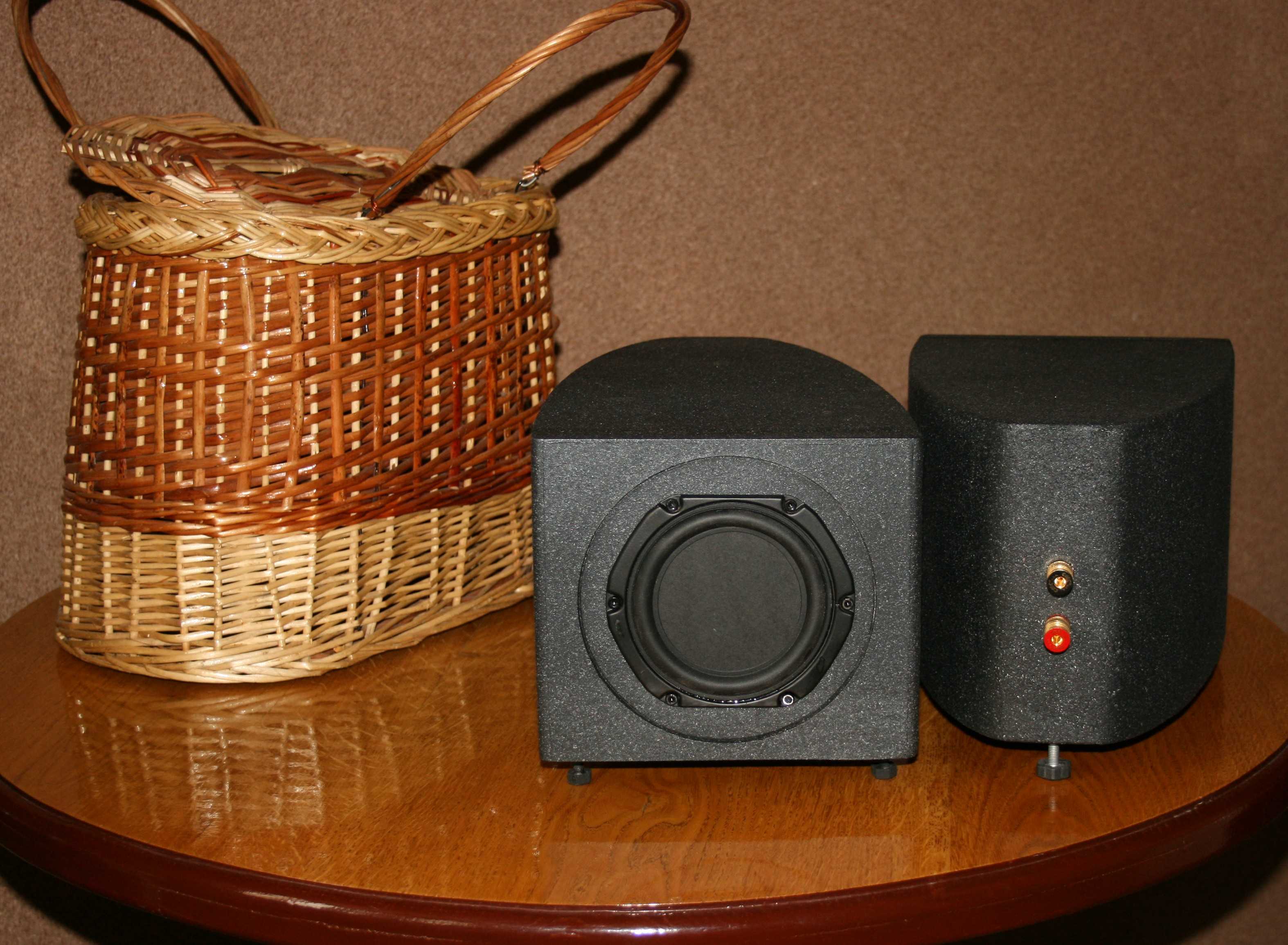

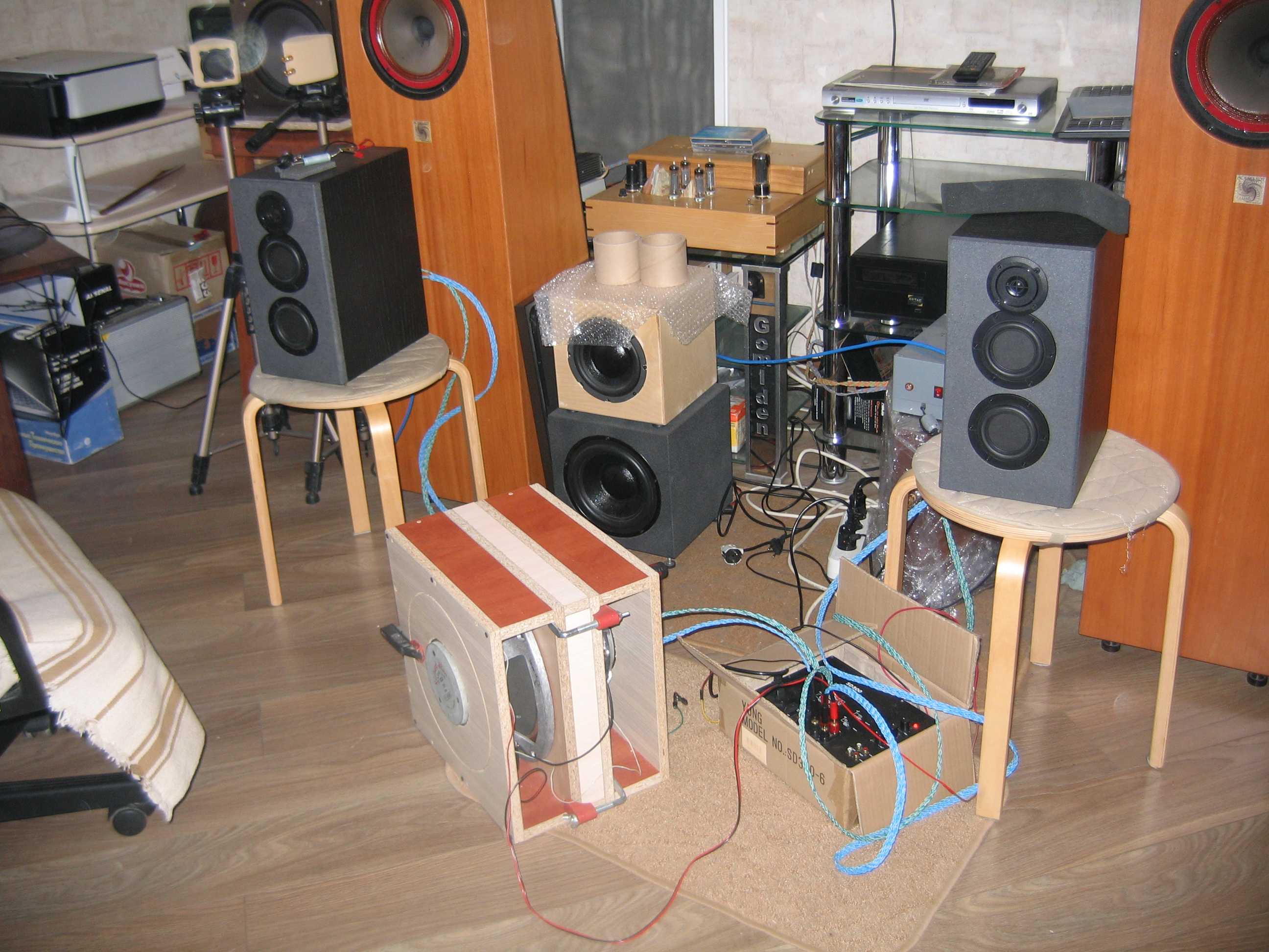

Another one pair of BMR bookshelf speakers 😎:

I like that finish. Is that texture metallic?
I thought those BMRs were good down to 300Hz... you've got it sealed and much lower.
Heavy EQ?
Boxes have a multilayer coating: cork, rubber paint primer and finishing textured acrylic paint. The port is located at the bottom. Measurement is taken without EQ. The yellow chart is made with the support of the Ripol subwoofer.
