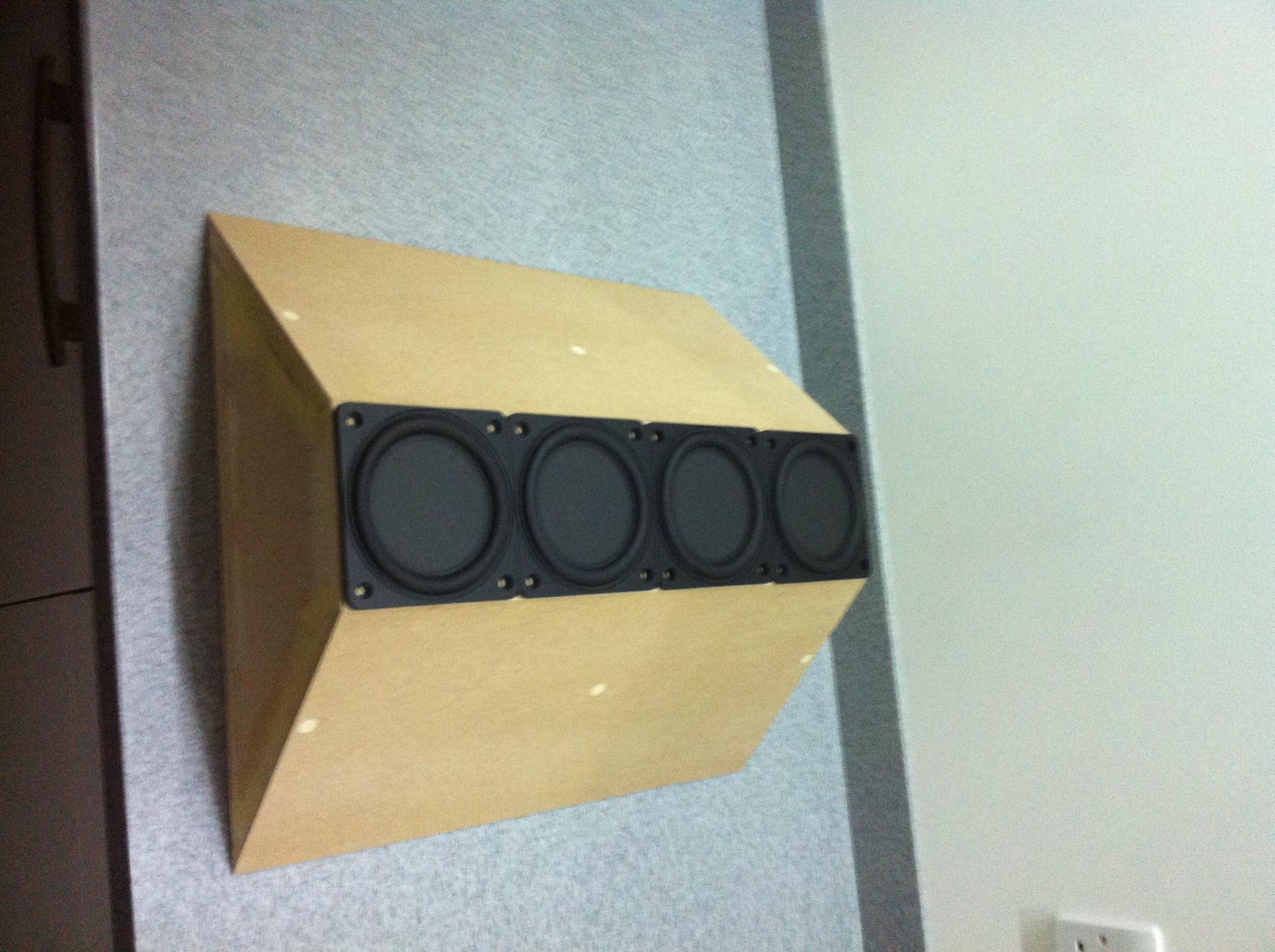

Wow Derek,
I was going to post up a picture of my rough temporary cabinets but I think you'd be disappointed with my effort ! 😉
I can't wait to have a listen to the silk surround model 🙂
Nice cabinets
Hi Jason,
They look cool....Way better than lots of my prototypes!
They will need a good 24 hours of running full range with some punchy bass and percussion to loosen up the rubber surround and stiff suspension.
Loud enough to get a good plus / minus 1 mm cone movement.
If you reverse the polarity on one cabinet that will reduce the SPL if the volume is annoying the family.
Once run in try crossing them over around 80Hz.
Did I give you some solid core silver wire to wire then up?...That really helps the top end compared to stranded copper cable.
Looking forward to hearing your listening impressions.
Cheers
Derek.

Thanks Derek,
I forgot to buy a bit of cable from you when I visited,I'm rubbish at soldering too,I was hoping they'd have press on connectors but they are tiny little solder on tabs.
I'm hoping to cross them over way higher than 80hz to totally relieve them of bass but I'll certainly play around with it,I currently cross my dipoles over to my woofers at 300hz with great results.
Thanks for the advice regarding running them in,I'll definitely do that,I wasn't sure if running in speakers was a myth but the woofers I'm currently using really came alive after a period of use to the point where it started to sound boomy & I had to run the room correction again.
