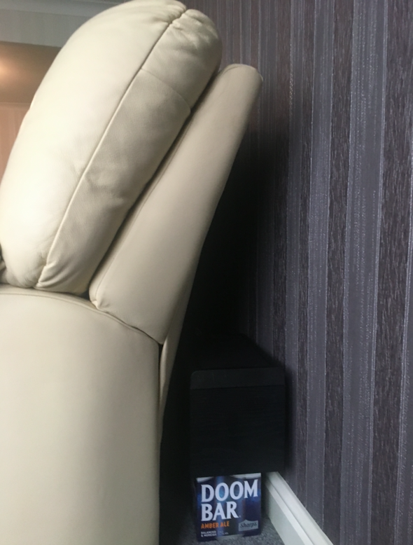

So.... if I had an apartment I would do the BOSS back couch “”without a question”” every day of the week and twice tomorrow.
Why? Well it works great from 10hz all the way to 60hz IMO. And doesn’t create a huge amount of spl but gives all the fun.
How do I know this? Because I have one. Also, I have my minidsp setup so that my “night mode” will turn my subs off and only run my three way mains from 60hz and up and my BOSS couch from 60hz and down (again, NO SUBS ON). My wife who sleeps right above this room doesn’t mind at all (or doesn’t complain) when I watch movies late at night. BTW - during normal listening the couch only runs from 5-25hz and my subs from 19hz and up.
Thanks audiophile, I like it
I'm guessing that the bass from this wouldn't travel far as it would cancel round the back of the driver, so this would be ideal
How much power are you using for this? Being so close, it must be less than 1W
