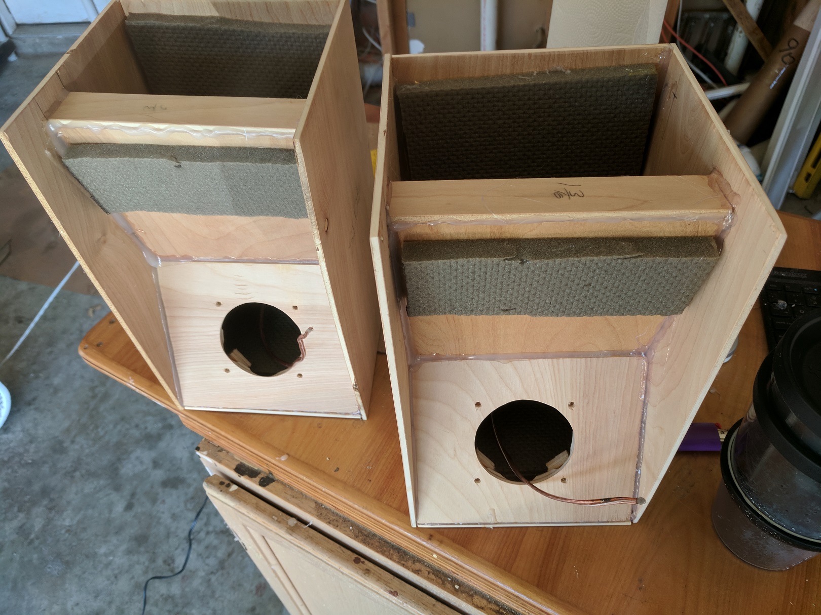

An omni will have overall SPL fall faster with distance than any other ime.
It's all about radiation pattern by frequency, and where the pattern is aimed.

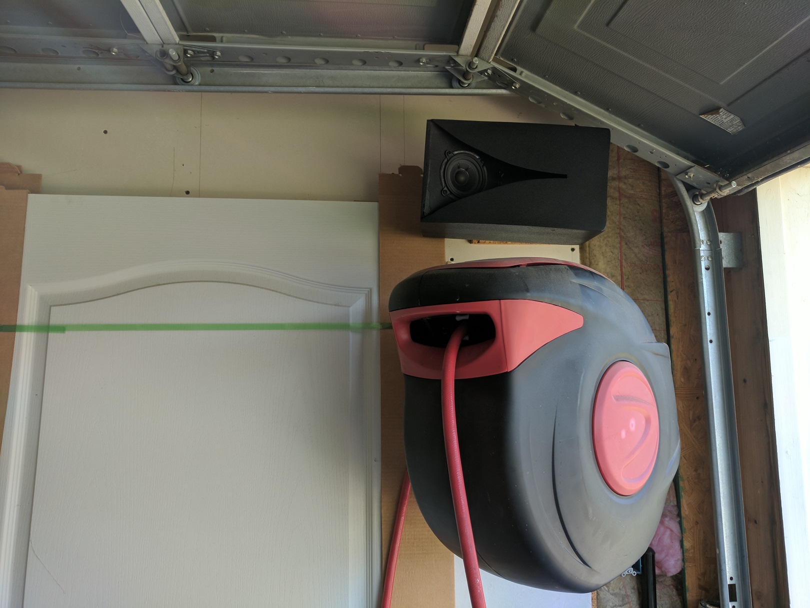

Since your goal is to keep sound inside garage with open doors, I'd just put the speakers up high on the wall with the door, pointing into the garage.
Or at least across the garage, anything but pointed out the door.
I keep a pair of bose 901's in my garage, with their high ratio of reflected-to- direct , for the same purpose. 🙂
This is an old thread that got bumped.
Yep, that's exactly what I did.

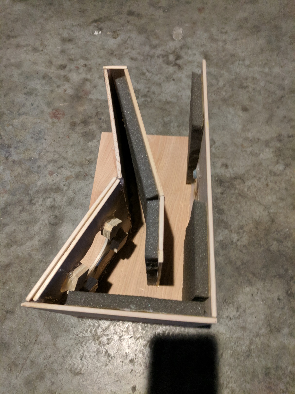

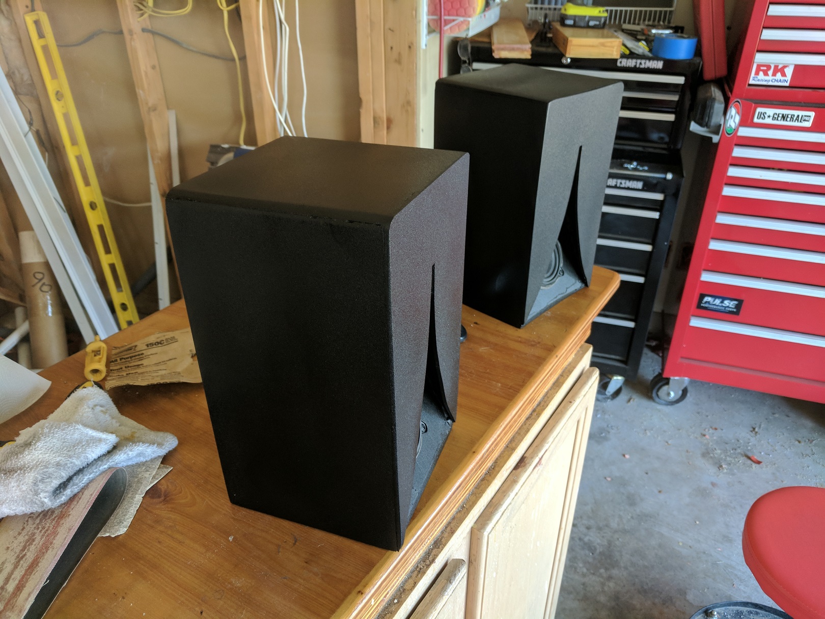

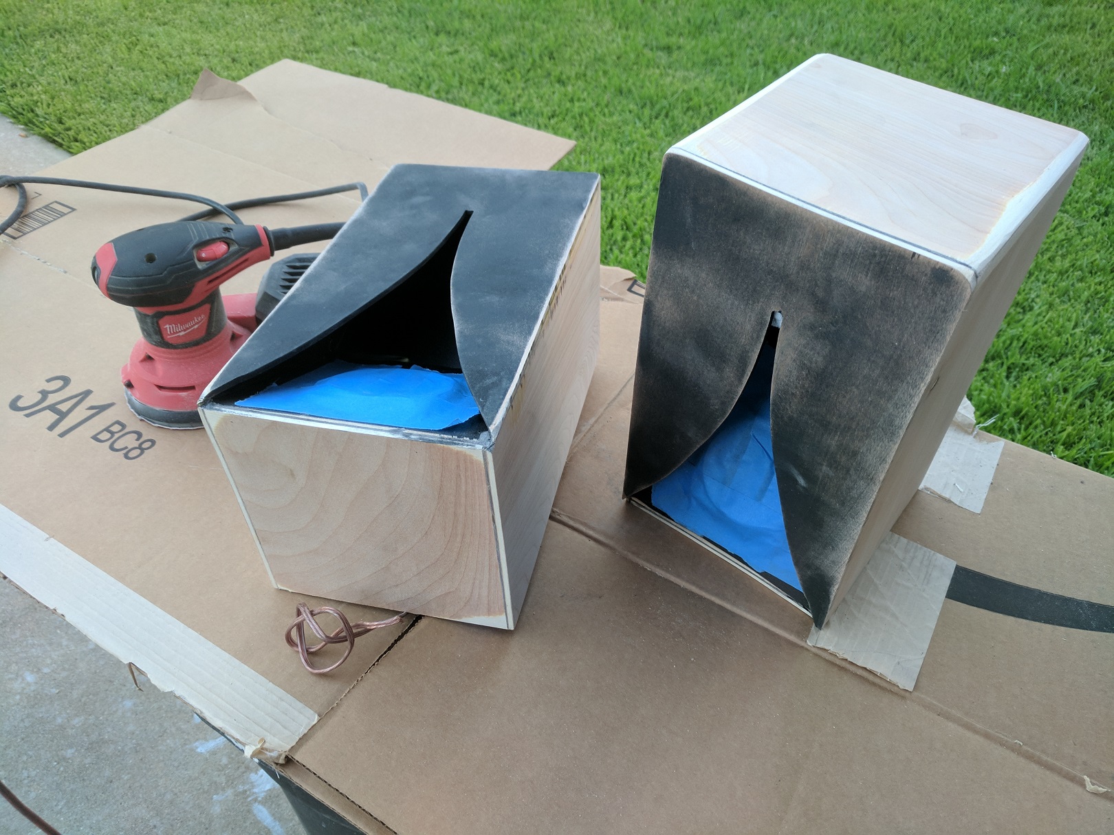

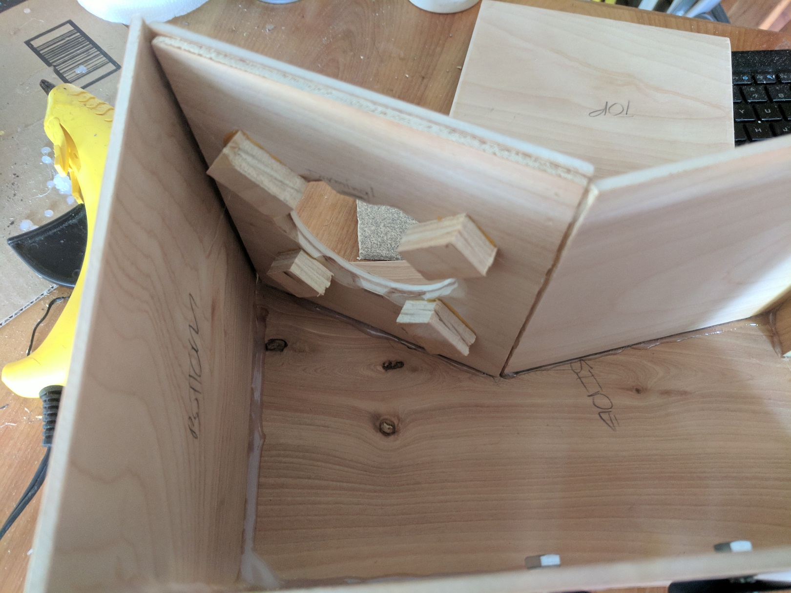

Built a pair of Mini Karlsonator for the fun of it and installed them just as you described.
It's worked well enough. No complains from the neighbors and it gets loud enough to enjoy.

The mini karlson build pix.
The last pic shows them flush to the wall but I angled them inward after the pic was taken.
