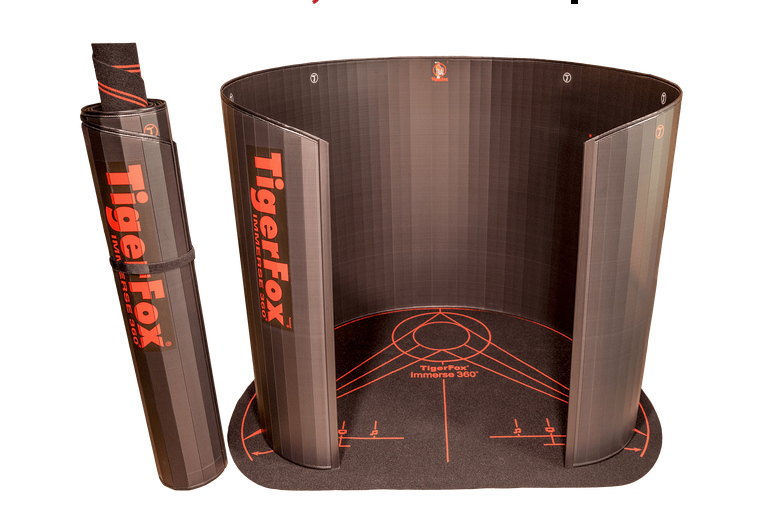

Ever stand in front of a large satalite dish. Notice how everything sounds wierd? This is ridiculous.
That looks easy for DIY experimentation. Just need a roll of some semi-rigid acoustically reflective product. Any ideas?

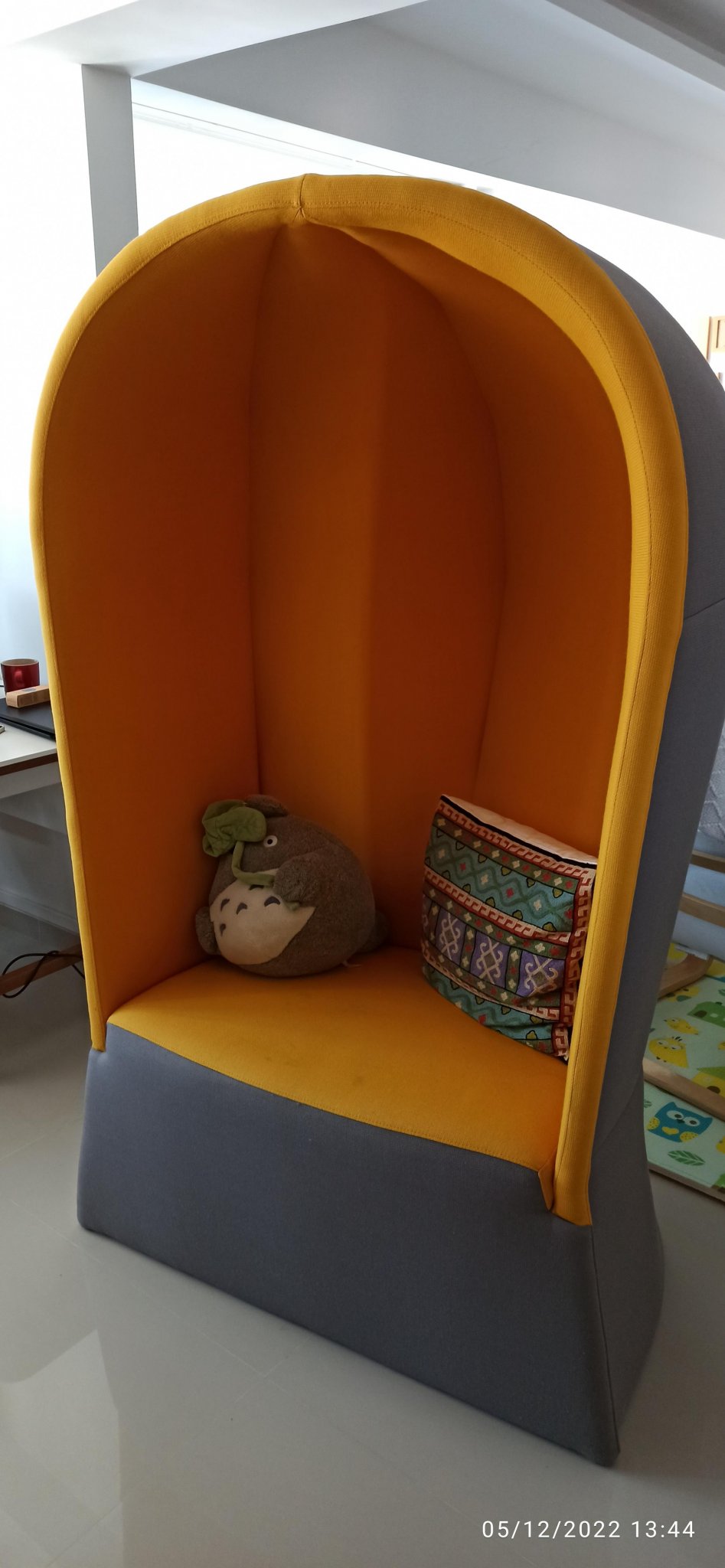

Another vote for the Sonic egg chair. Done right with something like 6.5" coaxials or equivalent and a woofer mounted free air to the bottom of the chair and you have ****s and giggles for years.

Wait a goddamn minute! Yes rule of thirds placement is often near perfect but makes the room useless for other purposes.
The TigerFox's beneficial outcome seems to be much more from nearfield rule of thirds type placement then the materials itself.
FYI i have these chairs that I never really used for hifi listening... perhaps i should measure the response versus the Ikea Poang I use...
