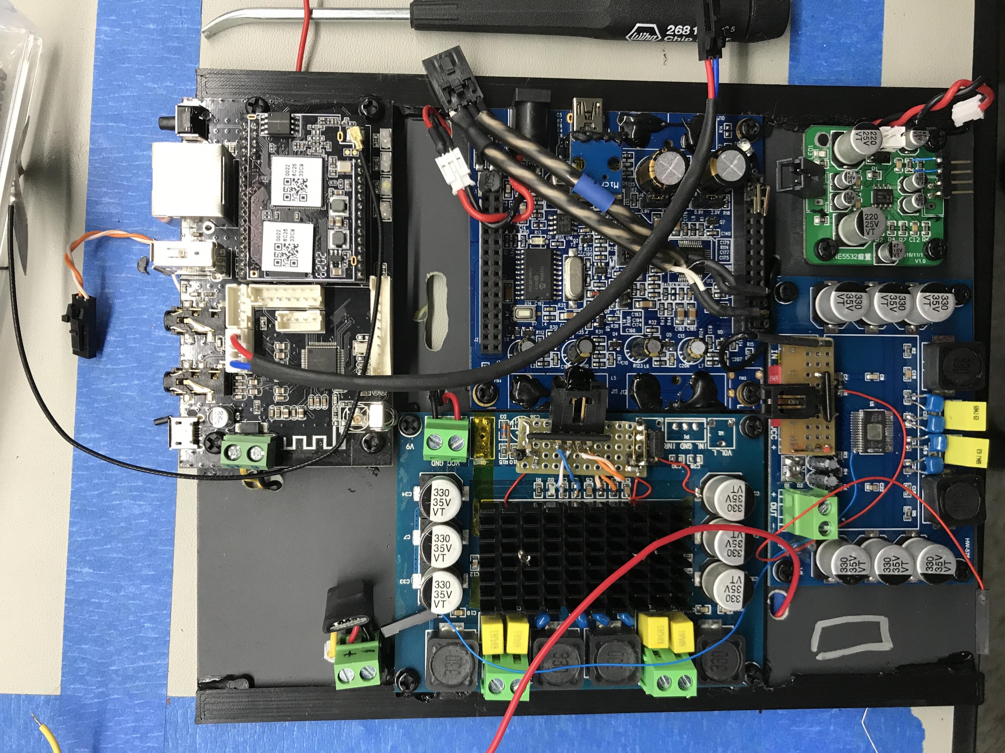

Good thing i have a spare, but it is some work to do the updates.
I feel your pain. What happened to C16 and C23? C10 & C11 are the pos and neg inputs for the left channel (PBTL input according to datasheet) - did you remove C11 and attach straight balanced negative?
A ground wire is missing from the balance input.
Not needed when all boards share the same ground.
C11 is an optical illusion. There is a cap there but it is in the axis of the camera so it just looks like a solder blob 🙂
The stupid thing about that board is that it LOOKS like C16 and C23 are for the left channel, but the left inputs are tied to ground (consistent with what the copy of the datasheet that I have says to do for PBTL.)
C16 and C23 are actually connected to the PLIMIT and GVDD pin (??? huh?), so they used a pair of huge electrolytics just to decouple GVDD. I initially changed them to the same ceramics that I used for the input caps (3.3uF, not perfect but what I had around). The board worked fine. (this was the configuration I had since the beginning)
Then when I did the update to balanced/differential (I know they're not strictly the same but not sure what this setup technically is) I changed C16 to 1uF like in the datasheet and removed C23 because it seemed redundant to me.
Gave it some power and Poof! I released the magic smoke.

Thanks for the photos, Brian.
If it works well after the many good advises you have gotten until now - fine. If not, you have followed a procedure that often leaves noise issues.
You cannot just put noise-sensitive circuits (the TPA3116 inputs among other) close together with digital circuits and assume you will have no noise-coupling.
A more systematic way would be to arrange all the boards with good distance and make sure the system works like that. Here you can get rid of wire-carried noise. After that, you mount the two TPA3116 boards in the cabinet and check-out if that still leaves no problems, Then, the next-most sensitive board and test. Following such a procedure you will notice which boards cause most trouble.
Putting all together for a start and realizing that you have unacceptable noise, leaves you no knowledge of if it is due to conduction or radiation and which boards are the most problematic. You work in the haze when trying changes around in the system.

What do you think about my idea of using a single-sided bare copper PCB as a base to mount the boards to (copper side away from the boards, naturally)?
My thought was to use the copper as a ground plane (and power ground) and drill holes for the power and non-signal wires to go below it. This way each board would have a short ground wire leading to the copper. Similar in concept to using a car's chassis as the ground in a car.
Hi Brian,
If you have connections that are clearly "power" then use the ground-plane (evidently).
If you have connections that are only signal then use separate wire connections.
If you have connections that are a mix of signal and power, then use the ground-plane and rely on its very low impedance. The last cattegory should include your DSP.
AH, interesting. good. so then the (-) signals between the source and the DSP (single-ended) go through the ground plane. That was definitely the connection that was causing the interference before actually.
The pins that connect to the (-) signal ground on those boards are indeed just tied to the ground plane anyway. That sounds like a reasonable explanation for some of the interference.
Then the signal connections to the amps (differential) would not. Perfect. This is much more logical.

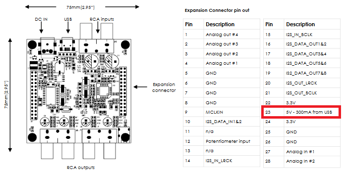

Brian, you say that the DSP board has unbalanced input and output. You mention a "-" terminal. I assume this to be signal ground. Am I right?
I do not know such a DSP board. Can you link me to an explanation about how to connect such a DSP board?
Yes, sorry, I am all over the place with my terminology (I'm a scientist, not an EE, so I don't know alot of the specific terminology. Definitely gets me into trouble with folks who know the art.
I am referring to signal ground. I can't kick the habit of always referring to signal ground as (-). Definitely a bad idea when there are differential signals in the mix!
This is the DSP board (disregard the red square, not my image). I will be using pins 27 and 28 for the input from the source (no signal grounds) and using 3-6 for the start of the differential signal chain.
I've got that pre-amp for the sub signal that I will be using single-ended from the DSP but then differential to the amp.

Just to get on the same wave-length: It is a MiniDSP 2x4 board you use as a numerical programmable cross-over with the aim to have a stereo-channel and a mono sub-channel? You have removed the RCA connectors? If correct, please progress->
The fourth board I see on your photo of your system cabinet is a micro-computer (Raspberry PI or the like) used to feed numerical music information into the MiniDSP board? Or, is the input to the MiniDSP board also an analog signal which is sampled by the MiniDSP board, filtered and brought back to analog by DACs on the MiniDSP board?

Unfortunately, the i2s signal (digital output) is not compatible with this miniDSP digital input, so you are correct that it needs to go analog first, then be redigitized. Not optimal, but that’s life.
