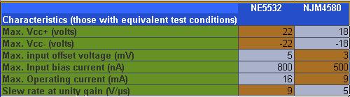

ashok said:
Is the NJM4580 the same as or as good as the NE5532 ?
NE5532 is a NPN bipolar input op amp currently made by North American company Texas Instruments (original by Signetics).
NJM4580 is a PNP bipolar input op amp currently made by JRC (New Japan Radio) (check also Texas Instruments version RC4580)
This is the comparative between the two op amps based on the data sheet of each one... (Unfortunately specs are not given with the same test conditions or test conditions are not specified).
I will receive today some NJM4580's and RC4580's to compare them, according to my musical tastes and semi-trained ear (I play cello since I was 7 years old, however I dont have "golden ear").
I became interested in JRC chips because many medium cost-medium wattage amps I've repaired have them, I know they are really cheap and there are better op amps but JRC chips feature a great cost-performance ratio.
I will post the results soon.

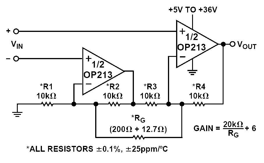

What microphones are you using or trying with this preamp?
Capacitor/condenser microphones need a special protection at the input.
Be careful with the capacitors you use at the input, as the quality may influence the audio quality. Use film types if you can.
This is a very good mic preamp I built years ago. Uses a dual low-noise IC, in this case OP213 (which I don't think is made anymore) and you set the gain, with a pot or switch, between R2 and R3.
It should work fine with just one 5532. The 5532 is much better sounding than the LM833, but you can put a socket. Then try them and see which suits you better.
In any case put a blocking and protection combo as that used on the SSM2019, Figure 4.
http://www.analog.com/UploadedFiles/Data_Sheets/SSM2019.pdf
The next stage, which is no longer balanced, should have a small cap in the feedback, which could improve noise.
But remember one thing: you will have to build a pcb for this circuit, properly bypassed and regulated. If you don't you will have noise and oscillations.
