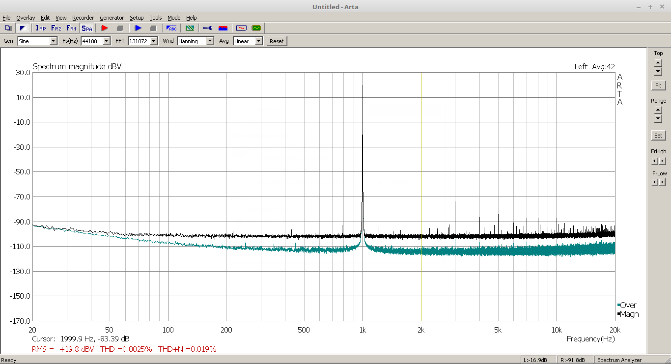

Yesterday I measured NE5532 (TI) and overlayed this with the plot of NE5532 (Original Signetics). Noise level is about 10dB higher, quite similar to TL072. I really doubt these will meet TIs specification.

Voltwide,
do you have an explanation why the black plot is showing a lot more "spikyness" than the green plot?
That is a point I wondered at as well.
No, I do not have an explanation for these spikes.
Test Setup is a breadboaded analog front end with two DIL8 sockets, powered by 24 V, symm output - which explains the high signal level. I measured the symm output through a 30dB symm attenuator feeding the symm line input of EMU-Tracker.

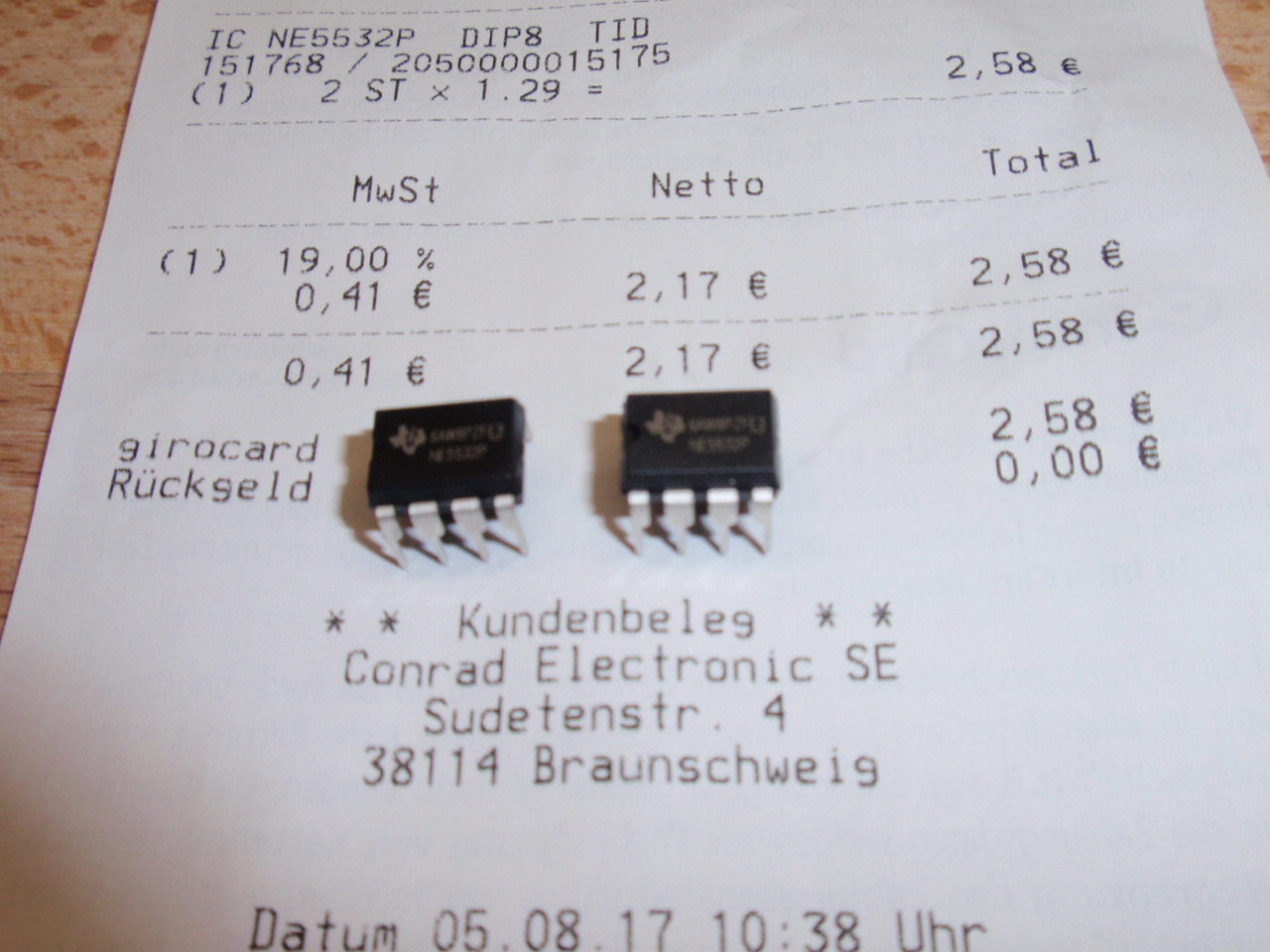

just measured the 2 samples bought from Conrad. The FFT-plot is overlayed with same measurements of Signetics, date code 9127.
It is hard to discern both plots, THD measures in both cases 0,00034%.
Conclusion: original TI-chips are not discernable from Signetics originals, and if so - they are fakes.

TI spec sheet states a max noise rating only for the 5532A's (low-noise grade) voltage noise. Current noise is given as typical value, and for 5532 (standard grade) both types of noise don't have a max spec. Therefore, I would not be surprised to find a chip within a huge pile of TI 5532's that is an outlier and might result in several dB more total noise in a given circuit than a "typical" unit -- unless the test rig masks/dominates the noise. Further, the 1/f corners might have a lot of tolerance which would make a difference at LF even for parts with the same 10kHz noise rating.
It is important to use the A-type! Chips without A are rubbish. Do not buy at Conrad! The prices are incredible! The NE5532A is available for 30 cent.
Did you read my posting? Just showed non-A-types bought from Conrad that are NOT rubbish. Prices of Conrad are certainly at the upper limit, but being ISO-certified they are at least a trusted source. Otherwise I prefer Mouser and TME.
Feel free to send me 2 samples of your 30 cent NE5532 and we will see whether they are rubbish or not.
