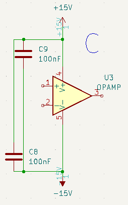

I always go for 'A' and 'B' together for an NE5532.
As Doug Self has explained in the past, both are necessary if you want to prevent (A) the possibility of the NE5532 internally "hooting", and (B) HF disturbances from the supply rails entering the supply pins. The requirement for 'A' will depend largely upon how the NE5532 is externally configured but, for the sake of a few pennies, better safe than sorry in my opinion. Keep 'A' as close to pins 4 & 8 as possible.
Note: The supply pins are 8 (+) & 4 (-), not 4 & 5 as shown in your schematics.
Under some circumstances, either may be considered overkill and may make no audible let alone measurable difference, but my gut tends to go for a 'best practice' approach and do both anyway as it can save having to troubleshoot later. They're still an astonishingly good opamp when configured appropriately, so you might as well give them the best chance you can to show you all they've got.
Box polyesters are probably a sensible choice if you want to avoid capacitors with unusually high Qs.

This looks like a misunderstanding of what "as close as possible" means. It's the whole loop distance, not just from each supply to the nearest capacitor. It's not just the wording of the datasheet that the capacitor should be "as close as possible" to the device, but ALSO that the TRACES for both connections between the capacitor and the device should be as short as possible. Schematics don't really show this properly as it's assumed every connection has zero resistance and zero inductance. A PCB layout demonstrating "as short as possible" would be much more instructive. This may or may not be critical, depending on the bandwidth of the op-amp.The third C option I've seen is to put a capacitor as close to each supply pins as possible and the other rail, like this. This makes the distance from each power supply pin to decoupling capacitor shorter than in option A.
Loop area is the critical factor, and why ground planes are so important.
The image currents in the ground plane reduce the remaining trace inductance.

avtech - The cause is apparent from the NE5532's schematic.
The 37pF capacitor couples a signal referenced to the negative rail to a base of the PNP stage. The 36pF capacitor couples the positive rail to the other PNP base. The result is that at high frequencies, the PNP stage sees the difference between the supply rails as a signal.
This is a bad design from the point of view of PSRR.

Correct, D.Self advocates for a single cap between PS pins, no ground, just like "A".
If you look at what happens when uou get current draw, and there is high frequency, then you’ll want that decoupling cap between the two power supply pins (which can be +V and gnd if that is the power) so low impedance wave then propgates to the other side of the cap..
If your opamp only has + and - then that’s the only return paths for the power noise (ie the drawn power) to loop back.
What I have always seen is in amps, the power caps are rail-to-ground, even in bipolar otherwise it creates more noise perhaps?

The belief is the NE553x issue is with very fast oscillations (perhaps microwave region) internal to the chip when the supply rails have too much inductive reactance, the effect is not easily observable other than by a small but distinct increase in distortion. Its a reasonably common situation for unwanted Colpitts and Hartley oscillators to exist at VHF/UHF in low frequency circuits, sometimes going unnoticed. I suspect it varies between devices, batches, manufacturers and with supply voltage
Having the cap ceramic and directly between the rails minimizes the series inductance so is the best approach for this condition. Decoupling at audio frequencies is another matter, related to the overall circuit.

It's a term that was widely used in the UK for at least half a century to describe self-oscillation. I hadn't realised it had fallen out of favour. Apologies if I was unclear.
Mark Tillotson and EdGr explain why and how best to avoid it with an NE5532.

I like discussions like this. Everyone has an opinion, and many of the more experienced here are right.
Doug was right, but remember that he was looking for the absolute minimum required, because the multi-channel analogue mixing desks he was working on could not afford the luxury of NE5532s over TL072s unless really needed for output drive and noise reasons. The fact that he found a pair of electrolytic caps to ground could keep stable multiple NE5532s up to certain distance, but far more TL072s, so the extra caps needed for NE5532s added to the cost. He outlined minimum best practice, mostly on through hole 1 or 2 layer PCBs. As said modern opamps, on SMT PCBs in todays RF rich environment, minimum best practice can give way to better practice when we have cheaper passives and multi-layers available.
Also the topology makes a difference. An inverting opamp stage has a direct ground reference, whereas a non-inverting or differential does not on the pins of the opamp. So the PSRR is different depending on topology, and therefore the minimum requirement varies.
Please remember, at low frequencies PSRR is very high, and different for each rail, but lowers at about 6dB/oct 20dB/decade. At some point it can go below 0dB, meaning the PSU pins actually amplify! So HF decoupling is vital.
Paralleling caps can lower ESR, but remember, the same size MLCC cap has roughly the same minimum frequency ESR. So parallel different footprints if you really want to get a spread of low ESR at HF.
X7R etc. are OK for decoupling, as while they add THD and are piezoelectric in the signal path, decoupling this is non invasive. However, they have terrible dC/dV. So choosing a cap to be used near its rated voltage means you may get less than half of the expected capacitance, AND considerably lower its lifespan.
So use plenty of decoupling: A or B depending on topology, and put regular electrolytics to ground, but make it a star PSU ground if you have a signal ground following the signal.
