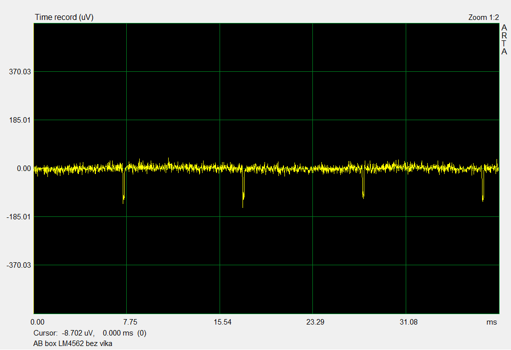

I can confirm what you are saying. I was measuring many LM4562 from different production batches in the last 10 years. First, in my special test circuit with 0dB signal gain and 80 dB noise gain. On breadboard, the 4562 was the worst in 100Hz multiples pickup, in a set of about 15 opamps. Repeated the test on double-sided PCB with shielding groundplane, the amplitude of 100Hz multiples was reduced but again the 4562 was the worst.
This year I tested it in a unity gain buffer. The problem is here again, though reduced in amplitude. You may see it in the attached measurements, both in frequency and time domain (in time domain it is in the Al box without and with top cover). The problem disappeared after placing the PCB into very well shielded Al box. It can be concluded that the LM4562 is very sensitive to air-coupled elmag. fields, regardless the datasheet perfect PSR behavior. It can be cured by perfect shielding box 🙂.

PMA's post does show classic high frequency interference in the measurement - few 10s of us glitches at PS frequency (1/2 wave rectified?, no snubber?)

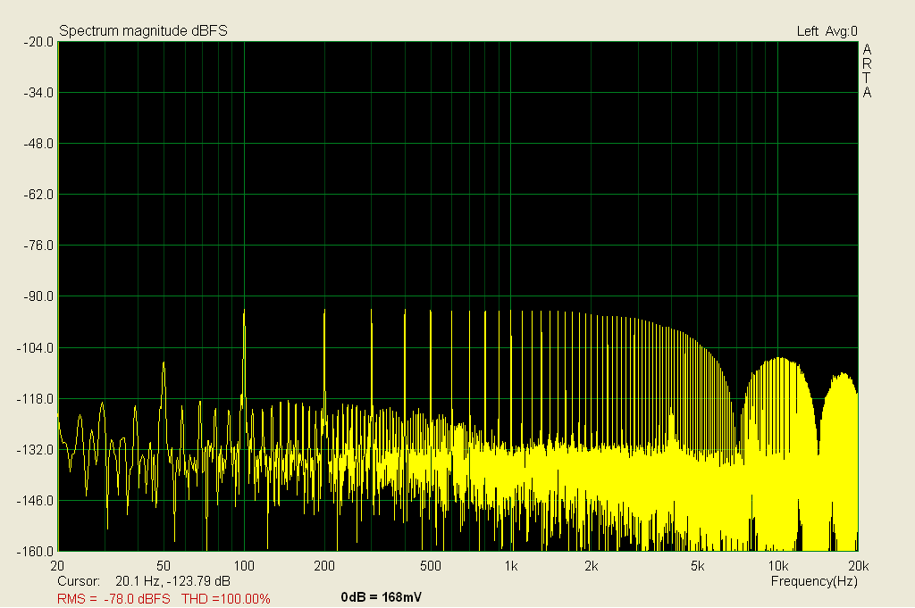

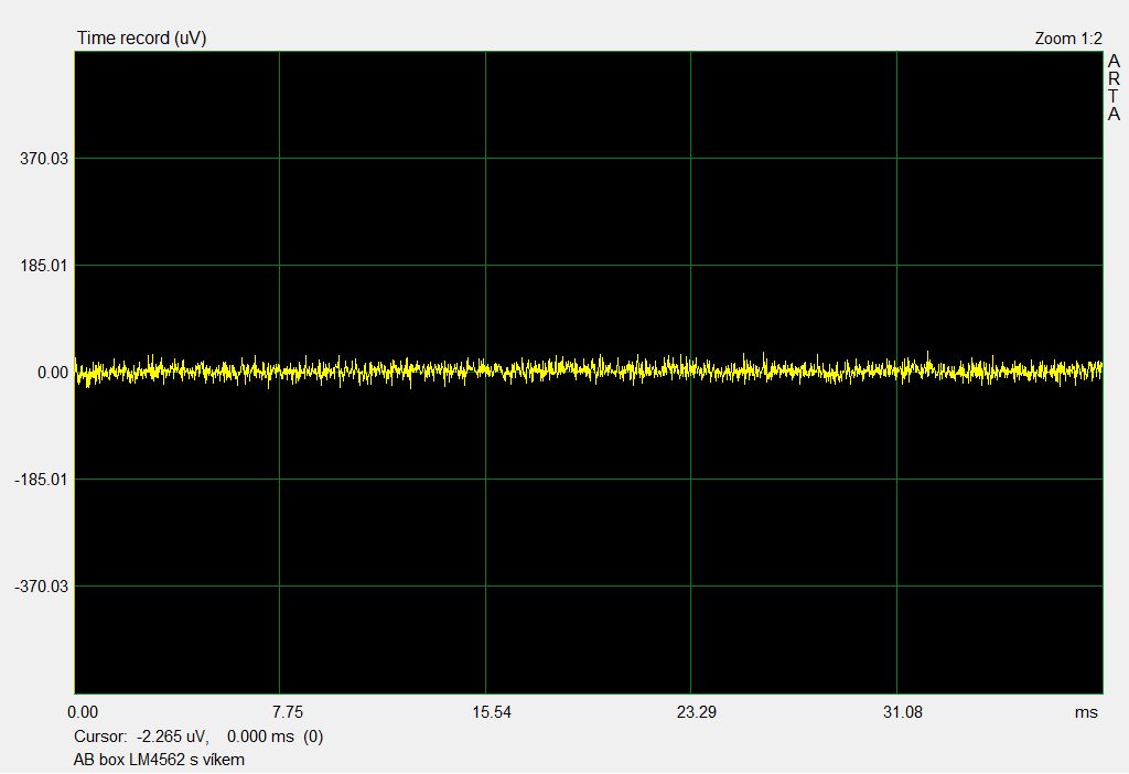

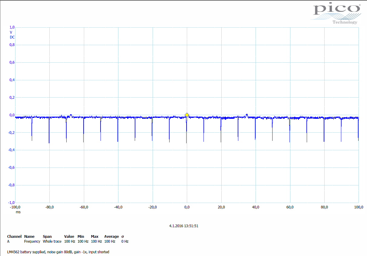

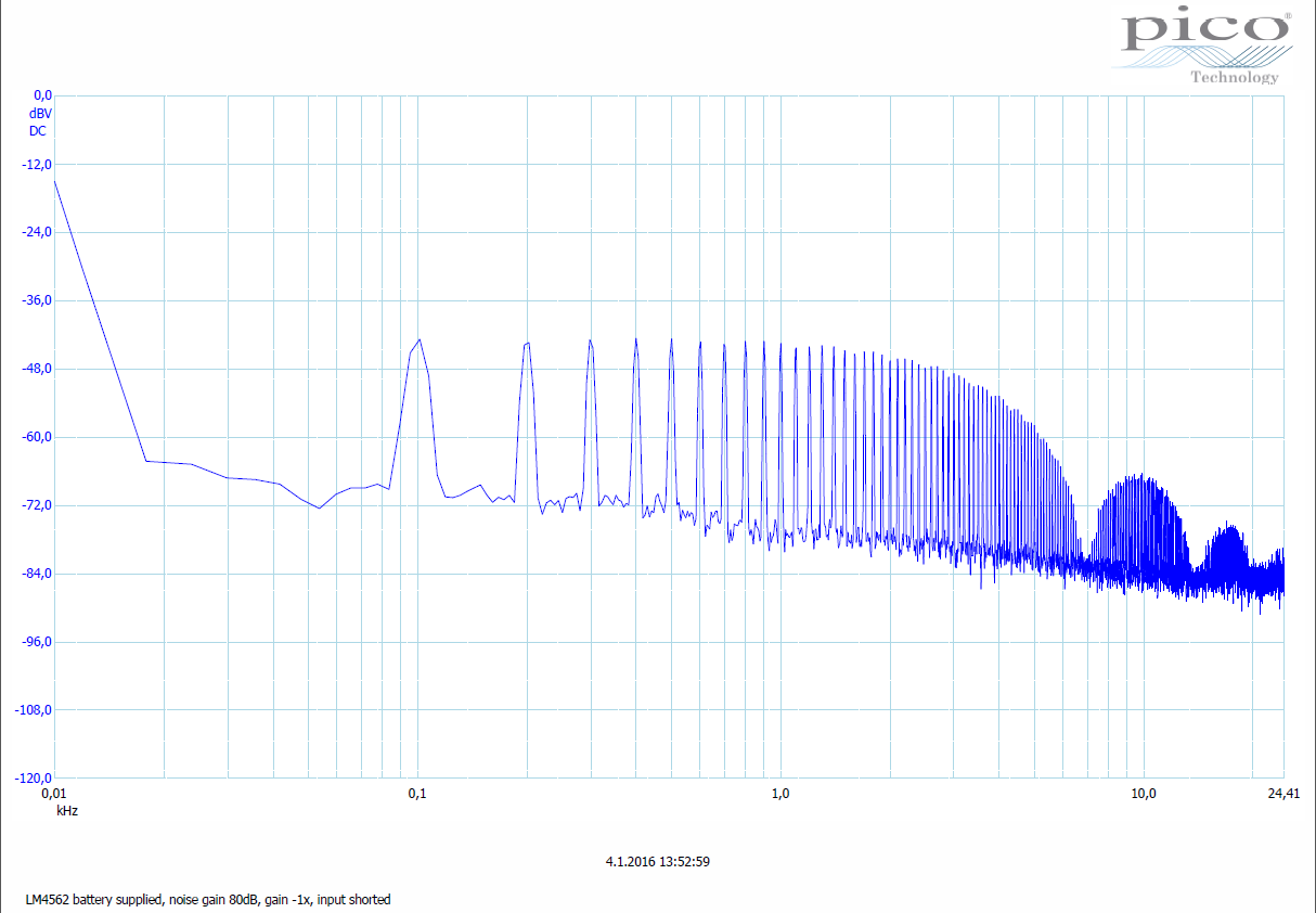

Thank you for your input. I really do not want to create too long story, though I have collected a lot of data, made measurements at two different and distant working places, used not only sound cards but also spectrum analyzers and fast digital scopes, used decent power supplies - with the same results that confirmed that the issue was not accidental.
As you are saying, most probably undegenerated BJT input EMI demodulation enlarged (probably) by very high open loop gain and BW of the part.
Supply bypassing and snubber made no difference. There is a snubber in the power supplies.
I agree that the problem is not directly poor PSRR. The PSRR is good, if well shielded box is used, however nasty spectrum with the unshielded board may mislead to conclusion that the PSRR is bad.
In a direct comparison and same circuit, JFET input opamps showed no problems, the spectrum was clean. 4562 compared to 5532, 5532 was much less sensitive to induced EMI. However, when the 4562 PCB was inserted into well shielded aluminum box, it created a perfect line stage amplifier. But the experience with air-coupled EMI shows that the DIYers may have troubles with the LM4562, in case that the PCB design is sub-optimal and the well shielded metal case is not used, which is sometimes definitely the case.
I should add that I measured the same pickup of the 100Hz multiples even if the test PCB was supplied from batteries.

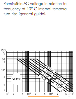

. As Cyril Bateman pointed out in his epic paper on capacitor distortion (https://linearaudio.nl/sites/linear... 12 2002 mar2003 1uF electrolytic or film.pdf) the bipolars (such as your Nichicon MUSE) are superior to polarized caps, but “the best electrolytic, the Bi-polar type, was clearly beaten by the good metallised PET”. I have found that a fairly new product from WIMA (a PET---- MKS2B051001N00JO00) is exceptional in its combination of fairly large capacitance (10uF), small size (7x11mm), low ESR/DF (~12 times lower than the MUSE), and low distortion (< 0.0002%, -114db). It is a bit on the pricey side, as they are $3.01 each, but I have found no other cap that comes close to its performance/size.
I often refer to and cite Bateman's paper on capacitor distortion. And in this work, he points out how to mitigate or "swamp" capacitor induced distortion in your design. You can calculate it, you can measure it, and most important of all you can control it. And armed with this knowledge, you can design audio circuits where the electrolytic capacitors introduce virtually negligible distortion.
I avoid using those big expensive film caps unless I have to. I explicitly design so they are unnecessary if possible. I do use fancy pants film caps in my filter and tone control circuits, where non-linearity can introduce a very significant amount of distortion. I try to limit myself to 0.1 uF max if possible - size counts and so does price.
If capacitor is used for DC blocking only then there is no AC voltage across the cap... AndrewT writes about this over and over but people still can't understand this simple fact.
Hmmmm......hard to imagine any audio usage where a cap is going to see 50 volts DC in a solid state circuit. Tube circuits, I guess.Re dotneck335 Post #32
Check out Wima's PDF of those Caps, for suitability 😉
