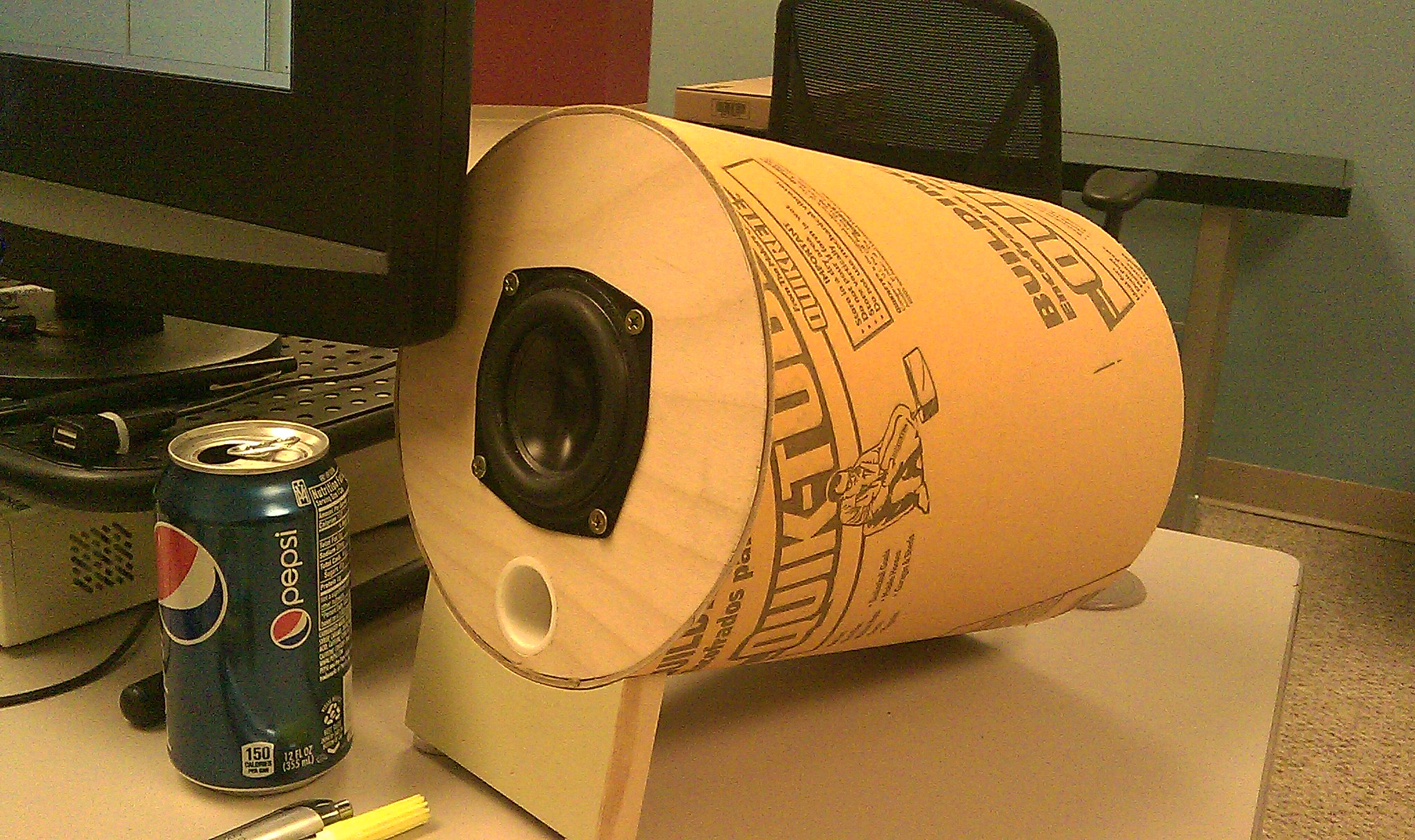

Sorry I didn't reply to this sooner.. I made one set of speakers with these and they sounded so good I made another..

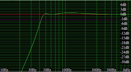

If you don't already have WinISD, get it.. It will help greatly.
WinISD will recommend a large box, I shrunk it a little to about the best low end response I could with a smaller enclosure. I ended up settling with a 6L (366 Cu.In.) enclosure tuned to 50Hz. (Port was 1" doa PVC, rounded internal edges, 3.2" long)
They surpassed my expectations, especially now that they are broken in. They are powered by a LM1876TF chip amp. The surprising part is they probably could use a separate tweeter, though I would couple them with a small one (maybe crossover ~8-10k as a guess).
I use them as computer speakers at work and the guys find it hard to believe there is no sub..

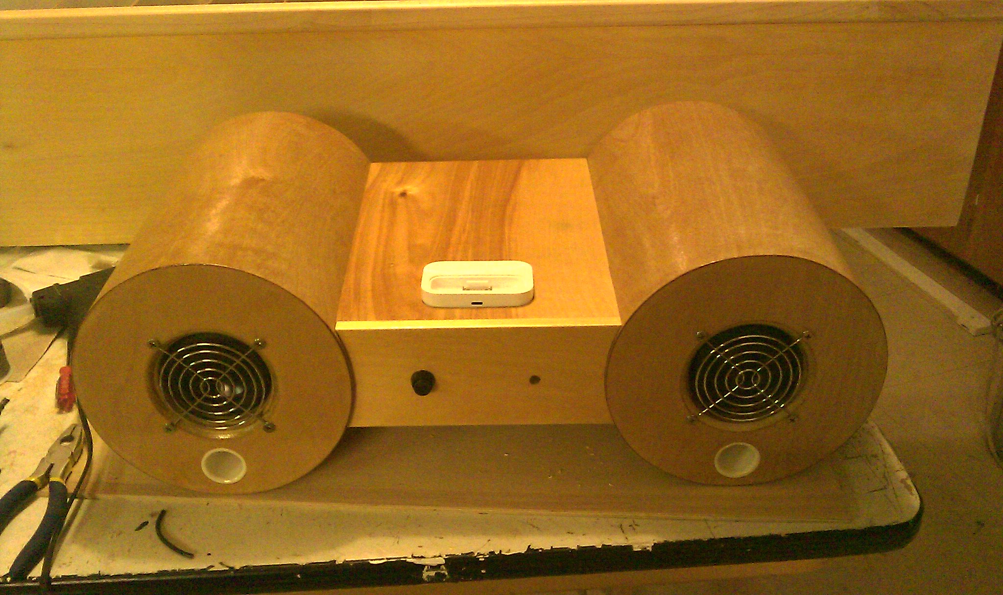

Here are pictures.. The graph from WinISD, the computer speakers I made (which are ugly but sound great) and the iPod dock I built after I knew they would sound good. Note, the dock is almost finished in that picture.

Holy MrDragon, that's exactly sort of the thing I'm looking to do, though you're look more like a dock I had bought, I'm turning an old sony speaker box into an all-in-one dock with a metal handle- sorta like a wooden boombox. But kudos to your project!
