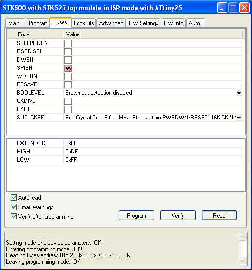

The stroboscope is based on one of the smallest microcontrollers ATtiny12L. To generate the flash frequency of the LEDs, a software-implemented NCO (Numeric Controlled Oscillator) is used, which is usually one of the components of a direct digital synthesizer (DDS). This provides a frequency step of about 0.001 Hz, which allows any quartz to obtain any output frequency within this accuracy. This is an advantage of NCO over a simple divisor.
The stroboscope has the ability to generate 4 different frequencies, which are selected using the SEL0 and SEL1 inputs. Each of these frequencies is specified in the source text as a constant and can be any. The constants for the frequency code are calculated automatically. As the initial data, you must enter the desired speed with an accuracy of 0.001 rpm and the number of platter marks. For example, 50 Hz turntables typically have 180 marks for 33 1/3 RPM and 133 marks for 45 RPM. Based on this data, frequency codes are calculated at the compilation stage. For a speed of 33 1/3 RPM and a number of marks of 180, the LED frequency will be set to 100 Hz. And for a speed of 45 RPM and a number of marks of 133, the frequency will be set to 99.750 Hz, which will give a speed of exactly 45.000 RPM. The speed of 78 RPM can be checked on any set of marks, 180 will be set to 234 Hz, and 133 marks to 172.9 Hz.

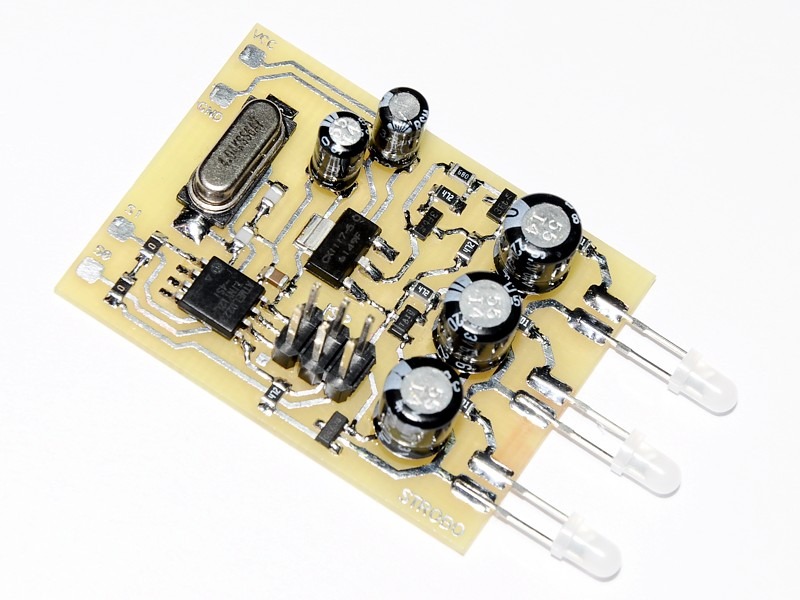

In order for the marks to be sharp, the duration of the flashes must be short. The duty cycle of the LED flashes should be 4 ... 16, shorter flashes give a clearer picture of the stroboscopic marks. In the final version of the firmware, the duty cycle is set to 16.
There is another problem - the stroboscope can become a source of interference. A pulsed current flows through the stroboscope LEDs, and if the stroboscope power wires are long and close to the signal wires, interference may occur. Another possible cause of noise is that the LED supply current can create a pulsed voltage drop on the ground wire. For this reason, some turntables have the ability to turn off the strobe. To eliminate the problem of interference, it is desirable to localize the pulsed currents within the stroboscope board, and make the current consumption of the board as a whole constant. To obtain a constant current consumption, a current source is used, implemented on transistors VT1 and VT2. This current source charges the capacitors C6, C7, C8, from which the LEDs VD1 ... VD3 are powered. If the voltage on the capacitors exceeds a certain threshold (about 4 V), the parallel regulator U3 (TL431) turns on, ensuring a constant consumption even without working LEDs. The simulation graph shows that with a total LED pulse current of about 60 mA, the total consumption is about 16 mA, and it is constant.

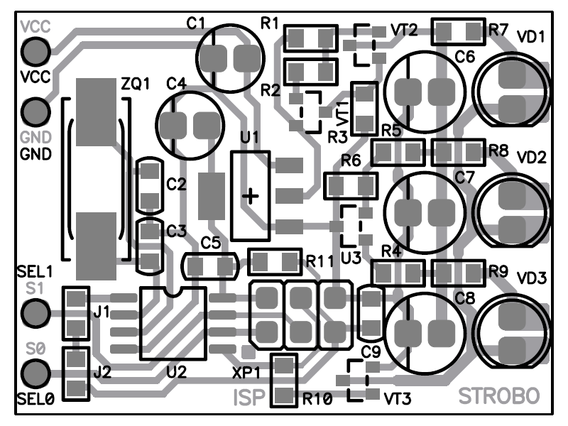

The stroboscope board can be powered by an external voltage of 5 V. For versatility, a U1 stabilizer is installed on the board. As a result, any voltage within the range of 7 ... 20 V can be used for power supply. If there is a voltage of 5 V, the U1 stabilizer can be excluded.
The stroboscope printed circuit board is single-sided, 30 mm x 40 mm in size. In order not to drill any holes at all, all parts are soldered in the manner of SMD. Electrolytic capacitors are soldered with shortened and slightly bent leads to the pads. The programming pins are soldered as follows: first, the plastic moves up, the pins are soldered to the pads, then the plastic moves down again.

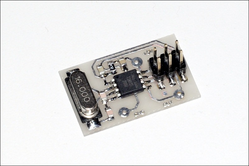

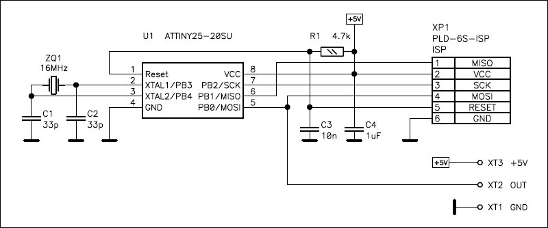

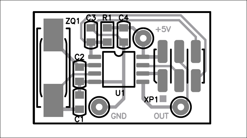

The problem with DDS for this application (square wave w/variable duty cycle), the number of samples per 360° is not an integer value which can create jitter in the output waveform. For sinewave applications, this doesn't matter as the reconstruction filter will smooth out any anomalies.
I'm assuming you are using a 24bit NCO and a ~16.7 kHz master clock to give you 0.001 Hz resolution? That means at 234Hz, you will have ~70.94 samples/waveform which could produce a lot of jitter on the output waveform edges.
You may get more accurate results by varying the duty cycle slightly and using a fixed timer rate (using 4 MHz xtal, 250 nS instr cycle) :
For 100Hz: Duty Cycle=16:1, total ÷N=2500, actual freq=100.000Hz, RPM error=0 (33.333)
For 135Hz: Duty Cycle=17:1, total ÷N=1743, actual freq=134.9938Hz, RPM error=+0.002 (45.002)
For 234Hz: Duty Cycle=14:1, total ÷N=1221, actual freq=234.0002Hz, RPM error=-0.0001 (77.9999)
This essentially eliminates jitter and the frequency errors are negligible. It's also easier to code in assembly.
I like idea of the constant current source, very neat.
EDIT: I see from your .asm code, you are using a MCLK of 15.625kHz so you will only have 156.25/115.74/66.77 samples/waveform at 100/135/234 Hz (the further away from an integer value, the greater the jitter).
Yes, jitter will be present. But it does not exceed 1 sample rate period. My NCO is running at a clock frequency of 4 MHz / 256 = 15.625 kHz. The period is 64 µs. The jitter will also have this value. In 64 µs, a turntable platter at 33 1/3 RPM will rotate 0.0128 degrees. I do not think that this will give any visible blur marks. And in practice it is not observed.The problem with DDS for this application (square wave w/variable duty cycle), the number of samples per 360° is not an integer value which can create jitter in the output waveform.
It doesn't matter how many samples per period for a given frequency. Jitter will always be equal to one sample period.That means at 234Hz, you will have ~70.94 samples/waveform which could produce a lot of jitter on the output waveform edges.
If we want to reduce jitter, then there are reserves. The interrupt handler takes only 20 cycles, while its call period is 256 cycles. You can also increase the clock frequency of the microcontroller. I have another project - an NCO-based clock generator for capstan PLL systems of reel-to-reel tape recorders. There, the jitter is only 2 µs, which is less than the typical jitter of speed sensors.
