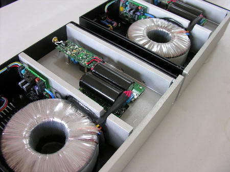

Desmo said:I just finished my NCD monoblocks and have started breaking them in 🙂
Uuups, it seems that I have problems uploading pictures and hyperlinks from MAC and the Firefox browser. Anyone that know how it works?
Anyway, here are some links to the pictures of my new amps 😀

wtfaidh said:Hi Lars,
Thaks for this reply. The NCD is running on Mission 770 speakers for the last couple of weeks....
Not only the resistor is red-hot but the coil as well.
If this is normal behavior, o.k. but than I have to apply forced cooling by means of a small fan wich would be a pitty because of the additional noise and another trafo as well...
Cheerio, Eric.
Eric,
If you add some extra aluminium to your cabinet you will NOT need forced cooling.
Check my mono blocks in my previous post. As you can see I have a lot of aluminium there. The internal construction is 12mm aluminium panels bolted together and I used ''cooling paste'' between the aluminium panels. I have also used ''cooling paste'' between the internal 12mm panels and the side panel of the cabinet that is a small heat sink. This works really well to dissapate the heat 🙂
Of course the coil still gets hot, but it's no problem when the cabinet is designed to move the heat away!
I bought the cabinets here www.audiokit.it very nice to deal with, so highly recommended.
Morten

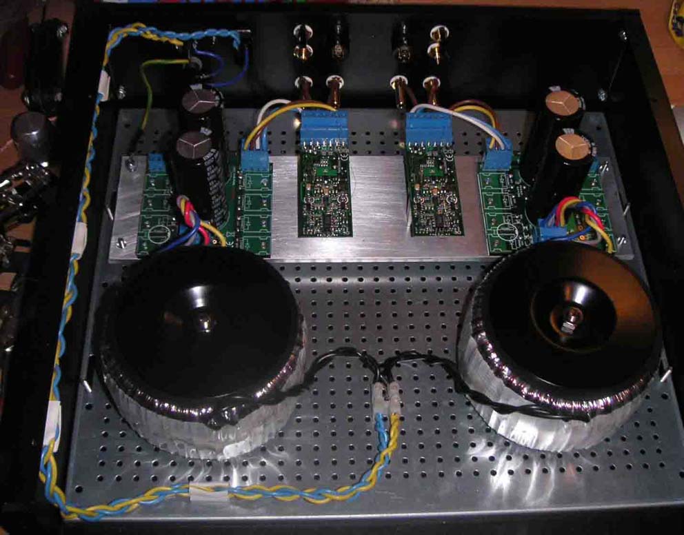

Finally got both the equipment, all the stuff AND the time to put my NCD dual mono amp together.
Mounted everything on my aluminum mounting board, connected the wires all over the place, checked, double checked and double checked again. Everything was fine and done right.
So lets connect the cd-player and the Accuphase preamp and feel the wonderful sound from my Thiel floorstands. But NO LIFE!!!! , just some weak terrible sound as from a mobile phone.
Check again and again and again. Check for missing power, missplaced connections, cold solderings to input or output terminals. No, no and no again. Nothing wrong.
Mail Dexa, mail to NewclassD, phone to Dexa - No replies yet. More checking - ground leaks this time, and WWHHAATT ! ! ! ! ! !
The "aluminum" mounting plate is leading current - has no resistans at all. So everything mounted to it, including the metal chassi was all connected to each other. The "aluminum" was not pure and must be mixed with something else to make it leading current.
So lets start this project again - - - - - Isn-t that a cute story or what????????
THe picture was BEFORE the reality striked my project

Quote:"The "aluminum" mounting plate is leading current - has no resistans at all. So everything mounted to it, including the metal chassi was all connected to each other. The "aluminum" was not pure and must be mixed with something else to make it leading current".
Sorry, but i don´t understand what eventually was the fault?! Is the mounting plate made of aluminum and in case it is it should lead current. But I guess that it is made of some material (unknown to me) that you thought was an isolation material, right?
BTW; resistance, chassis. 😉

I don't understand it either..!!! Of course a plate made of aluminium will lead current..!!??
But looking at the picture I might get a clue about what you mean, and what's wrong.
I can't see the insulation material between the power supply diodes, and the aluminium plate. Have you mounted the insulation material supplied with the kit? If not, you have the answer to your problem...
Morten
Morten
You´re abslolutely right both of you, aluminum lead current. But I had got in my mind it didn´t - as well as it is non magnetic. Maybe from the reasoning about aluminum case in favour to metal cases. Totally wrong of me.
Anyway, the insulation material was/is there, but all the stuff are mounted on the plate which will be a grundplate together with the whole chassi which I don´t know if that is too good?
The problem with amp was not the grounding anyway. Measured everything. The incoming signal path from connector to amp had resistans 0 so there should be good contact - but something was wrong anyway. Almost no signal was coming into the amps.
Switched to two 75Ohm cables per channel instead and there where sound, lots of sound! Not the very best though as the system also included a cheap MP3player and a €60 DVD from my son playing on some Boston A40 which hasn´t been playing for 15 years.
When I realized the wherer sound I switched the internal cables from 75 Ohm types to four twined wires from a CAT5 cable.
Did just connect the NCD to my Accuphase preamp, Lars C modded Pioneer CD and Thiel speakers, all connected with fourtwinned wires with some nice Furutech connectors.
Now we are talking. For he first time in 28 years it seems that my Accu power amp will not be connected in again.
Nice and open sound and and a great and crisp perspective, wow! ! !
