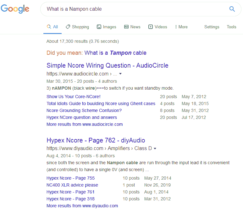

I am currently building a nc400 amp but am somewhat confused with the XLR Wiring and the nampon cable could someone please check the pic and see if i have it right before proceed to solder the cables please.

What is a Nampon cable ?
How do You want to power the amp ? Pre-amp sends ground thru pin 1 ? Isn't the pre-amp signal ground already connected to chassis or PSU ground inside it ?
Ok from what I understand nampon switches the amp on when connected to ground.
If You intend to switch the amp ON when You connect a XLR cable, the wiring is correct if You connect the XLR pin 1 and chassis ground inside the plug, but it doesn't make sense.

i thought about adding a switch but decided against it in the end after reading through alot of threads on this and other forums i went ahead and wired blue to pin 2, white to pin 3 1 to ground, nampon to ground. ideally i would have liked to have been able to add a 12v trigger so it powers on when my home theater Receiver powers on.
Just drill a hole and fit another type of small connector for triggering or use a special 4 plug XLR with a special cable but it will only work on Your system, unless You make also a special 4 pin to 3 pin XLR adapter.
