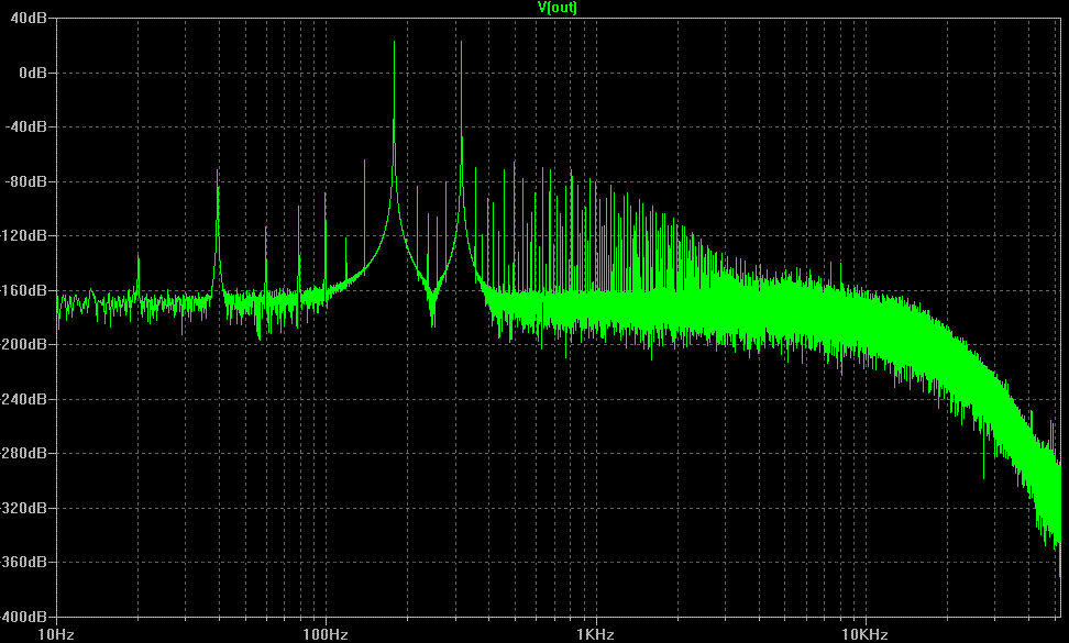

Then there is the DIM-XX. This is a square wave with a smaller
hi frequency sine wave riding on top of it. The square wave is
bandwidth limited. This test is designed to cause the sine wave
to misbehave (produce distortion). As the square wave goes
from low to hi or hi to low, these sudden transitions will cause
slewing problems that appear as harmonic products of the sine
wave.
What I've found in simulations of DIM-XX is that the sine wave
does produce harmonics, but they are like small needles in a
vast forest of square wave IM products. This test just measures
the tiny little distortion products of the sine wave and ignores the
rest. I do believe it does what it was designed to do. Show the
effects of slew rate induced distortion, but there is (at least in my
opinion) a very small amount of distortion caused by this type of
phenomena.

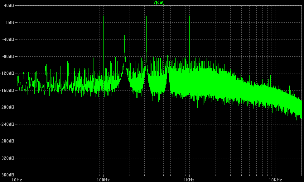

I think the CCIF measurement is good because it uses a pair of
closely spaced signals with ample room below them to produce
IM products. The only difference between this and Czerwinsky
is that the later uses more tones and uses a logarithmic spacing
of the tones so they are not harmonically related. BTW, Cordell
did not use the CCIF IM measurement technique in his article.
So I've attached a picture of a Czerwinsky simulation result
using 5 equal level tones spaced logarithmically apart in
frequencies of 100, 177.8279, 316.2278, 562.3413, 1000Hz.
You can see the fourier transform looks like a lot of grass from
all the IM products. The spacing is chosen so the products don't
overlap each other like the IM products from a square wave
do.
So I hope this at least opens the door to considering that
there is more going on then a 20Khz THD measurement. I'd
highly recommend looking at the 5 tone measurement. Who
knows, maybe your amplifier designs will work. You will never
know unless you look
Mike
