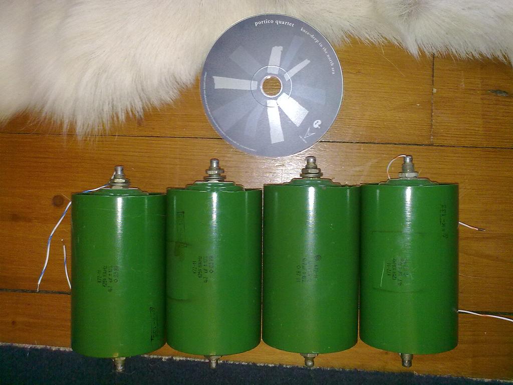

Can anyone say why Teflon caps are sooooo very expensive compared to, say, PIO caps? I do realize that the demand is smaller but that will never change unless the price comes down. I also realize that teflon is more difficult to use, but surely not to the extent that justifies the price differential?😕
I find this hilarous as teflon capacitors are the best in every mesurable aspect and are also very expensive and pointless for audio frequancy stuff where an exact capacitance value isn't needed.
Anything labeled audiophile is for sure over-priced.😎
Russian Teflons are relatively cheap, but unfortunately not available in large values.
Likely the reject rate is greater than 75%.
Do take note that a 4.7 mfd cap is bigger than a CD. There is a ton of teflon in that green can and considering how poor the mechanical integrity is the % of junk produced probably goes up exponentially with size.

Teflon is fundamentally an expensive material, MUCH more so than most other dielectrics. For example, polypropylene raw resin is roughly 75 cents per pound, electronic grade PTFE is about $10 per pound. It's also much pricier to extrude, needing very high temperatures and extruders/dies made out of special materials. It's soft and irreversibly stretchable, so it's much more difficult and time-consuming to get a tight winding.
The high price is justified by the expense of production. Whether or not it's relevant to audio use (as opposed to timing circuits) is arguable.
