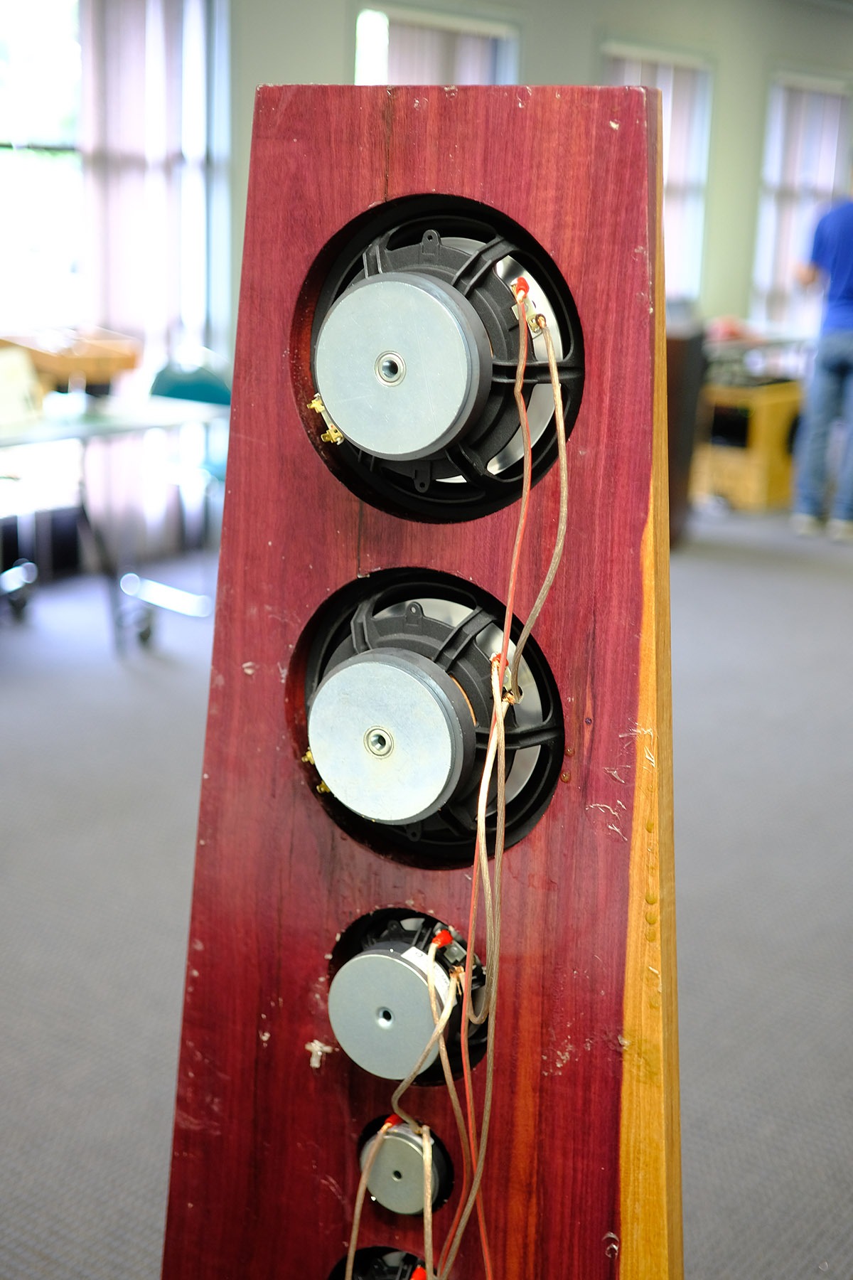

- Seven driver passive open baffle design.
- Symmetric WWMTMWW driver arrangement.
- Pair made from a single slab of solid purpleheart wood.
- Point-to-point wired external crossover containing just inductors and resistors - no capacitors.
- Four EAD E170 MKII aluminum cone woofers with selectable 70/57 Hz (nominal) first-order low-pass filter.*
- * Additional bass wiring options available for tailoring bass response to room and listener preference.
- Two EAD E100HD MKII aluminum cone wideband midrange with 375hz first-order high-pass and 5000 hz (nominal) first-order low-pass filters.
- One EAD E60HD MKII aluminum cone wideband midtweet with 5000hz (nominal) first-order high-pass filter.
- Low-efficiency wide bandwidth dipole design. Impressive FR down to 30hz on narrow baffle achieved with massive 19db attenuation of mid and tweeter.
- Finished with Osmo UV Protection Oil to accentuate the wood’s natural beauty while protecting from fading.
- Dimensions: 20.5” W x 17” D x 61” H - including legs excluding crossover. Baffle width tapers from 20.5” at base to 10” at top.
- 4ohm (nominal) load
- Weight: 70 lbs (each).

- No capacitors. I use “LR” low-pass and “RL” high-pass filters. Since I need to attenuate the mid and tweeter anyway, the series resistor serves double-duty. I find that “RL” high-pass filters are slightly more transparent-sounding than “CR” high-pass filters.
- Large inductance on bass drivers. You can select between 9.1mh or 11.1mh of inductance on the bass drivers (or a mix, as shown below). This corresponds to a (nominal) low-pass filter with a cutoff of 70hz or 57hz. However, the mid has a high-pass filter at 375hz. So what's going on? The -6db slope of the low-pass filter cancels the +6db slope due to dipole rolloff, resulting in flat (albeit very quiet) bass performance.
- Low-efficiency. I use massive 19db attenuation of the mid & tweeter to match the quiet dipole bass output. This provides a full-range sound down to 30hz despite the narrow baffle. While this insane amount of attenuation may sound like a challenge, one just needs to throw watts at the problem.
- Dual mids in series. I run the two mids in series with 375hz-5khz band pass. This in theory has drawbacks such as interference (due to dual-point-sources at high frequencies) but I find it sounds good and don’t notice the drawbacks when listening.
- DVC - The E170 is a dual-voice-coil driver with two 16ohm voice coils. When wiring the E170, I leave one voice coil open. I wire the other voice coils in parallel for a total 4ohm load. This gives a QTS of 0.78 which is perfect for open baffle.

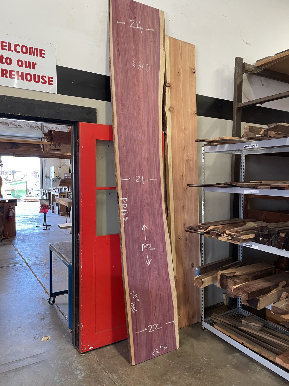

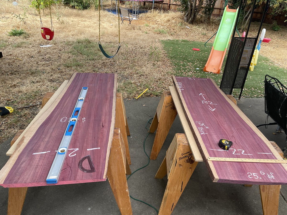

I picked up a massive solid slab of Purpleheart wood at Global Wood Source in Campbell, CA.

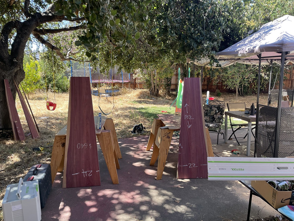

I had them crosscut it near the middle so that it would fit in my car.

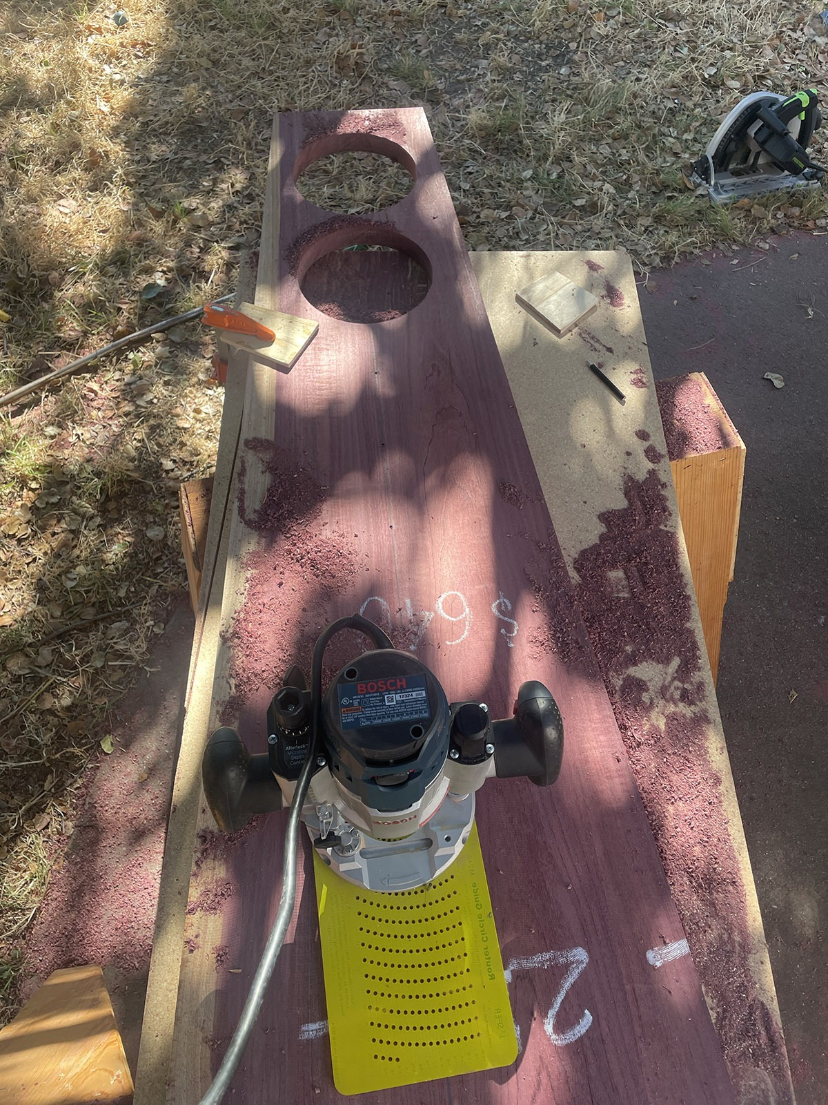

I then used my Festool track saw to cut the trapezoid shape, trying to preserve as much sapwood along the edge as possible. I was able to get a 10"-20.5" x 61" trapezoid out of each side. I aimed for a 85 degree inside angle, but was using a small cheap protractor and ended up making the trapezoids slightly asymmetric. I wrote this off as a "feature" because it may minimize edge effects.

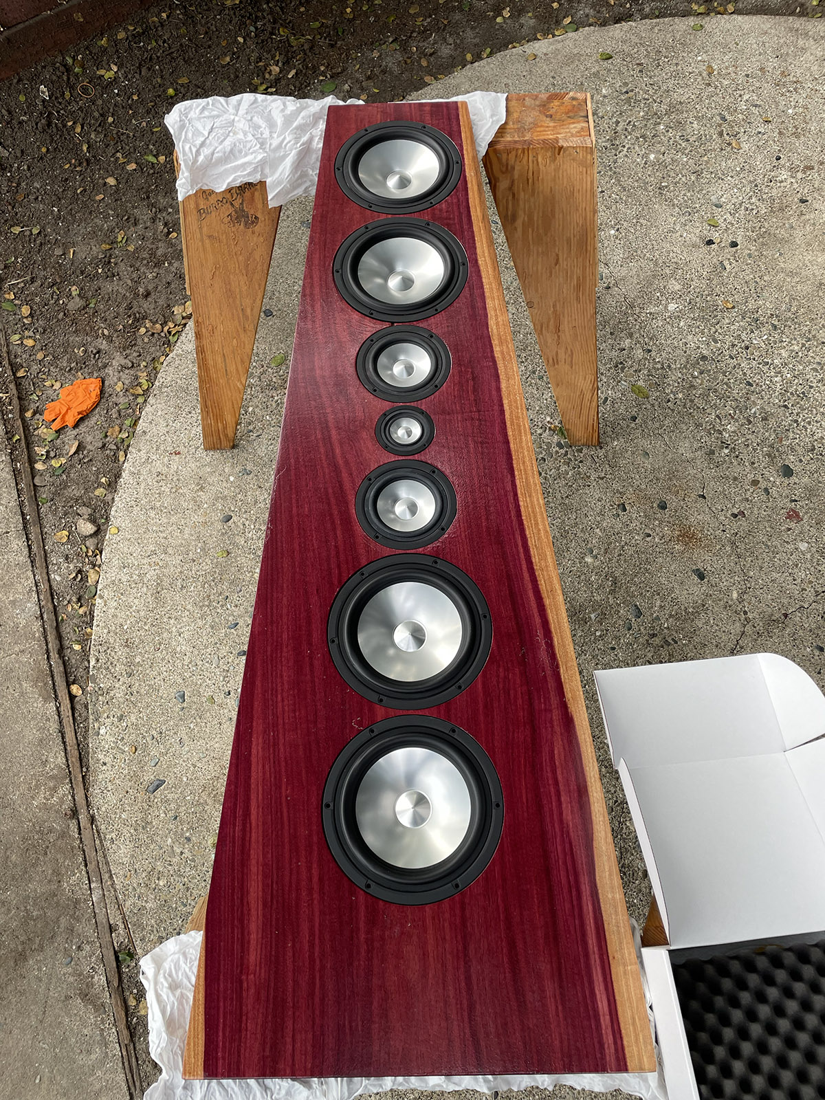

I made the cutouts for the drivers. Boy was this wood dense and required a lot of passes.
I then used a rabbit bit to make the recesses for flush-mounting. I then sanded all sides with 60/80/120/180/220 grit. Finally, I applied two coats of OSMO UV Protection Oil (24 hours between coats). After the second coat I installed the drivers and legs.
(Test fitting the drivers)
Unfortunately, I must have applied too much finish because as it dried it started to blister in some places. I plan to scrape or sand the finish off and refinish these at some point.
