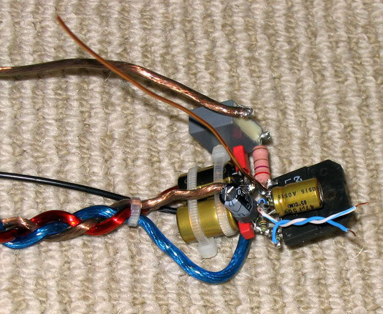

That was understood. The point was to draw your attention to the problems using parts optimised for PCBs in the style of hand (or "hard") wiring. In an ideal world, we could still buy old style components that were big and intended to be hand wired. Today's tiny parts just seem odd; lying belly-up with their legs in the air, so to speak.....I actually intend to use no bread board at all. Just a block of wood with chiseled & pre-drilled holes.
Mount the components upside down & secured with glue & hard wired with spare silver wire from the top.....

Good thing someone actually told me as I intend to use with Fountek FE85 (X-Max 1.5 mm) in a 4 speaker line array. So my initial idea of buying at least 6-10 chips to find 2 that match was a good one. Thanks to you I now have a clue as to why. On that note what are the most important matching criteria for the chips aside from the one already mentioned.
I intend to mount each amp on the back of the speaker box to minimize cable length to internal wiring & maximize damping factor.
