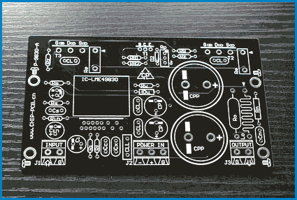

Alright, just ordered two complete LME49830TB/MOSFET kits (2x amplifier, 2x power supply, 2x volume control) from CP Design www.chip-pcb.cn so I should be getting them in shortly (picked EMS shipping).
As I'm one of the designers of the ExtremA amplifier (ExtremA, a reference class-A DIY amplifier. - Introduction) and design amplifiers and similar equipment on a regular basis I'm going to put the LME49830TB/MOSFET design through its paces and certainly look at the performance and whether the design lives up to the claims made in the datasheet.
Sander Sassen

Do you have a schematic for this LME49830 with LATERAL MOSFET 2SK1058 / 2SJ162 ?
I'm thinking of building one with LME49810 or LME49811. I have one denon amplifier transformer, don't know exact voltage but those large caps says 63v so below that. I have few output transistor also, D2390/B1560 and C4468/A1695.
I have done schematic by using typical application in datasheets. So that denon apmlifier can do 80w/8ohm, so i can probably do that too?
Schematic->https://www.dropbox.com/s/r5y8lce9bmdvrxk/Amp.PNG
That uses LME49810. So any advice about adding or removing components from that schematic?
