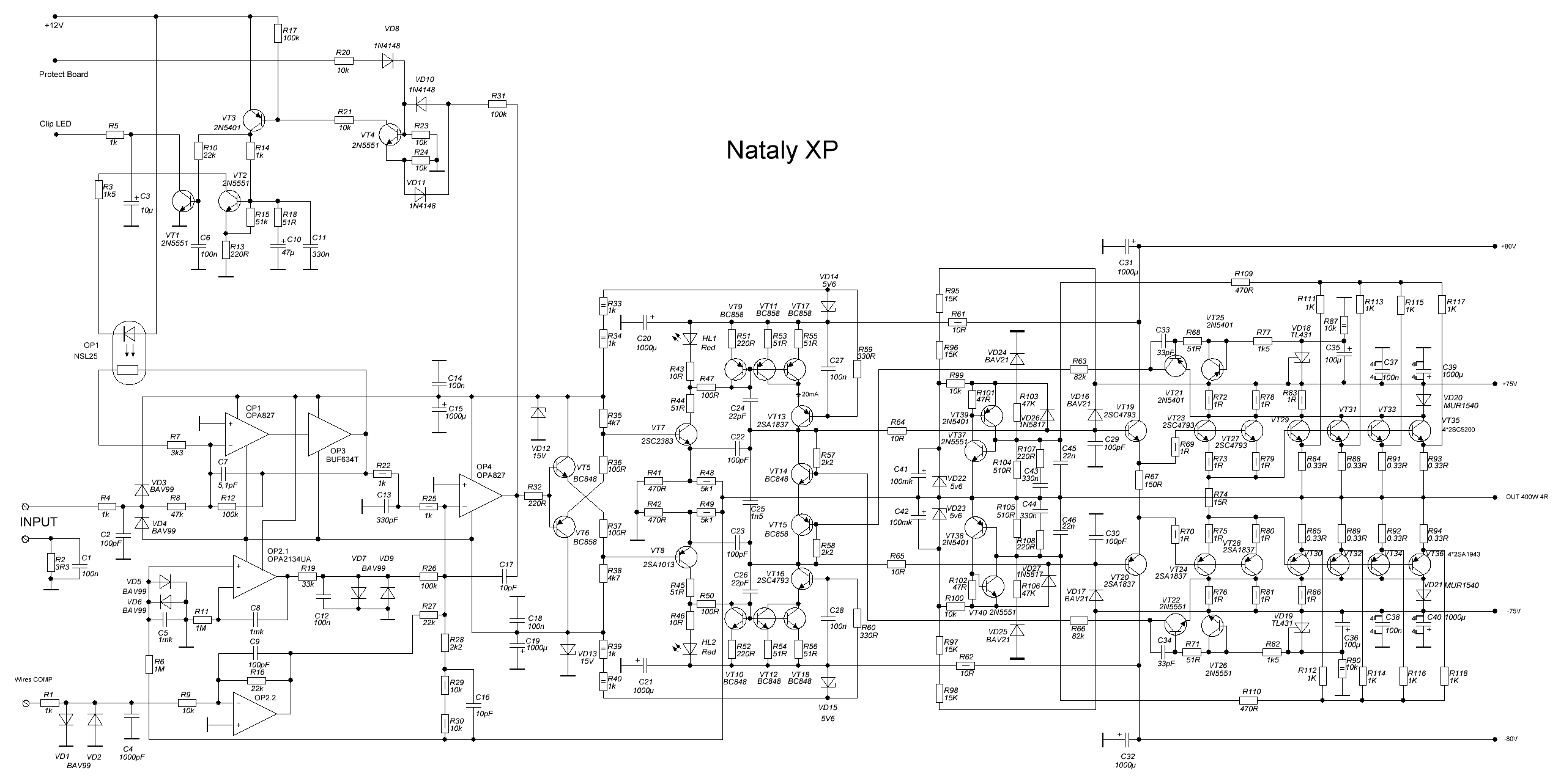

SuperA mode - is a non-switching mode for output and drivers stage (JVC patent). For BIAS current is the same as AB mode, but dynamically adds current for prevention of close non-active transistors.
Full deletion of C34,C36 or decrease them to 5,1...10pF
it was about C45, C46 and C32,C33.
no same, it is OpAmp local forward correction.
Why that would be called SuperA mode? That name some use in commercial advertising, but it is not technically correct.
When you say correction do you mean compensation?
It would be very nice if you explain this amp stage by stage, does it use error correction or something similar?
