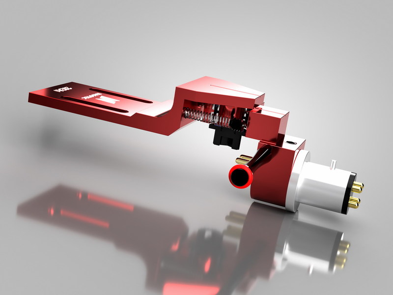

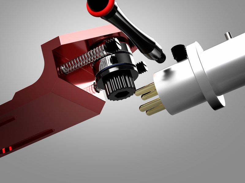

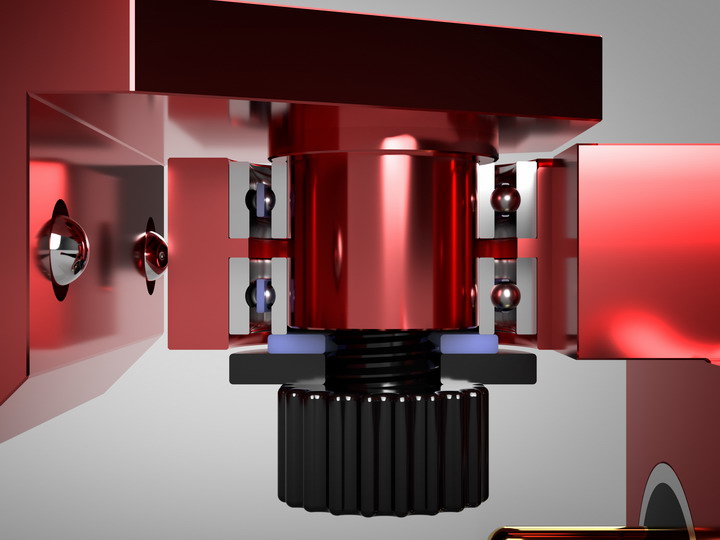

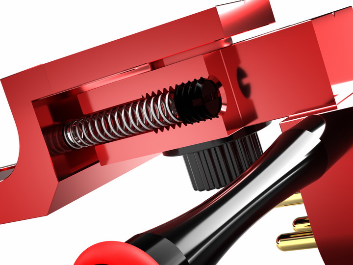

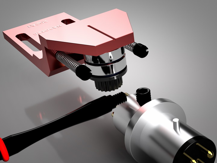

Went to the website:
Innovative and Creative Nasotec Swing Headshell
Upon revisiting this and looking at the website, I believe what I read was mostly sales hype BaloneySausage. But, there are some good photos that show how it works, and it's kind of interesting. There are two adjustable springs, one on each side of the bearing. The instructions tell you to adjust the tension on the springs such that under normal operation it remains in-line, same as a standard headshell, which makes sense. Their main claim appears to be for resonance control. Adjusting the tension of the springs will alter the resonance frequency of the spring joint and headshell/cart mass. I'm skeptical but if it's engineered right, there may be enough adjustment range in the springs to get the whole thing to function as an anti-resonator? Being able to see the patent claims would answer whether that's what they're trying to do. It looks like setting it up could involve endless fiddling as the manual says "The spring tension can be adjusted to suit individual tastes", which isn't very definitive when you're trying to tune out a resonance.
Biggest gotcha with this device is that the action (or anti-action) is horizontal and most LF garbage in vinyl is vertical. Also, if this thing flexes at the joint under resonance conditions it could cause more horizontal mode FM/scrubbing than from just the stylus flexing with a standard headshell arrangement.
