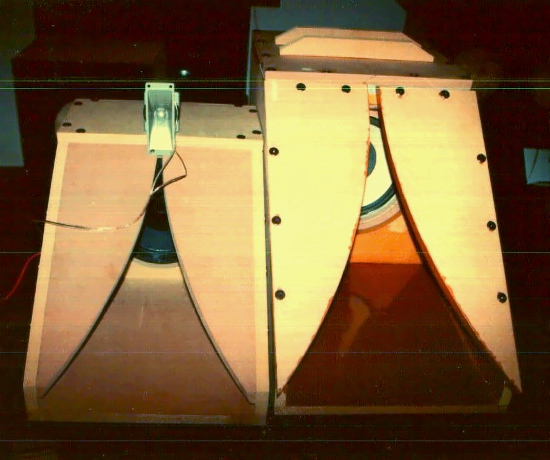

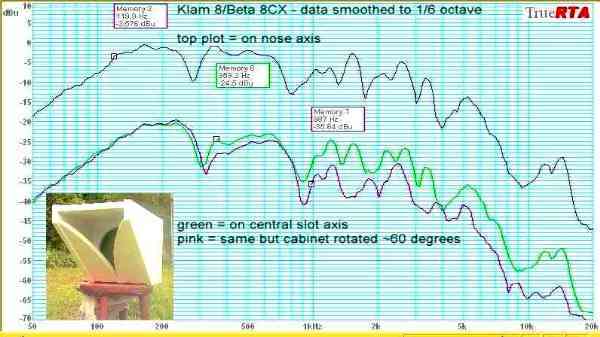

Alan Weiss, who held the last K patent (now expired), manufactured a little 8 inch klam, loaded with Radio Shack's version of the Pioneer "BOFU".
Lars Moseholm did measurements and calculations for this little klam. If listened to close, I would try some damping such as felt and melamine sponges in the front chamber and damping in the rear chamber.
These were made of MDF -- the graphs were from my plywood clone based on its dimensions. I don't know if I kept much of Job Ulfman's K-forum where Alan participated.

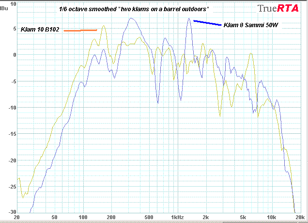

Klam 10 with the correct aperture, a good 10CX, felt in the front chamber, should be a nice performer in a small package - IF one wants to try a klam. Perhaps building klam8 like Carl's klam10 would work well too - ?
btw - that's Beta8cx's woofer only in the outdoors graph with the embedded klam8 picture. That other graph comparing klam8 to
my flawed aperture klam10 is interesting - that's the old B102 with qts=0.23. Its really good in a K12.

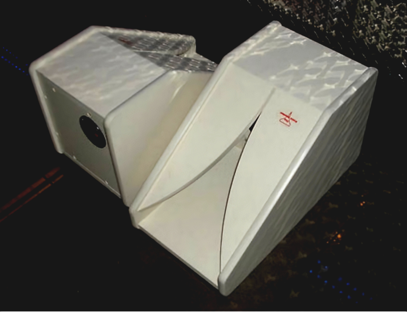

If a Rocket could have the response as advertised it could serve as a replacement for the BIC America side speakers in my system (and look cool while doing so). However I occasionally blow the midrange so the drivers would have to handle some wattage. I wonder how little Bose cubes can handle so much power?
Also a scaled Rocket might make a cell phone enclosure similar to the folded cardboard one posted for a transistor radio.

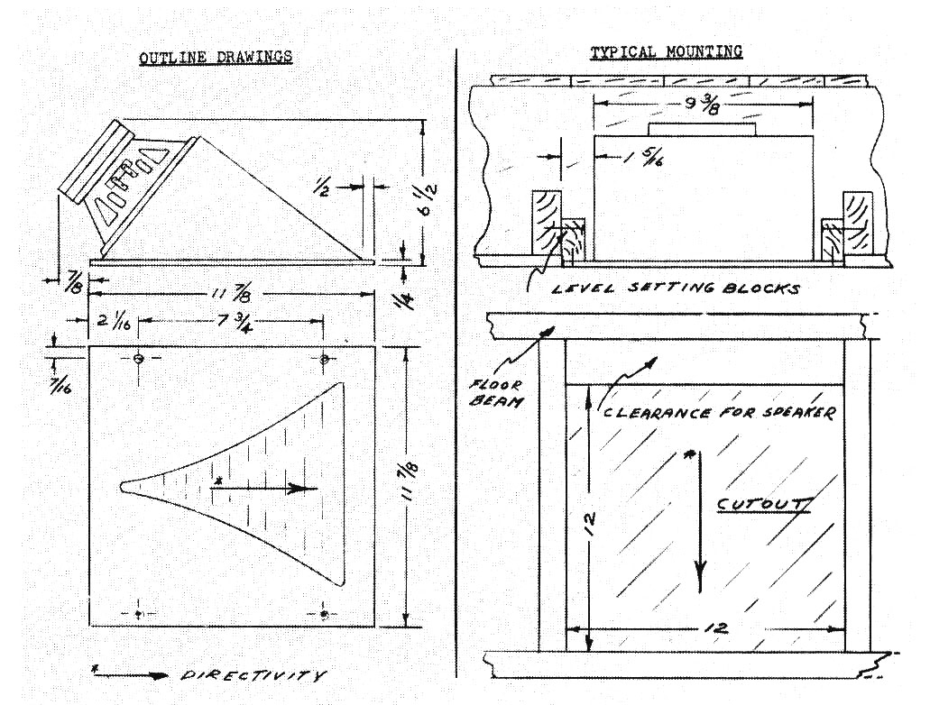

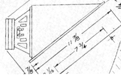

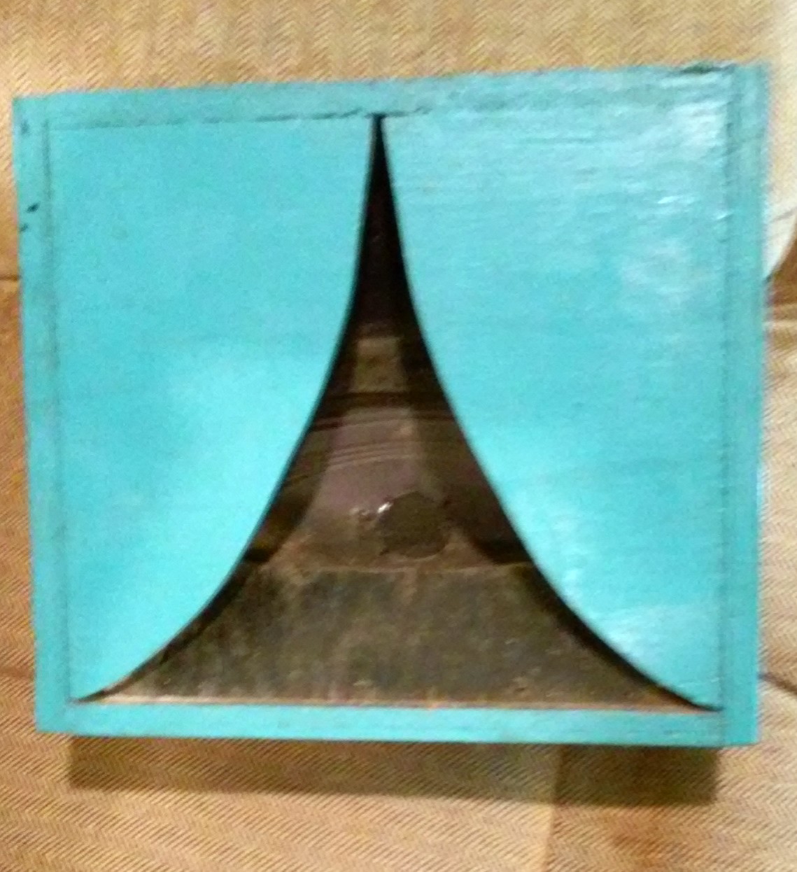

I had a pair of Karlson Rockets for a couple of days - gave them away to my buddy Carl and to the late Martin Poppe. It was far from Hi-Fi with the 160Hz 3 ounce ferrite slug CTS radio speaker having very little highs and no bass. Looking at the picture, how big do you figure the back chamber to be? - seems like it'd be no more than 100 cubic inches ? 3FE22 would work in that volume.
Maybe - say a Faital Pro or Lavoce 3"-4" fullrange with significant on-axis response rise would sound decent. Note the baffle is tilted.
With a modern fullrange, it could be fun. Perhaps foam core for starters ? Cardboard and duct tape ?

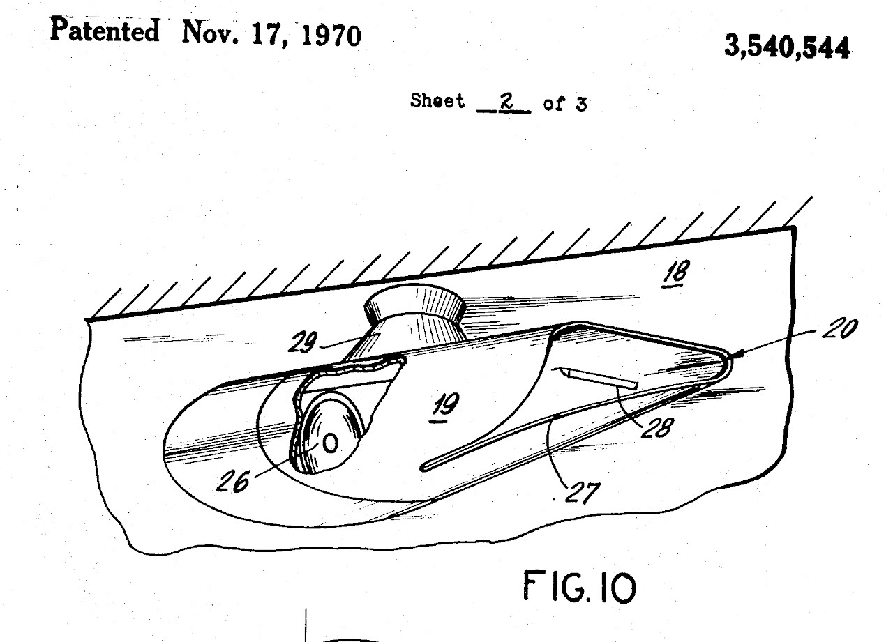

>7. ASHTRAY. An extremely simple design for an ash tray which quickly extinguishes cigarettes.
Let me guess. Insert cigarette into Karlson aperature. Push down into the part where the two curves make the thin slot. Burning head neatly sliced off - falls into tray (where the speaker would be).
It might be fun to place a sloping Klam type front shell on a bass reflex or other type enclosure just to see what front loading might do.
