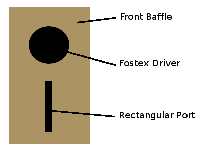

I already own a pair of well braced 15l internal volume boxes made of 19mm MDF, which I would like to use. The FE167E data sheet has an example of this driver in a 15l box, with a port tuned to 67.25Hz. I would like to keep this frequency, as it works well with my sub. In this example, the port is a 5cm diameter by 5cm long circular port. Port velocity peaks at about 6m/s according to WinISD pro.
WinISD tells me that I can replace the circular port with a rectangular port 16mm x 82mm and 19mm deep - and get the same port tuning. Here, the velocity is still ok - peaking at about 12m/s. The advantage of doing this is that the box material is 19mm thick, so I can just cut a slot in the front baffle and get the port I need.
I mainly want to do this for looks. Are there any disadvantages to this narrow rectangular port approach that WinISD can't tell me about?

Not AFAIK in this particular instance. You'd technically get a touch more turbulance, but as the vent air velocity is within reasonable limits, that shouldn't be audible.
The only problam i see with that port is that it is going to make the baflle eveb flopier than it is... you do need to ensure it is well braced.

Thanks plantet10. The front baffle is very well braced, but I will feel how stiff it is after I have cut the slot.
I am going to try it out, and post measurements and photos when I'm done. If it doesn't work, I can always just make a new front baffle.

I slotted the boxes, and they sound really good now. There is no audible port noise at normal listening levels (as predicted), and it looks fairly nice, too.
