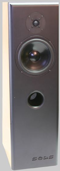

8" bass is usually easy enough in a two way:
517567d1449134051-orangutan-lookalike-seas-njord-jpg
517568d1449134051-orangutan-lookalike-seas-njord-filter-png

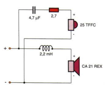

A U22REX would work well enough I think. Joachim Gerhard likes it with the DXT tweeter on a similar filter:
H1499-06 27TBCD/GB-DXT
Sky's the limit on higher order filters. Restoring Monitor Audio R300 bookshelf speakers.

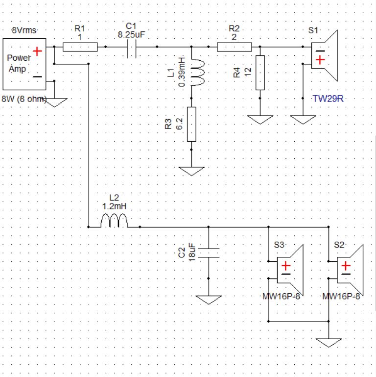

My current speakers are (2) MW16P and Satori T29 tweeter in a MMT config. There is a certain harshness that I can't seem to find the source of. It sounds peaky. In separate threads a while back people chimed in to help and although I was able to make it better I was never totally satisfied. It seems some of the suggestions lead me right back to my current system. Hmmmmmm
Sounds like a crossover problem. Have you got any measurements? Off-axis measurements would also be useful.
#fatmarley I expended quite a bit of time on the XO. In fact after collaborating with others the XO came out very close if not identical to a proven design. I have a feeling it is something up stream in my system OR I just dont like the sonic signature of those particular drivers. Thats the only reason I was thinking of other brands. Plus it's a learning experience for me as I dont design often enough to be as good as many on this forum. I appreciate all the input.

Hope it's not too off topic, but I didn't like anything I saw in your various Satori crossovers... 😱
Assistance with cause of Harshness
SB Acoustic's Rinjani looked much better for a 2.5:
Rinjani - Sbacoustics
IMO, you used too much shunt capacitance and not enough inductance on the bass and midbass. The crossover on the tweeter is too low too for a second order also. Just my 2c as they say.
Lol #System7 thats ok Im not insulted. Anytime I can learn Im all ears. So I agree with your assessment but that design lasted about a week. The current one is attached. Not sure if you will like it any better but I am open to suggestion 🙂
