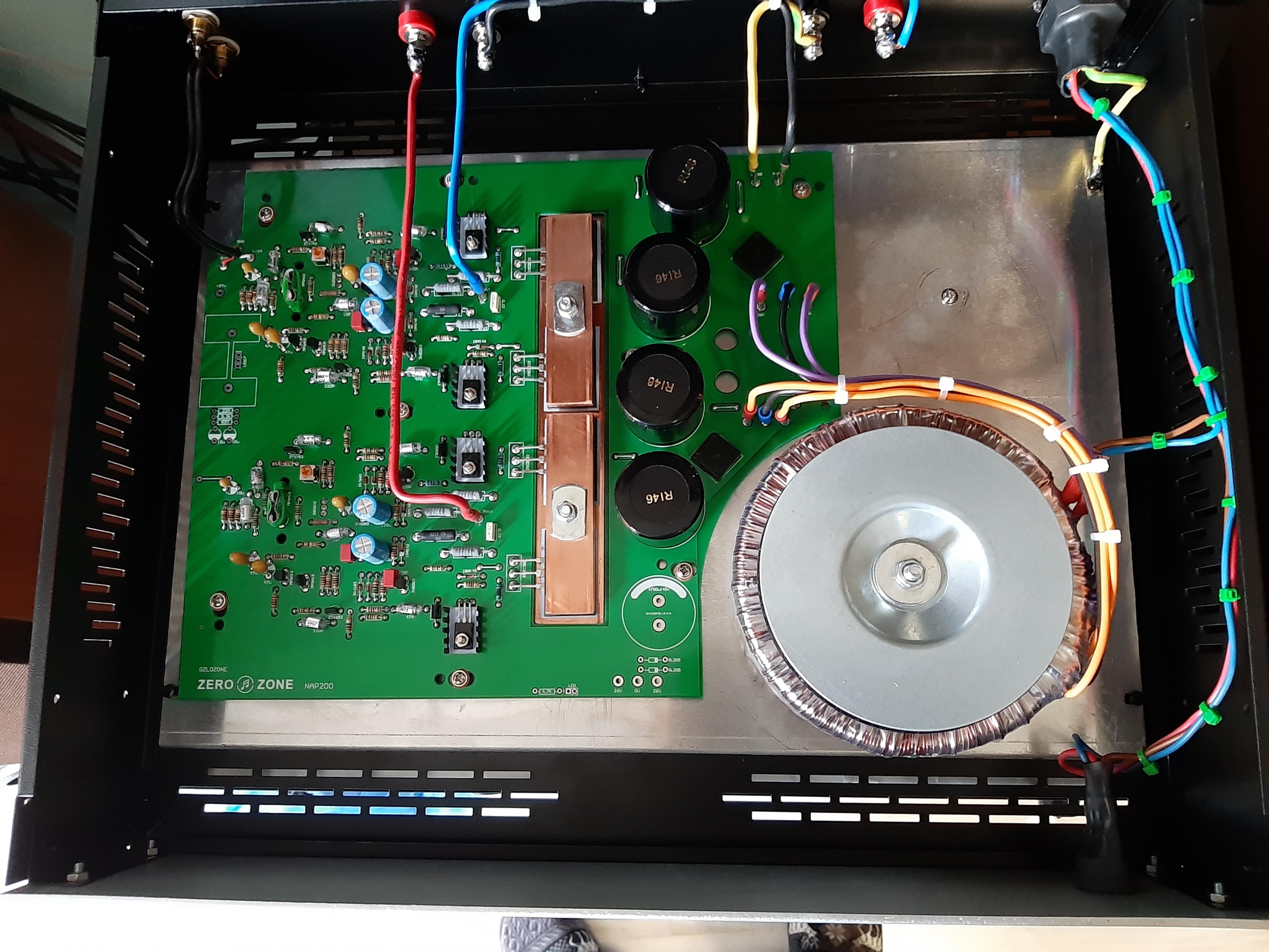

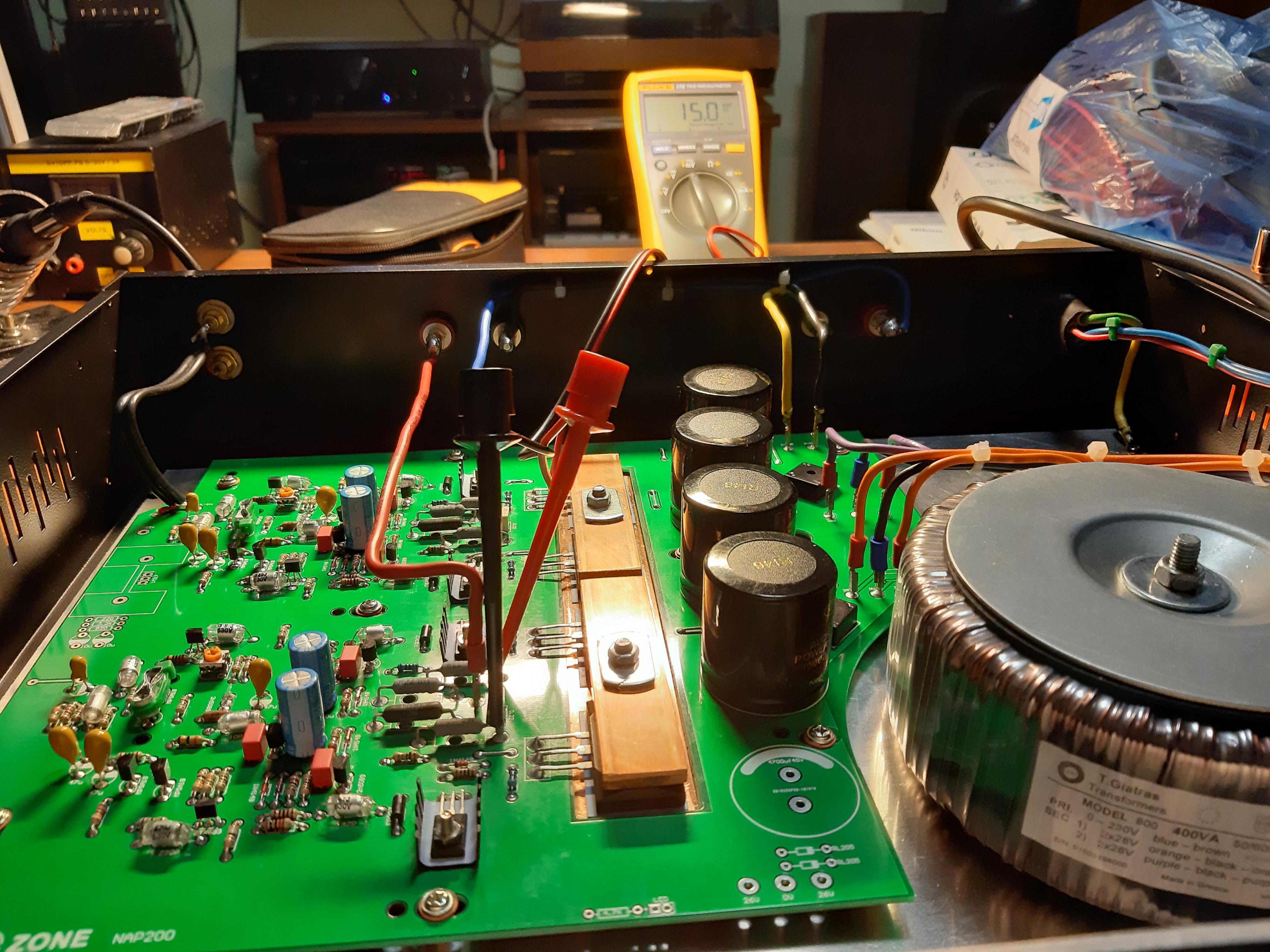

Anybody able to help me, 2 100 ohm resistor burn when I start up my Naim clone... Just after my first test...

The board appears to be a copy of the original so I assume the circuit is as the original NAP200. There are now a lot of "wannabe" NAP 200 clone kits that are nothing like any Naim product so we need to be certain what we're looking at.
The 100R resistors are connected across the output transistor base-emitter junctions so if they are burnt, it suggests the output current was flowing from the drivers through the resistors rather than the output transistors - perhaps because they have failed (shorted). This could have been caused by a few possible mistakes with speaker, output connector wiring etc. but I don't see any insulation pads or mica under the output transistors! - maybe there is insulation (note that the transistor backplate is also the collector) but I can't tell what is really the situation without a continuity or resistance test.
Shorting the collectors of the transistors to the chassis there would cause a big problem and blow some components for sure.

My clone has the same burned resistor at the 3rd Sanken transistor. Mine was caused by the ineffective cooling of the transistor which was also smoked… Have you find the exact 100ohm resistor or did you use a substitute?
