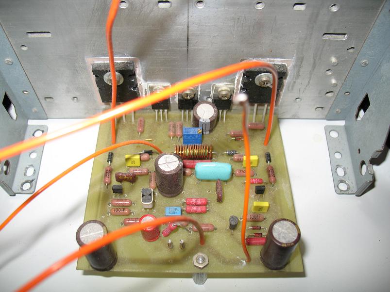

It says, "NAP 140 CLONE" and below that shows "LJM". It doesn't say "140C" like other pictures I see on ebay and prints are little different. For example, Q3, 7 and 8 don't show E B C on my board. Also, C1 and C5 are printed reverse on my board.is the board signed LJM as in the the pic?
OK, thanks. It seems to be another, probably newer revision than I've seen, since I haven't yet seen the word "clone" printed on any. It doesn't help you much but at least there is a reason for the confusion.
Well, I replaced all transistors that didn't pass DMM test and checked and rechecked all the leads but still no change in bias voltage and -34vdc at output. Unfortunately, this board I purchased isn't the same as others. I haven't gotten to light bulb test because I maxed out my allotted time given by my girlfriend. I'm done (for at least 6 months).

Slowly I rebuild my Naim clone.
Actually the schematic based on the NCC200 kit. It sound so much better in any way compare to the Ebay Naim kit not even can mentioned in the same league.
I had two Ebay clone, the first I purchased many years back from Tubes hunter that time he sold his kit expensive and with original transistors (not counterfeit)
At first I did like the amp sound I did listen the amp over 6-8 months.
I ordered other kit for the PC board so I can start to test different transistors and capacitors in each place.
Later I found the NCC200 clone so I took the McBride PC board layout and I modded after the NCC200 circuit.
I built the new amp with the same component like my first Ebay kit.
Sound wise Heaven and earth between the amplifier to favour of the NCC200.

Now after all those test I have to rebuild my clone because I soldered and re-soldered that PC board over 4-5 month it became a junk..
Now the new PC board was designed so I can test the Greg Ball modification to.
I hope soon I ca report back the result.
I kept one side the orig and another side with the mode.

Hello everyone, I am from China, I also recently DIY NAP140, Ó¢¹úNAIM-NAP-140 ??? - Powered by Discuz! ,
do not know the original NAP140 quiescent current is how much? My hands have a genuine NAIM 3R, 0.22 resistor bias is 2.8MV, now I'm the DIY NAP140 is transferred 2.8MV, sounds okay, but I would like to further optimize the use of the power transistor MJ15003.
The bias current for NAP 140 and most similar NAIM designs is already discussed several times in this thread. The current is in a range of 25-38mV maximum before instability becomes likely in the original Naim design with its small case etc. It will vary for individual DIY ideas....... My hands have a genuine NAIM 3R, 0.22 resistor bias is 2.8MV, now I'm the DIY NAP140 is transferred 2.8MV, sounds okay, but I would like to further optimize the use of the power transistor MJ15003.
Remember, the time for bias to stabilise is dependent on the size and type of case because there is no thermal connection to the output stage other than by air transfer or direct radiation. In some installations it may never stabilise and this is part of Naim amplifiers' typical long, >20 min. "warm-up" time.
The voltage is measured across one or preferably both 0.22R "emitter" resistors to determine the bias current. 11mV across 0.44R obviously means 25 mA current. This is a good starting point after first testing with zero bias when building. I hope this answers your question but don't forget to check out other posts discussing the bias setting. Other guys have different ideas and some may be OK if the current is still below the advised maximum.

Hello iam finch, I just do the experiment and found that the quiescent current or in the 11MA (a 0.22R across the resistor 2.8MV) when listening to sound better, specifically natural sound more clear, 25MA, I felt some noisy ear . ^ _ ^
Caowei, at such low bias, odd harmonic distortion begins to increase until you have large amounts of crossover distortion. You will certainly percieve this as clear sound initially, but perhaps after some hours you may not find it very smooth any more.
My questions to you are; does that current setting remain stable in a case or are you using this amplifier open, like a breadboard assembly? As I said, there will be little bias control without an enclosure fitted. Have you tried say, 35 mA bias?
If the amplifier becomes noisy as you increase bias, you have a serious problem with the power supply or amplifier. I'm not sure what, but no amplifier should perform like that. Perhaps you mean to simply say it is not as nice to listen to?
