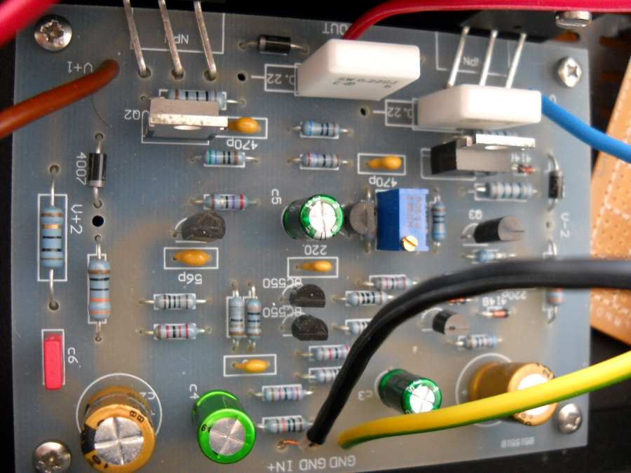

If you connect the Q5 incorrectly, you need to check TIP41C, TIP42C and 2sc5200.
Q5 is suppose to maintain 1.8V - 2.4V Vceo across these 4 transistors.
Without Q5 functional correctly, these 4 transistor may receive +/- 20V bias which may cause damage
I have exchanged Q5 and TIP41C, TIP42C now a couple of times, I am still getting smoke at 100R 🙁

which kit are you using, i've had no problem with mine.
The kit is correct, see a photo of my pcb finished and working for 10 days without problems. ¿why to change q5, tip41 and tip42?

Although 100 ohm resister is smoking, please let it smoke for 5 seconds. During that time, try to measure Vce and Vbe for Q5. I need additional info to help you.
After the measurement, please remove the resistor and let me know the resistance value.

Now i've solved the problem, zero hum.

A photo of my layout without hum. Use the two psu boards. Use a star ground at the output of one of the boards and connect psu v+ and v- of the two boards. See the photo:

Its great to get a good resolution picture of a properly working unit, i can see it all .
