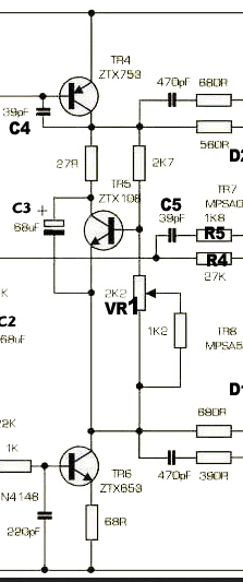

How would that work?The 27R collector resistor in the NAP250 design, I believe, is used to fine-tune the tempco of the bias generator.
The voltage across the collector resistor is basically set by the current source (or sink) for the VAS. It is thus constant with temperature. It is subtracted from the output of the Vbe multiplier.
So to get a given bias voltage you need a higher multiplication factor in the Vbe circuit to counteract the voltage lost across the collector resistor
Thus the tempco is increased as the collector resistor value is increased, since the multiplication factor has to be increased. This allows for over-compensation.
The collector resistor can also correct for supply rail variation if the current source isn't perfect, so that the bias doesn't change when the mains voltage is verying. Increased current would increase the Vbe multiplier's Vbe, but also adds to the voltage dropped in the collector resistor - you can arrange that these approximately cancel.
It can't do both of these things perfectly (unless you are lucky)...

Oh I see where you are both coming from now.
First, Douglas Self is not an audiophile capable designer. His paint-by-numbers approach is never going to give birth to a Michelangelo. Be careful who you learn from.
This "Trimodal" design uses a Vbe multiplier in a different configuration to Naim's. So the temperature effects you mention do not apply to the Naim. Besides that, I thought the Self idea was to set the collector resistor to minimize changes in Vce with current.

I think Mark has already done that adequately, as it applies to Naim (NAP) designs, at least the models I recall. Its a conventional arrangement and about the simplest way to set the tempco to track a particular output and thermal coupling to the output stage. However, like some other refinements, it wasn't used in NAP90 or any early Nait models, as I recall.

This does not apply to the Naim circuit. The driver bias voltage is taken across the whole Vbe multiplier. Changing the collector resistor does not require adjustment; only the Vce is changed.The voltage across the collector resistor is basically set by the current source (or sink) for the VAS. It is thus constant with temperature. It is subtracted from the output of the Vbe multiplier.

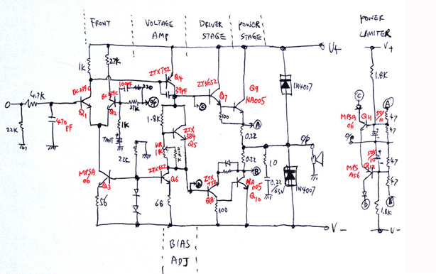

It' a bit late to post this now but just for comparison with Nait5i and the NAP250 schematics, here is a reverse-engineered sketch of the power amplifier circuits in Nait2. It was posted here some 14 years ago by Etsang, with the help of none other than Zen Mod. As you can see, no 27R resistor is used, whether that was a fudged means of altering the thermal compensation in NAP models or not.
That's a little too hazy for my eyes and I'd need to study the reverse side to do better than guess. Back in 2011 at PFM forum, Martin Clark, also a member here, had this to say in reply to a query about the accuracy of the above sketch and others for the associated circuits of Nait2: "the schematics are pretty good. It will work if you build to them, anyway."

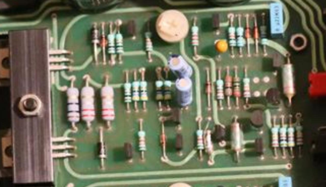

The attached pic is from Stereophile magazine and shows a refurbished Nait 2 board, though the MF resistors shown are original. I count only 23 resistors in either channel. Unless the extras are hiding elsewhere (not underneath) they must either be unusual types of resistor, optional parts or one of our pics is of a revised board.
Edit 2: I understand channel balance was preset at the factory with an adjustable resistor in the NFB path. I don't see any normal type of trimpot there so perhaps those dark brown, upright gizmos in the centre of the board are related to that?
