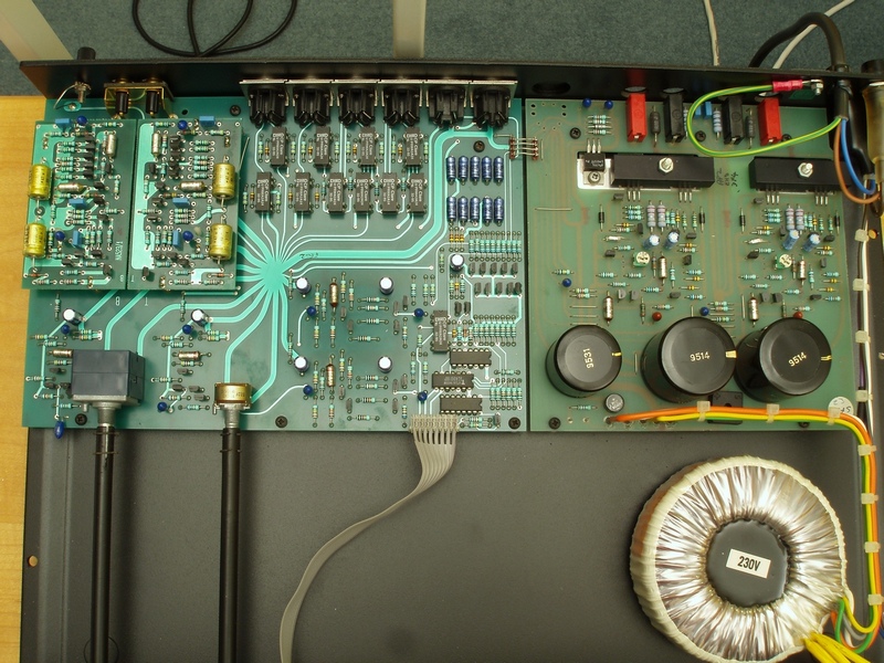

What they did was to extend their range to a cheaper entry level to attract younger buyers. The NAD3020 (20W/ch) was introduced in 1978 and became a best seller. Creek 4040 (30W/ch) was around by 1982; very cheap, very musical. The NAIT1 (13W/ch) was introduced in 1983. The Mission Cyrus 2 (50W/ch) in 1984. This was a boom time for low cost, integrated amplifiers. These models very popular among college students.
It is an anomaly that the NAIT1 and the 1988 NAIT2 were such low power (13W/ch) and more expensive than all the others. This tends to support the story that Naim was unable to increase the power without unduly compromising the SQ although it could have been a deliberate decision to avoid canabilizing their other products. The NAITs must have sold on the back of Naim's audiophile reputation. The NAIT1 didn't even have a pre-amp output and so had no upgrade path. By 1993, the NAIT3 (image below) finally achieved 30W/ch and was based on the NAP90 according to Wikipedia, but the circuit topology is pretty much the same from eye-balling it (quasi without base networks).

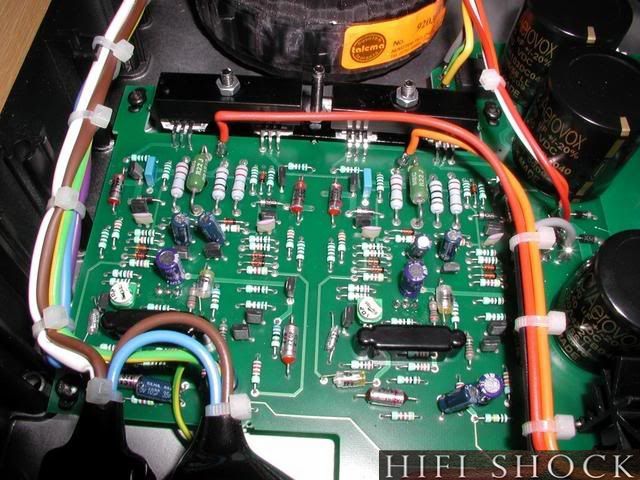

Things started to change more with the NAIT5 (30W/ch). The NAIT4 was skipped? I don't know how much JV had to do with the 5 as he checked out in 2000, the same year the 5 was launched. Largely a Roy George project, I suspect.
The 5 has the same quasi topology but has dropped the tantalum caps in favour of electrolytics and has encased the LTP in what look like RS232 plug shields with plastic caps! (surely not). There seem to be more diodes and resistors in there too and a couple of unpleasant disk ceramics (hopefully in the protection circuit). I've read that the 5 starts to use anti-vibration mounts for the PCBs which sounds like a George thing.

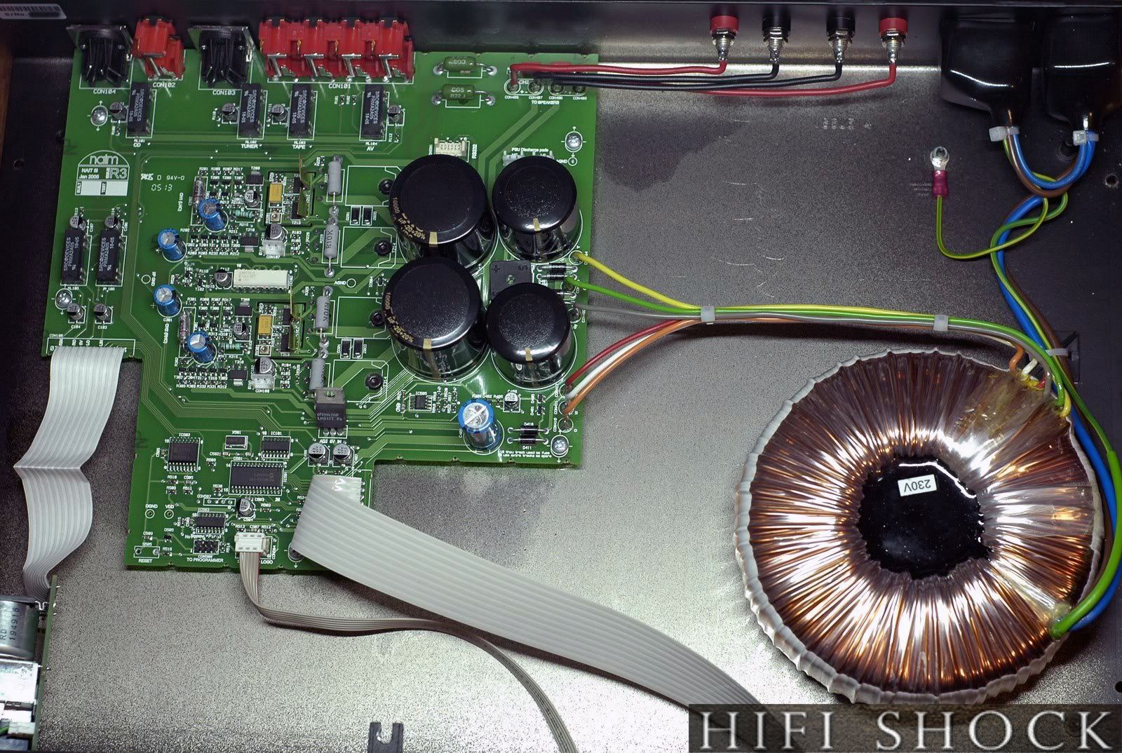

Steve Sells joins Naim in Nov 2001. The NAIT5i (50W/ch) launches in 2003 and is a radical topology change (3779). CFP, lots of surface mount, VAS change, cut-out channels around the drivers (finned) and Vbe multiplier to confine heat, what appear to be electrolytics in the NFB paths. Seems that Sells redesigned it and changed the JV topology that had existed since the 1970s.
NAIT5i rev 3 image (I think):
