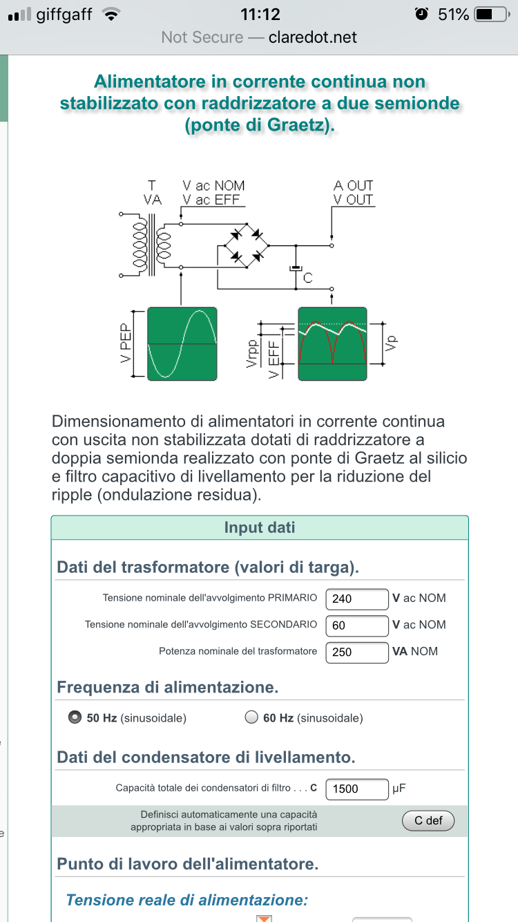

As soon as I can, I sketch the detailed calculation procedure and place it in the thread. It's relatively simple but it's important to set the premises well that I want to explain clearly.
But in the meantime I send a link (in Italian but easily understandable) that allows the rapid determination of the filtering capacity of an electrical power stage that with sufficient reliability indicates the correct value.
The value you get is a little oversized (10/15 %), but much depends of course on the characteristics of Impedance of the speakers and the normal listening volumes:
Alimentatore in corrente continua non stabilizzato con raddrizzatore a 1 semionda
In general, the known and most common calculation approaches are all addressed to the containment of the filtering Ripple, but very rarely pay equal attention to the determination of the correct Capacitance as a function of the load absorption characteristics (speakers) both in static mode with a constant sinusoidal signal and even less in dynamic impulsive mode.
And the result is usually always an exaggerated oversizing that makes the sound "swollen" and poorly articulated and fast on the mid-bass, to be drawn from the quality of the capacitors used.
And the result is usually always an exaggerated oversizing that makes the sound "swollen" and poorly articulated and fast on the mid-bass.
I just tried the calculator but it does not take into account a functioning class A or class Ab.
I think after having done some tests that for AB it seems to be a match.
I put numbers in for the 250DR. I halved the VA since the transformer has to feed two channels. With two 10000uF caps in series the Naim’s model equivalent is 5000uF. The model recommends 1500uF.
I wonder how the model works.

The considerations are correct, but with the Naim, being in the case of an amplifier powered by two power rails (Positive and Negative), what the program asks you to indicate in the initial box is simply the effective value of the AC voltage output from the two single secondary transformers of the power supply.
That is, if we want a 42 Volt DC supply voltage, you must indicate an AC voltage of 30 Volts (42 : 1,414).
And the correct power to be indicated in the case of a single power transformer for both channels, for the same reasons as above, is not 250 VA, but 125 VA.
Therefore, if the values described above are set correctly, what the simulation program will give is not the analytical value, but rather the available value of the normal commercial capacitors (6800 uF), rounded up or down.
Obviously, in the case of a stereo amplifier, this value must be multiplied by two.
I think that the calculator just assumes that the relatively high level of ripple at 80% of the power rating is an acceptable amount. Some folk will disagree strongly with that, count on it.
In reference to any of Naim's 250 models, power supply regulation completely changes the relationship between supply and load - we are now examining the response of the linear regulators since any dynamic influence of the rectifier smoothing caps is virtually isolated from the power amplifier.

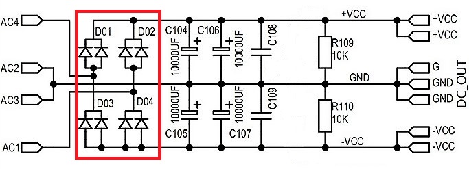

A transformer with a single rectifier diode reminds me of a two-stroke petrol engine. Once per mains cycle the transformer blasts charge into the filter capacitor.
Two half-wave rectifier (Graetz bridge):
Alimentatore in corrente continua non stabilizzato con raddrizzatore a ponte di Graetz
Two half-wave rectifier (Graetz bridge) with stabilization:
Taking into account and accepting the high negative feedback that any stage of stabilization involves, whether it is made with integrated circuits or discrete components.
Alimentatore in corrente continua con uscita stabilizzata (raddrizzatore a ponte di Graetz)
Double half-wave rectifier with two diodes:
Alimentatore in corrente continua non stabilizzato con raddrizzatore a due semionde
Preferred solution to that of the trivial and cheap Graetz Bridge, because by installing one or more diodes (perhaps fast type and still much better than the normal Graetz Bridge) in parallel for each branch, you can significantly reduce the internal resistance of the entire stage of power supply, bringing our power supply to the ideal Theoretical Voltage Generator.
An aspect punctually ignored also in expensive and prestigious amplifiers and that repays with a sound clearly more seductive and realistic.
Diodes in parallel is new concept to me... How is that working? Isn't one of them just sitting there doing nothing, unless sharing is ensured with small series resistors?
Diodes in series is a popular technique, but I've never seen them used in parallel...
