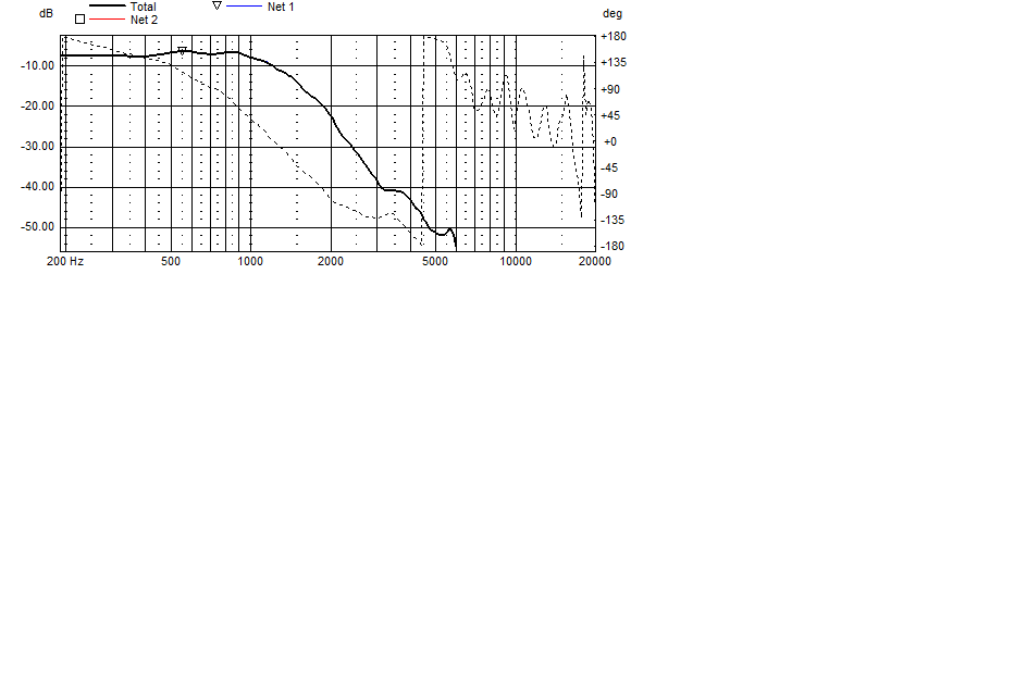

Not correct. The filtering/EQ for the upper end of the W22 has never been changed since Orion inception.
Here's a frequency response plot of my own Orion's showing the upper end roll-off of the W22 driver with Orion ASP in the loop. Any remnant of the W22 resonant peak is fully 40db below the nominal level.
Anyways, this should be a thread about John's NAO Note II speaker (and maybe similarities to LX521) and not Orion's.
Dave.
