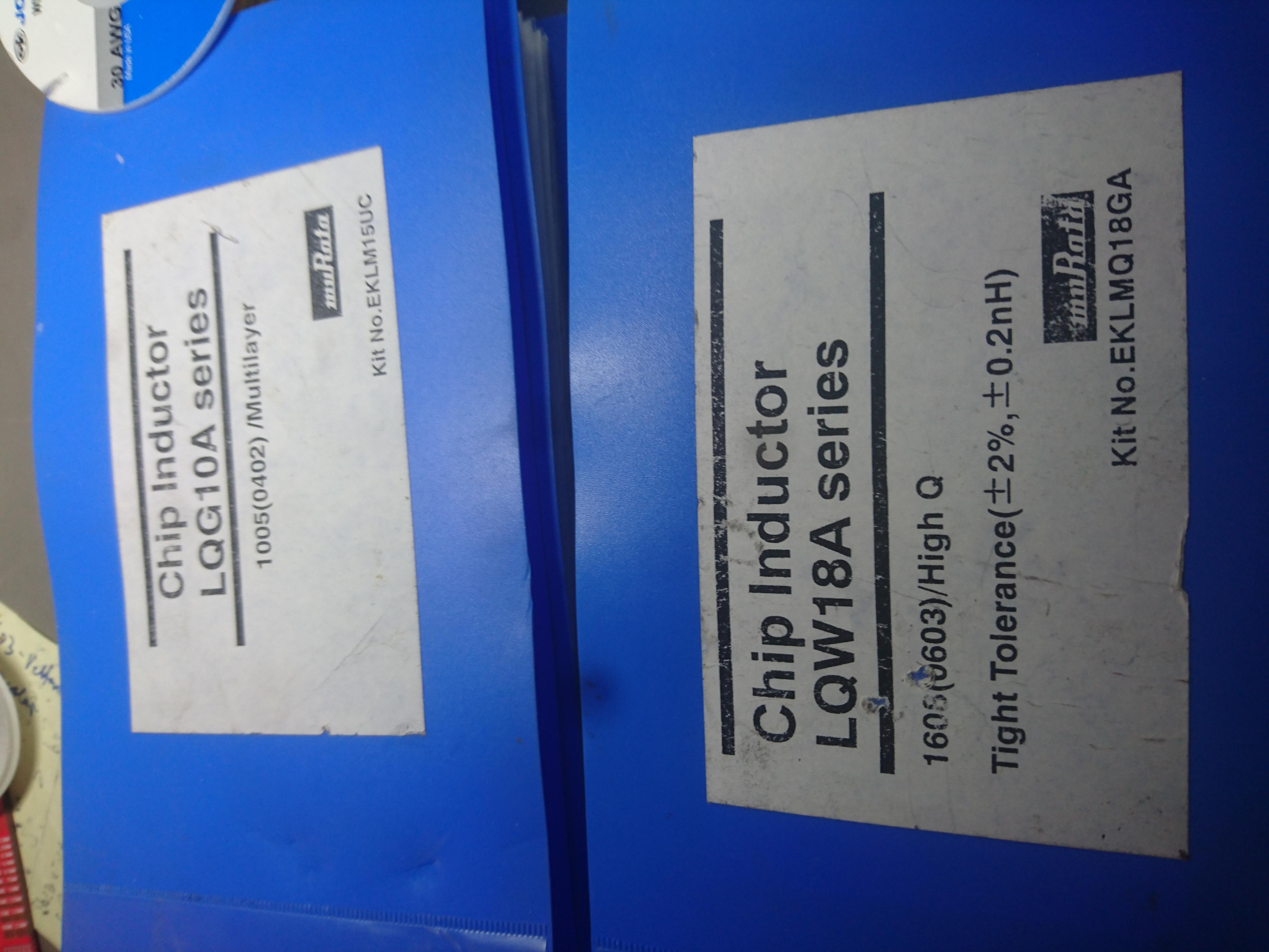

I said:
"Unless the inductor/capacitor "plots" away from the outer ring of a Smith chart you will be unable to measure them with any reasonable accuracy. Your better off using manufacturers data."
In the 90's I replicated the functionality of the HP4191 1GHz RLC meter using my VNA and a HP computer. I also had a HP4191 at work. Neither could accurately measure a few of the inductors I was using in a complicated BPF so I could do CAD modeling. I ended up using a Q meter and the inductor data was used in my CAD simulations. The data from Coilcraft was unusable.
Recently I had to design a number of JFET amplifiers and XTAL BPFs for a UHF receiver. I used my ancient Q meter since my VNA was incapable of measuring the high Z of the JFET and XTAL stages.
