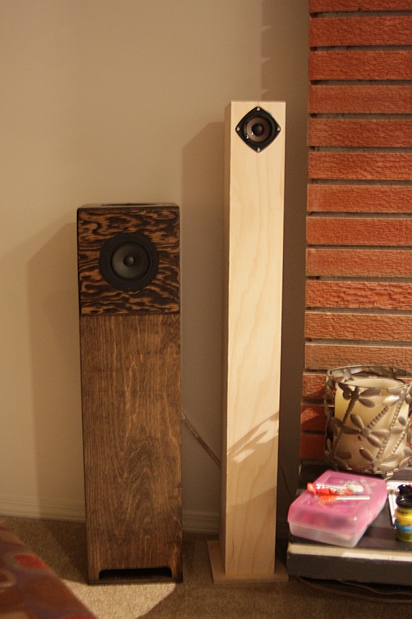

I bought a pair of these ("buyout", $10 each) Tang Band W3-881SI on a whim, based on inspiration from another thread. My original plan was to make very small, sealed boxes for them, for near-field listening.
Then I started looking at Cyburgs-Needle and TABAQ, and became more interested in seeing what this little, cheap 3" driver could do in a large(r), ported enclosure.
Neither Cyburgs-Needle nor TABAQ fit my height criteria of 42" (they will go in my bedroom, and they need to be tall enough to reach over our bed (which is quite high).

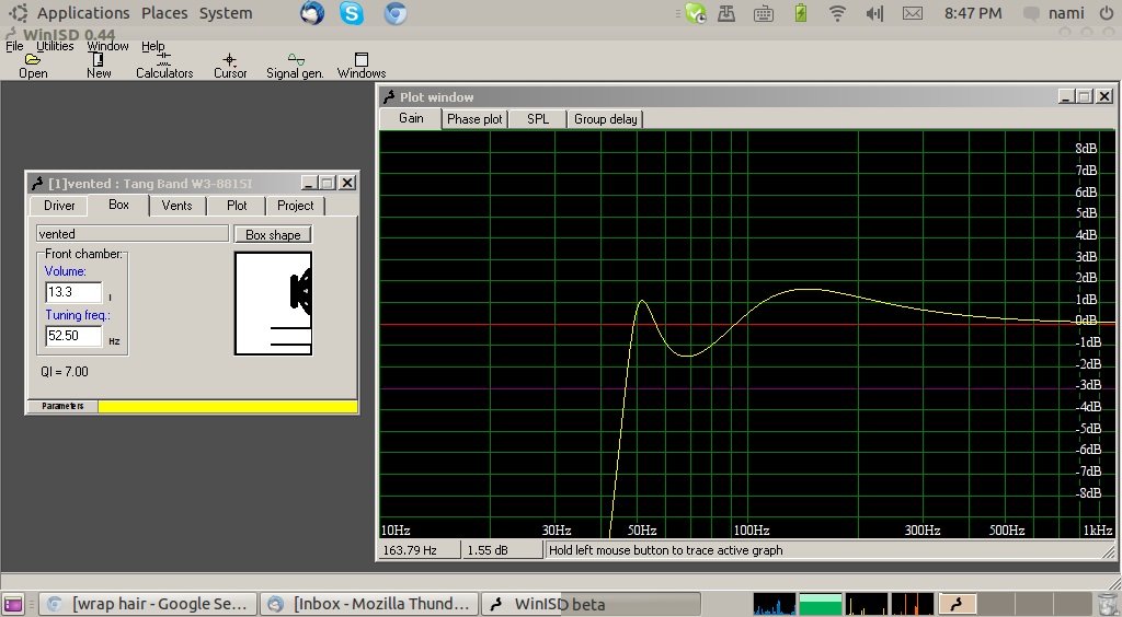

Anyway, I opened up WinISD and plugged in all the specs that I could find for the W3-881SI. I then designed a (12mm plywood) box 42" h x 4.5" w x 6.5" d (exterior dimensions) for a total interior volume of 13.3 litres, with a tuning of 52.5hz (port 1.5" dia. x 2.5" L). (see photo)
It looks very much like Cyburgs-Needle, but taller (See photo), and it is not optimized for Quarter Wave or transmission line, AFAIK (ie. I did not use M. King's worksheets, as I have no idea how to. So this is just a simple bass-reflex design. If there is any QW or TL going on, it is by accident 🙂
The total cost of this project was $77, tax and shipping ($26) included. I am extremely satisfied with the result. i still need to sand them down and stain them, etc.
The best part; they sound fantastic! Not as refined as my microTowers of course, and they reach their SPL limit sooner than the microTowers, but I never expected them to compete with the mTs anyway. I also did not expect them to sound as good as they do, with as much bass as they have. I am truly amazed what can be done with a single 3" driver. I've been walking around with a stupid grin for the last couple of hours. My wife is getting annoyed. 😀

The BR tuning is much lower than i would go.

But is it lower than you would go with QW/TL ?
It seemed to look good to me in WinISD as a simple BR, not far off the 16 litre suggested by the app (which was tuned to 49hz).

I really like these, very clean looking. Nicely done!!
Scott
Thank you, Scott. I plan to sand them and apply the same stain as I have on the bottom portion of the microTowers, plus a couple coats of satin. I also really want to find some black scews for the drivers (neither Home Depot nor Rona carry little black wood screws ?!!)
Ooh that'll look nice in that finish. Although I do really like the light look and with a nice satin finish could look plenty appealing, depending on what's already in the room.
I got my black screws from Parts Express but I ordered them when I ordered a bunch of other stuff so it wasn't a big deal. HD didn't have any black screws? Do you have Fastenal up there? They have them and are usually all over the place.

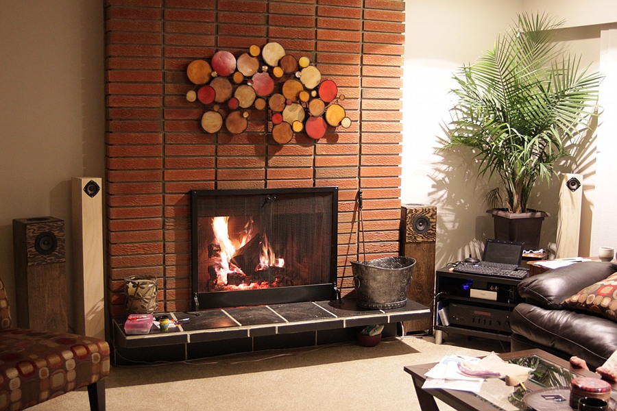

BTW I love the art over the fireplace. Danish Modern design?

I like the natural colour of the wood as well, but everything in our bedroom is black iron and dark wood...
I am not sure if we have Fastenal or not, I'll have to check. There are a couple other hardware stores and lumber stores I can check, and a surplus electronics type store as well. If not, I'll just include a bunch in my next PE order.
I am not sure about the origin of the art piece. It was on sale ($30 marked down from over $120) at Pier One Imports because it had a bunch of paint scratched off one of the circles (a hack saw fixed that problem 🙂 ). We love it too 🙂

Oh if those are the colors you already have then the darker would definitely look better.
That's a fantastic deal on that piece! Sure looks mid-century, very cool.

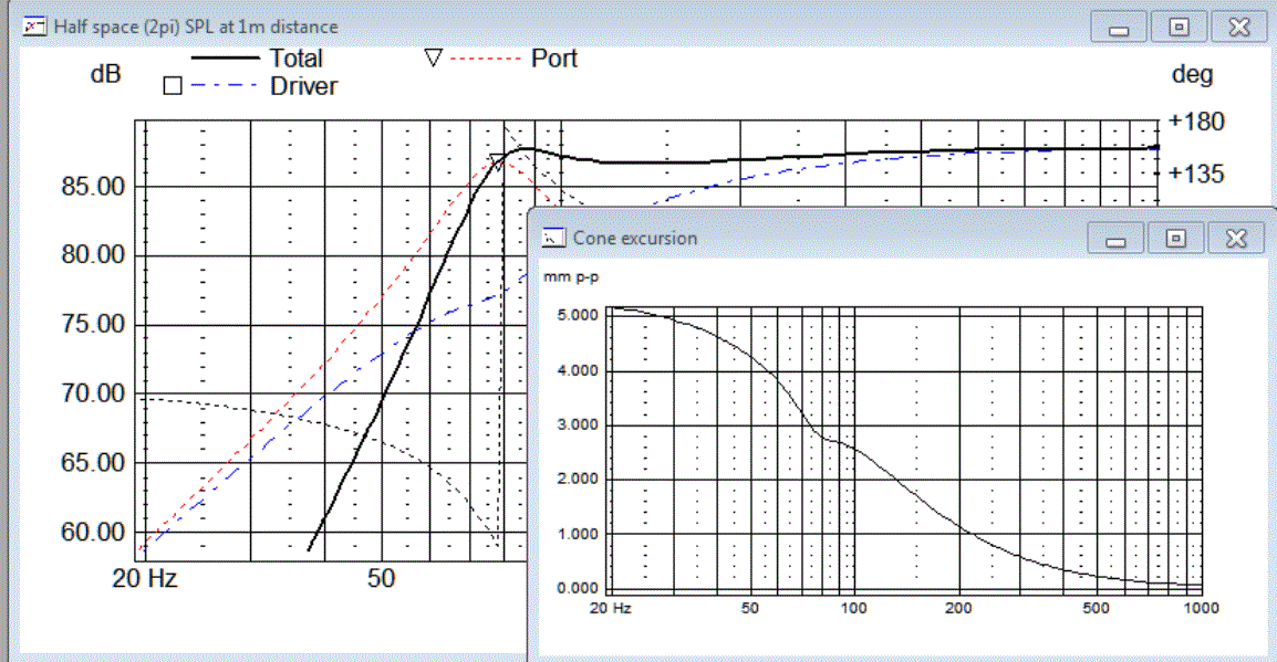

That drivers Qts is way to high for it to be 'happy' in a ported box but there are things you can do to optimise its performance.
Usually you don't need or don't want to heavily stuff reflex boxes, but in this case however it will work significantly to your advantage by lowering the large peak introduced by the port. As Dave says the lower tuning frequency is a little too low, but given the driver and your simulation you didn't have much choice.
This driver will produce next to no bass when put into a sealed cabinet, which is really what its Qts would make it better suited to. Indeed with a Qts that high, it'd be well at home on an open baffle or in a situation where the rear of the driver has no box around it, such as the parcel shelf behind some cars backseats. Of course it would need crossing to a bass driver at something like 300hz.
You can however faff about and get a decent response out of it in a ported enclosure and this could be somewhat how TB intend you to use it.

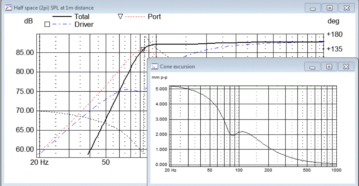

Given your ~13 box, if you stuff it full, tuning it to around 80hz will give you something like this...
...which considering you've probably already stuffed your box quite a bit, probably isn't too far away from what you're using now, albeit with a high tuning frequency.
It is however really suited to a smaller box. If you whack it into a 4l box, again heavily stuffed, and tune to around 85 hz you get this...
You can see however, that even with 1 watt/2.83volts, that the drivers xmax is exceeded in the blink of an eye, the smaller box does help to control this a little bit more. Of course you get lower extension in the bigger box but the maximum SPL is lower.
Of course none of this is taking into account any influence that your really tall and narrow cabinet could be having, although I would miagine that any TL action would be negated somewhat by the position of the port. Where is your port located?
