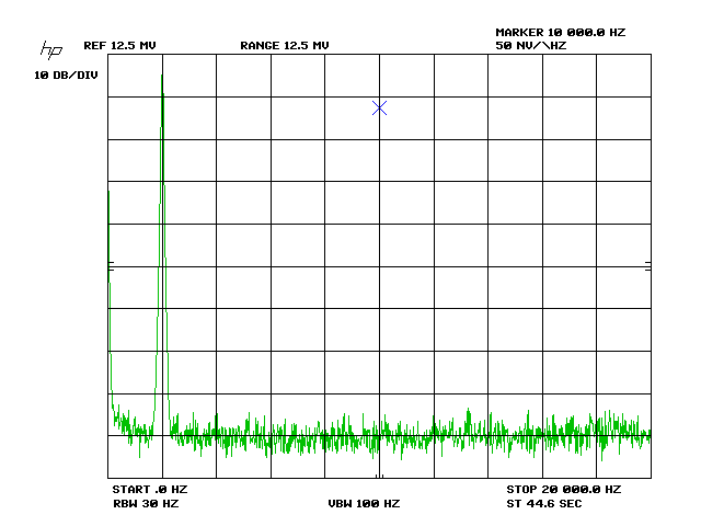

I've got the mute working, the volume and the level detector bi-color LED. it turned out that the Low pass filter for the level signal generated negative signals, even if the source was the absolute value of the inputs. (typical IIR with limited wordlength). I've set the signal present green led at 1mV rms. below is the signal purity at 5Khz. signal source NTI minirator (approx -80dB second harmonic). the 3rd harmonic is from the ADAU1701.
the crossover is working fine, that was the easy programming part. most of the programming efforts are in the level detectors and mute power-on timer

Ok , I populated one board and found that I was tricked by eagle, as it's default npn sot-23 package has the emitter on pin 1, the left pin. so the mute transistors are now mounted belly-up. the only available reversed transistor I have found is the BFR92R the R meaning reversed.
for the rest it operates as expected. enclosed a peek on the sigma studio diagram, and the analyzer signal showing a clean signal. signal generator was a minirator from neutrik instruments.

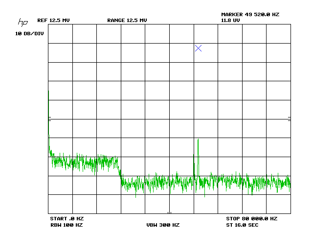

open input S/N
now with the ADC input open, generator off.
currently the program has a gain of 2x , as I wanted to be able to clip the outputs.
there is a residual at 48kHz and for the purists, a 10uV rms residual at 49.6kHz coming from the "noisy" dcdc switcher. what a good layout and alu polymer capacitor can do.
Interesting to see the ADC input noise reducing down at the audio band edge. the ADC max input signal is 4V rms balanced (2V per leg) , while the output level is limited to 1.6V rms (0.8V per leg). still perfect for amps rated at +6dB (re 0.778V) full signal. the ADC is the usual limiting factor in the chain...
