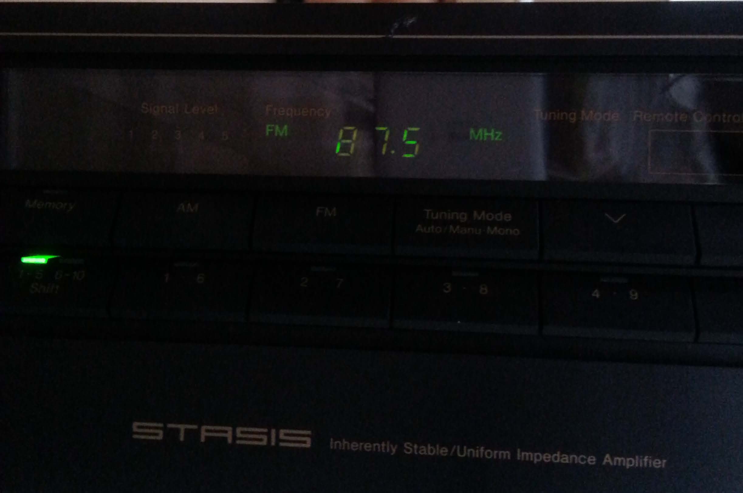

Can some one please guide troubleshoot steps to restore operability ?
orange power light indicated but no display and no relay clicks on power up.

easy SR-4A
Orange light indicates fault.
it is difficult upsidedown power board measuring proper dc feeding voltages, toroid and power board upsidedown dismantled, key voltages threesome 5.6, 10 (12), 30 dc.
Orig discovery 2amp fuse open and power board sponge underside leaking energy out of system. Replcd 2amp pigtail fuse, zd403, q403 and q402. (Zener6.8, c945, d1406)
Yet persists orange power light.
Checked bridges okay out of circuit (three).

I had the same problem on a SR-4E, fixed it by replacing Q404 and D414. Used a KSA733 and a 1N4002. (also replaced Q405 while I had it dismantled, but it was probably not needed.)
It booted up into solid green power light.
Replaced q403, 402, 404, 405, 406, zd403, 404, c427, retraced copper patina compromised of sentinel ac sense between cn20 : t2
But bootup takes about seven green blinks before solid green engages consistent without fault.
But tuner display illuminated dim, why? Should change 7812 regulator on power board?
Or could it be nte ecg equivalents of replaced discretes above are actually not compatible regardless of blessed equivalency?
BTW, on powerdown, before solid green indication extinguishes, orange light very very short duration seen, is this bad news?

I should flash for about 5 seconds before solid green.
If it's under 4 seconds, a capacitor in the protection circuit is out of spec.
A short orange flash is normal, at least I also get that on mine.
All segments on the digits equally dim on the display or the AM/FM indication?
Ok five seconds boot permissivity blink green affirmative.
No , all tuner display segments non homogeneous illumination.
Particulars segments dimmer than others, rats, more investigation req'd.
Pushbuttons engage speaker pairs A or B triggers independent clicking sound relays, good news?
Advise tuner display dimness recovery please, it could be merely mini molex wiring reseating cure.
