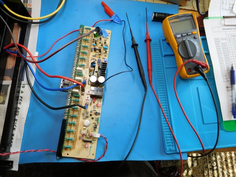

Well, testing is slow going. At the best, it takes me about 45 minutes to set up my test gear and the amplifier sections on the dining room table, and I have limited time to work, hence the delays between recent reports.
First I pulled ZD13 in the protection circuit the right channel and it measured very close to specified 6.8V. I also pulled Q136 and it tested good.
I installed Q116 and Q117 in the right channel board without the heat sink attached, then shorted C106 to maintain zero bias. I checked voltage at R126 and R127 which were +0.2VDC and -0.2VDC respectively.
However, voltage at the test points was -76.9V, indicating a short to ground (I think I made an error in an earlier post and noted a positive voltage). I used a Fluke IR thermometer to check heat levels and found heat building pretty quickly at Q110 and Q111 (2SA1370), as well as Q106 (2SC2705) - about 68C.

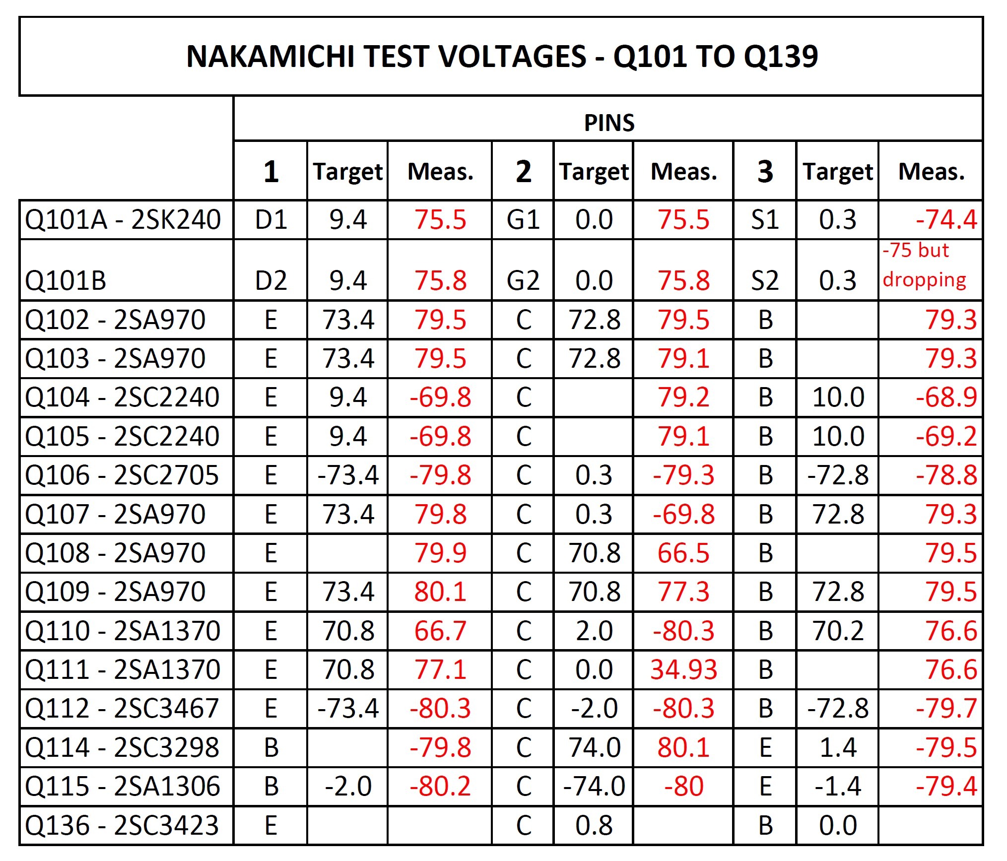

There is supposed to be -72.8V (with everything connected obviously) between the bases of Q106 and Q112 (2SC3467), but I measured only 0.70VDC. I shut it down to let everything cool, then fired it up for more measurements. There is supposed to be about +70.8V at each of the emitters of Q110 and Q111, but I had zero volts.

What is the base voltage on Q110/Q111?
also check B-E on Q110/Q111- should be around 0.6v
What is the base voltage on Q108?
same B-E test
Does ZD12 test OK?
same B-E test
Does ZD12 test OK?
I read the schematic as meaning both the bases of Q106 and Q112 should be -72.8V which would make them 0.6V higher than the emitters and tallies with the stated emitter voltages .

I made up a table for all measurements. I still can't find any component that is shorted or open, but it's clear something is very wrong.

Are all the grounds connected particularly the ground on the input and are they connected to chassis .
I'll be reassembling the chassis and right channel board for more testing today, and will re-check ground connections. There are 3 ground connections to each board - input shield, center tap of the 2 3,300uF filter caps, and the PS ground. These all originate at the PS filter cap/rectifier board, and I know they are connected securely, but your question (same asked off-list by pwdiya12) has me wondering if my ground connection at the input has come loose.

Hey! Some progress!
Thanks to pwdiya12 and epicyclic, I re-examined the signal ground to the input and found that my repeated removal and installation of the board for testing had damaged the thin wire at the terminal. I made a secure extension piece, as well as an extender for the limiter-protector wires to avoid damaging that, and to place the circuit board more securely on my anti-static work mat.
Voltages are now pretty close to expected, though higher because there are no outputs installed.
The best news is I found a resistor that goes to the collector of Q111 that is way out of spec. It was OK when previously tested with my DMM, but I think it was on the margin and developed high resistance throughout this work. It should be 18k and measures 1.23meg. Not sure if that is causing the unexpected collector voltage on Q111 - should be 0 but was -5.77V.

Check the voltage drop over each and every output emitter resistor as the test point only measures across one , this will show you any variation in the output devices and hopefully any suspect ones .
Well, that didn't reveal very much, unfortunately. None of the emitter resistors showed much voltage drop, though there was variance, because the bias can't be adjusted past a few mV. However, when I do adjust the pot, the bias reading stays about the same, but current draw on the entire circuit goes up, with rail voltages dropping from about 77V to 64V.
Moving to the right channel board, Q110, Q111, and Q112 are all running hot at about 46-47C, while all other components are about 24C. Also R111 is specified at 162k, but has a slightly burned end where the lead enters the body, and there is the beginning of a discolored band, and it measures 57k. I'll change that and re-check. The trouble seems to be originating in this section of the circuit, but I can't find any obvious reasons yet.
" When you adjust the pot the bias reading stays about the same but the current draw on the entire circuit goes up "
This is my point does the bias stay the same on all of the outputs devices
