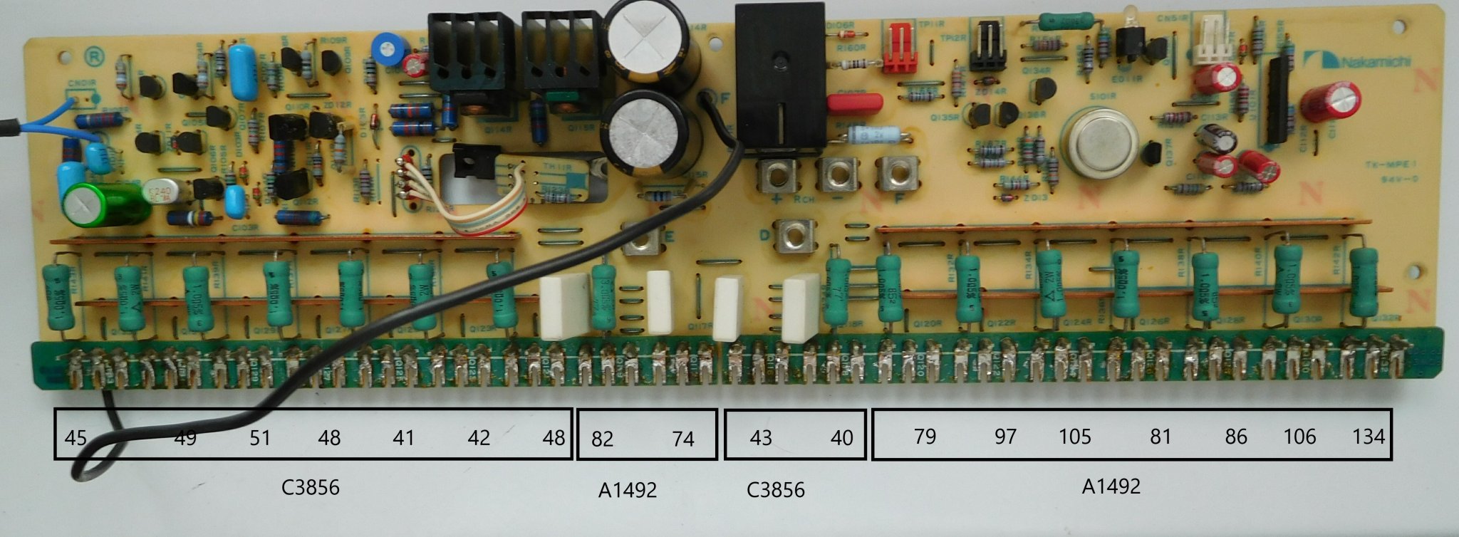

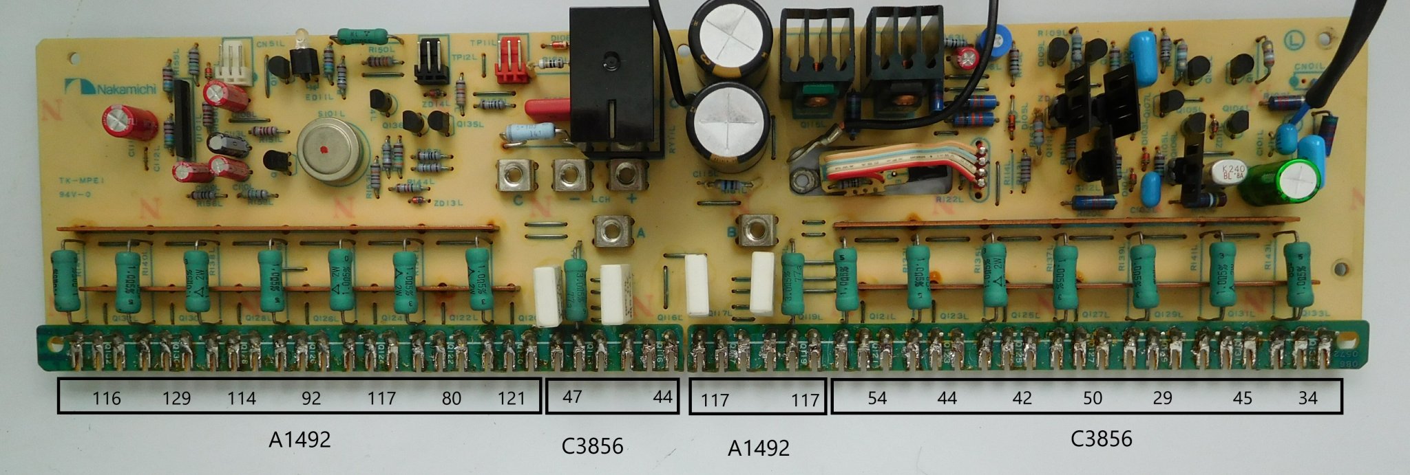

What I've done so far is to replace the missing electrolytic caps as well as the remainder on each board. I've also tested the output transistors with a Peak DCA75 just to find out if they were shorted, and get a rough idea of condition. The photos show the hFE reported by the Peak for each output transistor in their original positions (they were numbered when removed). They don't look great to me - many are very low, and the variance is pretty wide. Unfortunately, new replacements aren't available - the ones for sale are fakes.

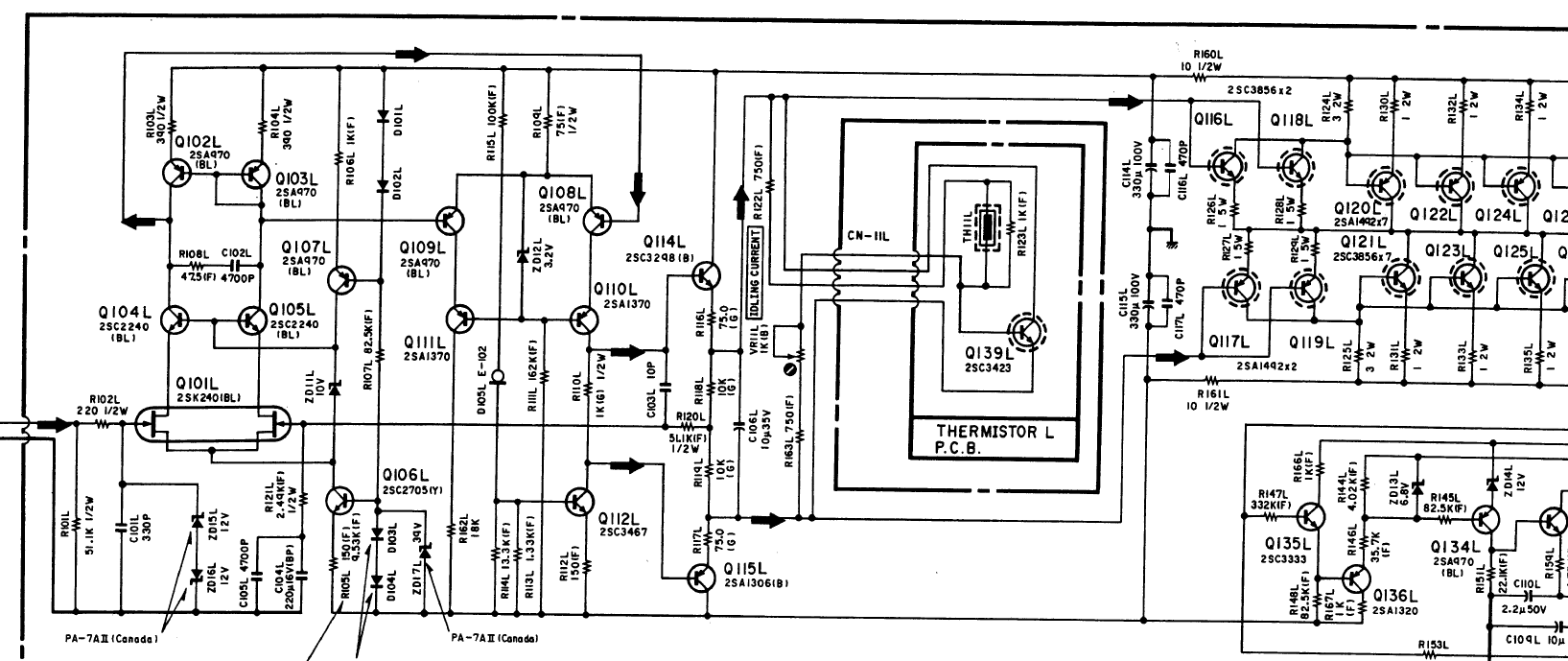

Thank you for posting the schematic in the thread.

Starting with the left channel board:
C106 - original was good, replacement is good - 10uF/35V. EDIT: the solder pad was partially gone - apparently when the tech removed it he damaged it, but there was a connection to the circuit. I rebuilt the pad with wire.
R122 - Specified 750R, actual 725R
R123 - Spec. 1k, actual 1.006k after lifting leg
R163 - Spec. 750R, actual 726R
VRII - New 4 turn 1K
Q139 - original tested good, replaced with NOS C3423
So no clues on left board with these components. I'll start on the right channel board next.

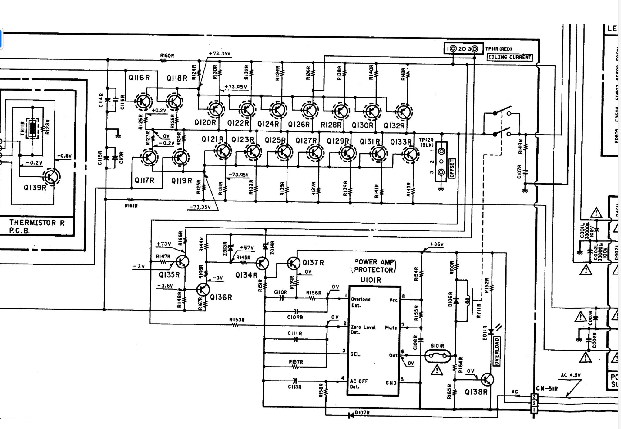

One thing that really puzzles me is how I can measure 79VDC across the offset test points, yet the DBT is not glowing and there is very little current being drawn. Is that the protector circuit doing its job? And, why, if the outputs and drivers are not shorted, would that even occur in the first place? When I measure across the rails on each board, there is no indication of a dead short.

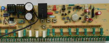

Here is a photo of the board and section of the schematic showing TPI2. The PA7II doesn't have offset adjustment, just test points.
I tested the output transistors on my Tektronix 577 and found two C3856 and one A1492 with early onset breakdown. Linearity was quite varied across all transistors, as was gain. In fact, hFE under higher V/I test conditions than the Peak DCA75 could deliver showed a pretty wide variance in gain, with many measuring worse on the 577. I'm starting to search for suitable replacements. Not many in TO3P with similar characteristics. There is a Toshiba pair and an OnSemi pair that are close, but 30mHz devices, not 20 as original, and I don't know if that will cause problems (assuming I can get the front end working properly).
I have yet to pull any of the input transistors to check out of circuit, or the protector circuit transistors. Not sure what I'll do if the C3333 or A1320 are bad since they are NLA and as yet I haven't found very close matches in available devices, though it seems there should be something.

You only need one output pair in circuit to retest the output offset but should you do this make sure its Q126 and Q127 as the protection circuit also monitors the current across Q126 's emitter resistor . I think you are fast approaching the point when you need to start measuring voltages around the circuit and comparing them to those shown on the right hand channel schematic .
