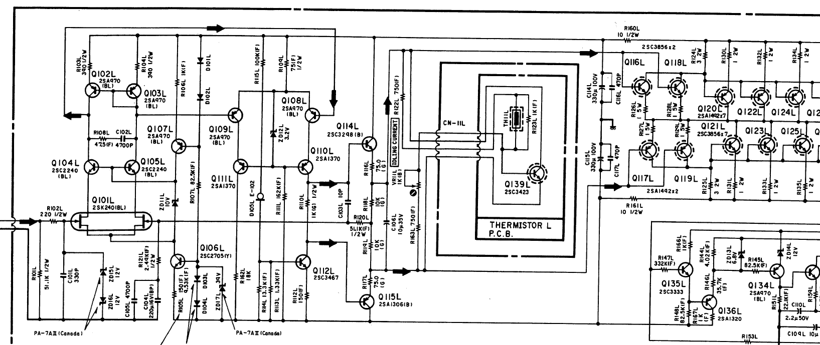

Dear All,
It is my first post on this forum. I have a Nakamichi PA7 II (european 220V version). It is been running very well until few months ago where right channel started to sound bad, saturated. When warming up, it sometimes desapears, but it is not stable, and the right heat sink remains cold for hours, slightly warm when listening at high levels for a long time whereas left channel stabilizes in 15 minutes to a pretty warm, hot to the touch but acceptable temperature, just as the right channel did for years.
After few searches, I realizes it was likely related to idle current adjustement.
I followed the procedur in the manual, Warmed the amp and then tried to find the screw postion that gives 40 mA idle current. This was pretty straight forward for left channel, which was at about 45 mA, I played with it and set it up at 40. Right channel was much harder to stabilize. The screw had almost no effect on current, until it started going versy high and run hot... Then I managed to stabilize it around 40, but when starting from cold, does not reach 40 any more, and doesn't warm up as Left channel does.
It seems to me that the thermistor might be out of order.
What so you thnik? Are those thermistors easy to find? and hard to replace?
Thanks for reading.
Best regards.
Lionel

I just measured the resistance from both right and left channel pots (VR11).
They behave exctly the same, from 0 to 1000 Ohm, pretty linearly.
I also checked the resistances (R163 on attached scheme) which are directly next to the pot and they are both 1000 ohm, as the schematic indicates.
When turned on, Left channel starts at about 130mA idle current and stabilizes around 40.
Right channel remains at 2mA. I measured the tension at the resistance next to the pot, it is at 470 mV on both sides.
When I turn the right channel pot from 0 to max, the tension at the resistance vary from 370 to 700 mV, this has some very eratic consequences on idle current (sometimes indicating 8mA), which always end up stabilizing at about 2mA what ever the position of the pot.
What do you think ?
Thanks again for your help
Lionel

Dear Mr Pass,
thanks a lot for your answer.
I just measured VR11 pots on both channels with the amp switched off. They behave exactly the same, ranging from 0 to 1000 Ohm pretty linearly and consistently.
I also measured the resistance R163 which is 1000 Ohm on both sides.
I then turned the amp on and checked idle current.
Left channel (working well) : Starts at 130 mA when cold, and stabilizes at about 45 mA. Tension at R163 is 462mV.
Right channel (saturated) : Remains at 2mV. Tension at R163 is 470mV. I rotated fully on both sides the VR11 pot : Tension at R163 vary from 350 to 710mV. Idle current remains at 2mV (few months ago, VR11 had erratic consequences on idle current, now it has no effect anymore).
(see attached file for nomenclature)
What do you think ?
Thanks again for your help.
Lionel
