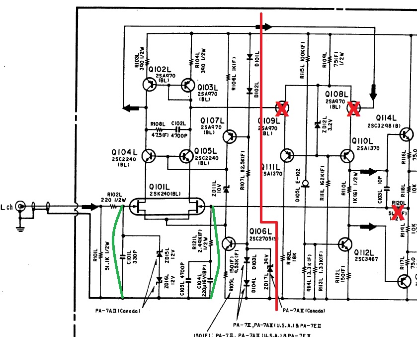

So I'll go ahead and post the next test for you to perform if the bases of Q108/109 still measure highly skewed from each other upon powering it up this next time with the ground wire mod I suggested earlier. I'm fairly sure they'll still measure off quite a bit.
I posted a picture for you for this mod. You'll be isolating everything left of the red line in this test from the rest of the circuit to the right of the red line. Remove Q108 & Q109 from the board, then lift one side of R120 to open the feedback circuit. Now add jumpers where the green lines are at. So you'll be shorting the two input jfet gates to ground, this will keep them on when you power up again. Now you're ready to power up. The input LTP should now idle with fairly even current between the two legs of R103/104 flowing through the two sides of that input diff circuit.
Measure the voltages that are going out to the now vacant Q108 & Q109 base. Are they balanced now or a lot closer than they were before? They may still not be perfectly balanced but they should be a lot closer. If they're not a lot closer then there's problems in this section of the circuit.
Let me know if you have any questions.
BTW if anybody else is following this thread and see's something that they would recommend testing please speak up!
Ok, I added a ground wire to the main cap star ground and verified with a meter that my RCA +/- are grounded to that. Just a reminder for those following along that Q116-119 are removed.
Q108L base: 64.6v
Q108R base: 64.85v
Q109L base: 74.6v
Q109R base: 74.6v
So that looks about the same.
ZD12L R109 side: 65.50v
ZD12L R111 side: 62.68v
ZD12R R109 side: 65.57v
ZD12R R111 side: 62.35v
Still getting about a 3v drop.
Unless there's anything else you want me to test in this configuration, I can proceed to put the amp in the configuration you list in your latest post. I probably won't get to it until tomorrow though.

Yes go ahead and perform the test I outlined in my previous post with the image attached.
If the voltages are still way out between the two legs of the LTP (measured across the bases of Q108/109) then I'm suspecting that Q101 is bad.
I attempted to set both boards up in the manner you described. When I plugged them in and powered the amp on, I got some smoke from the left channel. R103 and R104 were particularly hot. Despite checking with my DMM, I must have messed up the shorting wires on Q101. I'll check where the short is when I get a chance. But yeah, that's a major bummer.
So for now, I removed the left channel and will just measure the Q108R and Q109R bases to chassis:
Q108R base: 78.5v
Q109R base: 78.0v
So, a lot closer than they were before.

Yeah that sucks on the left channel hopefully its not too serious. Be careful when you power the left channel back up. I'd watch the voltage drop across R103 or 104 at power up. If its really high, like more than a couple of volts, then immediately shut the amp off. Some thing may have shorted in that part of the circuit and more damage will ensue.
Those Q108R/109R voltage measurements are a lot better. I would've liked to have seen them even closer because even a half volt at that point in the circuit is a lot of imbalance. Without any degeneration resistors to help on the output of the Q101 jfets even small differences between the devices can cause imbalance. But the second stage should be able to adjust for that small voltage difference I would think.
One other thing that I notice here is that the 108R base is actually higher than 109 in this test. In your prior tests Q108 was 10V lower. I would actually replace Q111/110 at this point. I know that they're measuring good with the tester, but something is bad in this part of the circuit when its loaded with full rail voltage so something is breaking down under higher voltages. I believe the KSA1381 is a match for those, the KSA1220 would probably also work as they're just a voltage follower. I need to look a the data sheets of them to verify that though.
You're kind of in a shotgun mode now. Things are measuring good and the tests of the right channel input LTP appears good. So we need to move to the next stage in the amp. Let me verify that those transistors are whats needed for Q111/110.

I'll order the 4148s as well, and will recheck the front end resistors before I order.
FYI, I found the reason my left channel was getting warm. I had shorted the wrong transistors, not Q101. Pretty stupid, but I think I was trying to work fast that day, which is usually the problem. So that means I had a short from Q104 collector and Q105 collector to ground. Which would also mean Q102 and Q103 collectors were shorted at the same time. I guess I should just pull those parts and test them, and probably will end up replacing them.
I haven't found any blown passives in that area of the input circuitry, but obviously I'm replacing the parts that got toasty.
I pulled Q102-105 and tested them, and they appear intact, which is surprising given how much current must've been flowing through R103L and R104L.

I'll wait to place my digikey order until tonight in case there's anything else you think I should check.

Okay that makes sense so Q102/103 would have seen around 200mA I believe. They're only rated for 50mA max so I would replace them just to err on the side of caution. In fact I would go ahead and replace Q102/103/104/105. No reason to leave something in there that might be questionable especially when the replacement parts are readily available and cheap.
