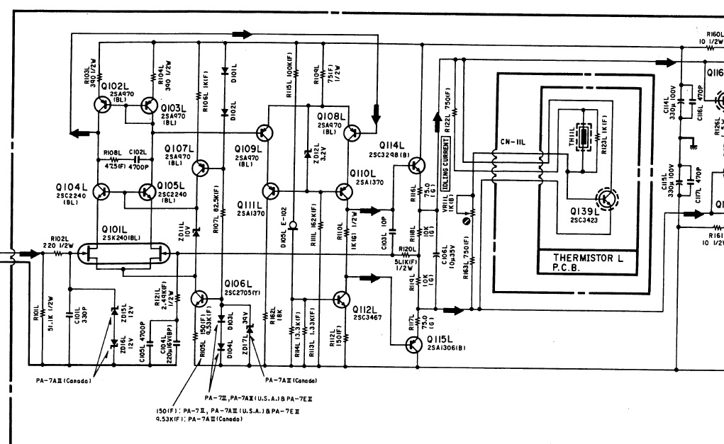

Nakamichi PA-7II won't power on, limiter resistor blown
Those measurements seem normal.
The fact you have full neg rail showing up on both channels bothers me. It still leads me to think that something is universally affecting both channels. Usually when I see channel failure its rare that both channels exhibit the same symptom unless there is a short but your measurements show there is not a shorted transistor on the output.
With the amp off and fully de-energized measure the resistance between the base of Q116 & Q117. This should be about 20k ohms or so.
I would find some where on the front end of the circuit to verify that you have full +/- rail voltage on the front end side of the 10r resistors R160/R161
Also with the amp powered on measure the DCV at the base of Q114 & Q115.

With the amp powered on, I can measure the +/- rail voltages at the Q114 and Q115 collectors. I probed all the pins on these transistors for completeness.

So it looks like the rails are ok as measured on these transistors too. Should I probe the transistors between Q114/115 and the input connector next?
The combination of R113/114/115 & D105 is a current regulated voltage divider network which should give you around -60V (in ref to gnd) on the base of Q112. But you are also measuring full rail voltage on the collector of Q112 from your earlier measurement so I would power down and check the resistance from C - E on Q112 to see if its shorted. This short would also explain the full rail voltage on the base of Q112.
It's possible the voltage divider I just mentioned is not conducting but this wouldn't explain the full neg DC rail on the collector of Q112. To me only a shorted Q112 or Q115 explains this. Even if q112 is shorted I'd still check that divider to make sure its dropping voltage across R115. The DCV across R115 (100k ohm) should measure well over 100V if that network is working properly. If its not then I'd suspect D105 which is a 1mA current regulator diode.

Hmm, definitely not shorted, but perhaps something else in circuit is making it seem as if it's not shorted?

the 95v seems out of place.
voltage measured on +rail side of R115L: 78.5v
voltage measured on +rail side of R115R: 78.6v
voltage measured on diode side of R115L: -16.05v
voltage measured on diode side of R115R: -31.9v
Seems like at least the left channel diode might be shot despite the reasonable diode check voltage?
So the R115 voltages sound within reason. That works out to .95mA on the L and 1.1mA on the right which are prob within spec for that diode even if it's going to give some differences between channels. Anyway that's not your problem.

So it looks to me like Q115 is ok in both channels, but Q112 is bad in both channels. I am confused why I'm getting a voltage drop in cases where I should see OL. It seems like failure modes for transistors should only go from having a voltage drop to NOT having a voltage drop.
I see some people recommending the KSC3503 as a replacement. It's a different package, but it might fit. Thoughts?
Q112 is just a current source passing about 4mA. The selection of the 2sc3467 was most likely due to the fact it was a readily available high voltage 1W transistor. For this reason the KSC3503 should work fine if you can fit it in and the higher voltage rating and the slightly higher Pd will be a plus. The ZTX657 is also a good fit size wise but would require swapping B & C legs.
I'm not really sure why Nak chose to use the D105 (E-102 CRD) in the manner that they did and not just use a pair of diodes like they did on the current source (D103/D104) for the input LTP. The only reason I can think of is that Nak is using this as a slow DC rail bleed off after power down. There is no added DC rail bleed resistors anywhere. Maybe someone else more knowledgeable will chime in as to whether there's another reason they chose this CRD instead of a pair of diodes for this current source voltage reg.
Either way I would replace both of the CRD's while you have it apart.

One thing I forgot to mention is that R113/R114 are in parallel so you should measure 1.21k across R113. I notice that you measured 1.32k across R113L, this should mean that either R113 or R114 resistance is out of spec. You will have to check them with one leg lifted.
Resistors are soldered back in place and I'm now getting 1.2k for the parallel network for both PCBs. Before I started work this morning, I remeasured the left board and definitely still got 1.33k for R113L. Looking at the right channel, I see there's a solder bridge on one side of that resistor pair, but there wasn't on the left channel. There must've been a PCB routing error that was meant to be addressed with a wire or solder bridge, but that didn't get done on the left channel for some reason. Very strange!
The missing solder bridge was probably an oversight by the person that assembled the board originally. It doesn't doesn't like much of a shift in resistance but that small shift in resistance took the current through Q112 up from 4mA to about 4.8mA which also moved the power dissipated by Q112 up by 20% as well.
I'm still trying to get my head around how Q112 would have failed in both the left and right channel especially when only one channel had shorted output devices in it. To me this points to a deficiency in the circuit that allowed a failure of Q112 in both channels when the transformer was heavily loaded in the second or so it took the main AC fuse to blow when the R-ch outputs shorted originally.
