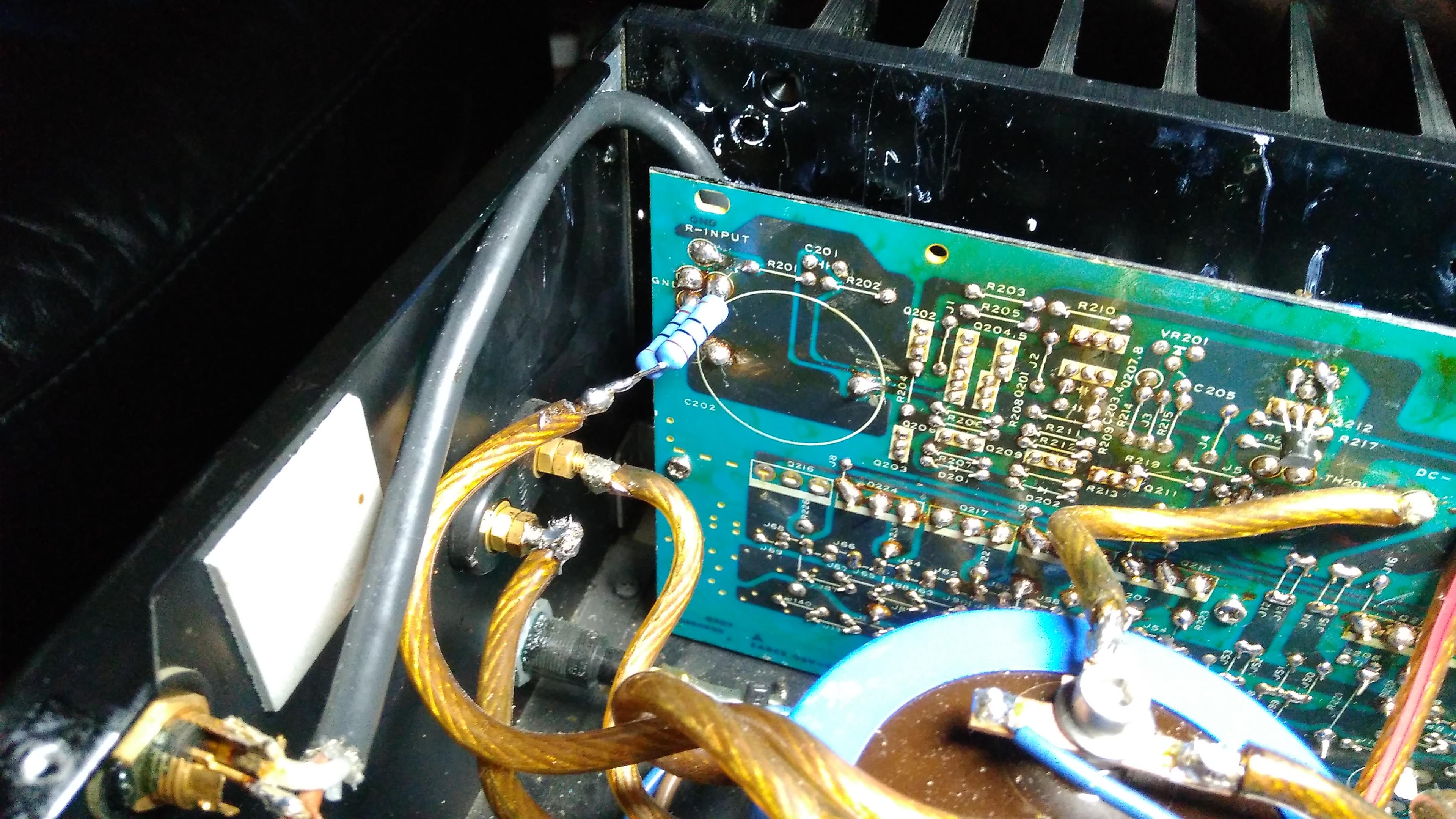

Today i had installed a 5, 10 and 20 ohm resistor from the input ground to the main ground.
The Result:
The hum is gone completely with the 20 ohm resistor. With the 5 and 10 ohm resistor there is a little bit hum remaining, but so few that i don't hear it from sitting on my couch.
The sound changes in this form that if the resistance is higher it's loosing more - i will call it - precision and dynamic for my ears. So i let 5 ohms. See photo.
There is also some kind of few sough from my Tv that is connected to my amp remaining.
It's not the antenna.
Next days i will change the small capacitors and i could order a matched pair of mylar capacitors 10uf 250V from the US made in Taiwan that i will exchange also.
It's part c102 and it's in the input line from the 2SK240.

The Result:

Much reduced hum 🙂 Well that's good
Be careful if you start swapping a lot of parts. Always fit like for like values and check your work carefully before switching on. Any little solder blob or short could be disastrous.

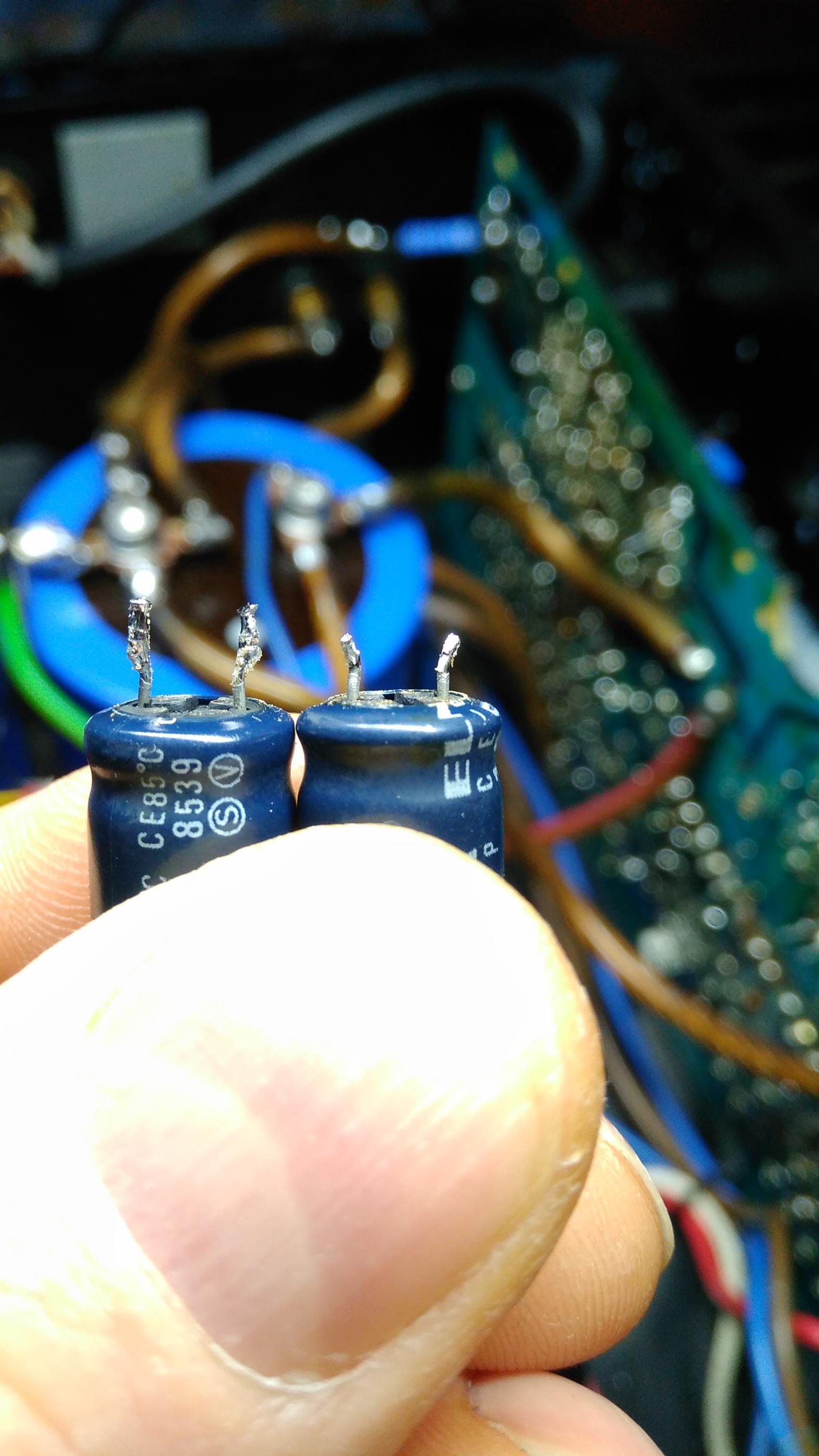

Today i had changed the small capacitors.
Two are looking inflated a little.
For testing i removed the hum braking resistors.
There was the same hum like before.
So it had nothing to do with the capacitors.
I installed the resistors again. This time 3.3 ohm.
This works also. No more hum.

Perhaps you had a different configuration of equipment and source components using a different combination of mains grounding.
It is always hard to tell from pictures whether a part is OK or not but those caps actually look fine as far as visuals go.
In circuit locations that see a high ripple current it is often the other end of the cap that distorts (where the vent is) as the cap ages and deteriorates.
Do a Bing or Google image search for 'failed electrolytic' to see examples.
