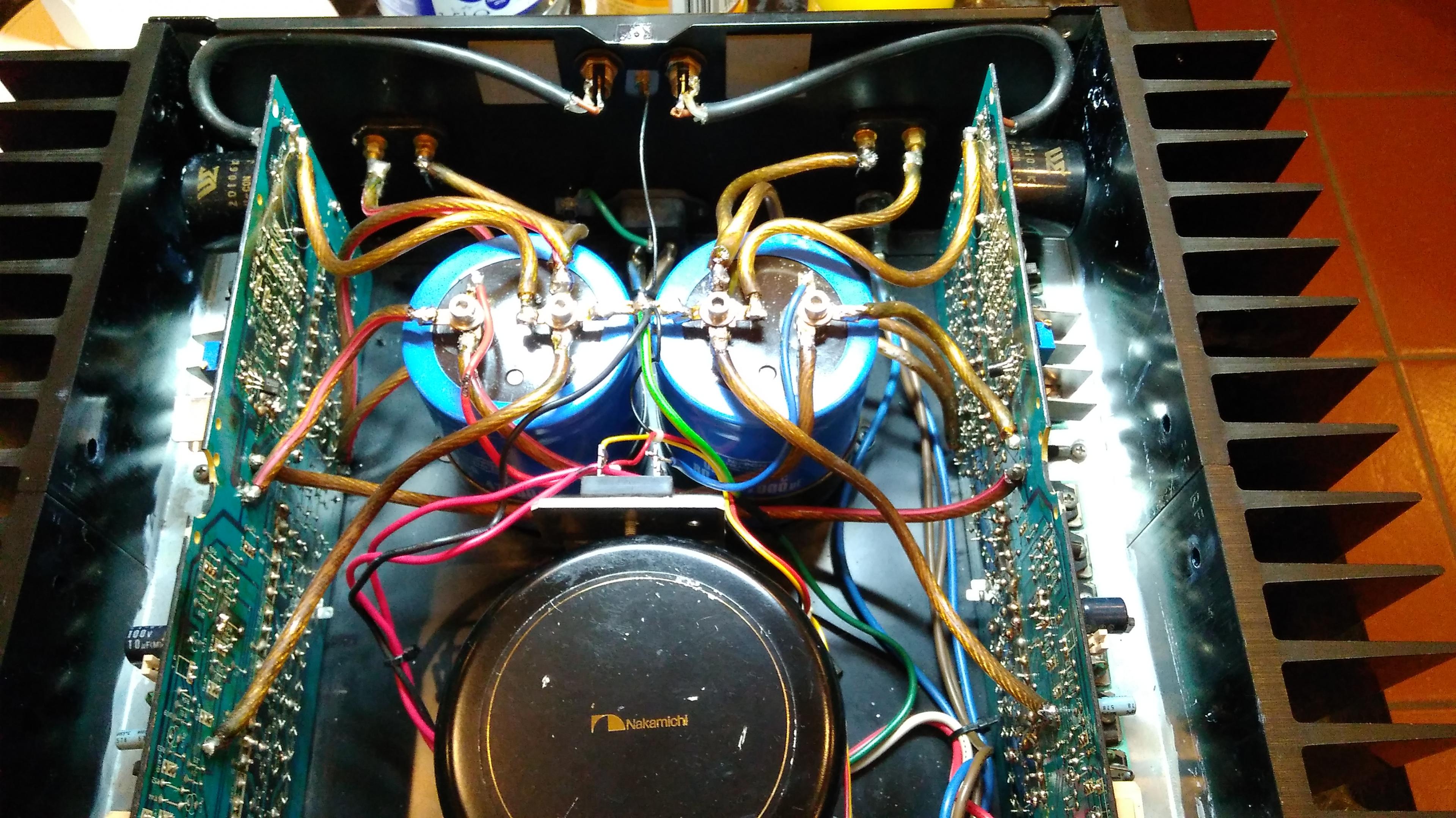

Hello,
maybe you can help me with a humming about 30 years old Nakamich PA 5 please ?
If i don't connect input cable then there is no hum.
If i connect just one input cable for one side then there is no hum.
If i connect two for stereo input this amplifier makes a hum that you can hear from about 5m distance.
I tryed different cables.
I can connect my smartphone or my TV direct to the PA 5e, all the same hum.
I had only connected the PA 5E to the Power net for testing, nothing else was plugged in,
input with my smartphone and have the hum.
I can also connect the CA 5E II pre amplifier without power plugged in and have the hum.
I tried to use a AC powerfilter with no success.
I bought new 47.000 uf capacitor, no success.
i installed new trimming potentiometer for exactly adjust the bias.
The problem appears when i set the bias to 40mah like the instructions say.
If i set it to zero then there is no hum.
If i use an input filter the hum is gone also with the disadvantage
of worse sound.

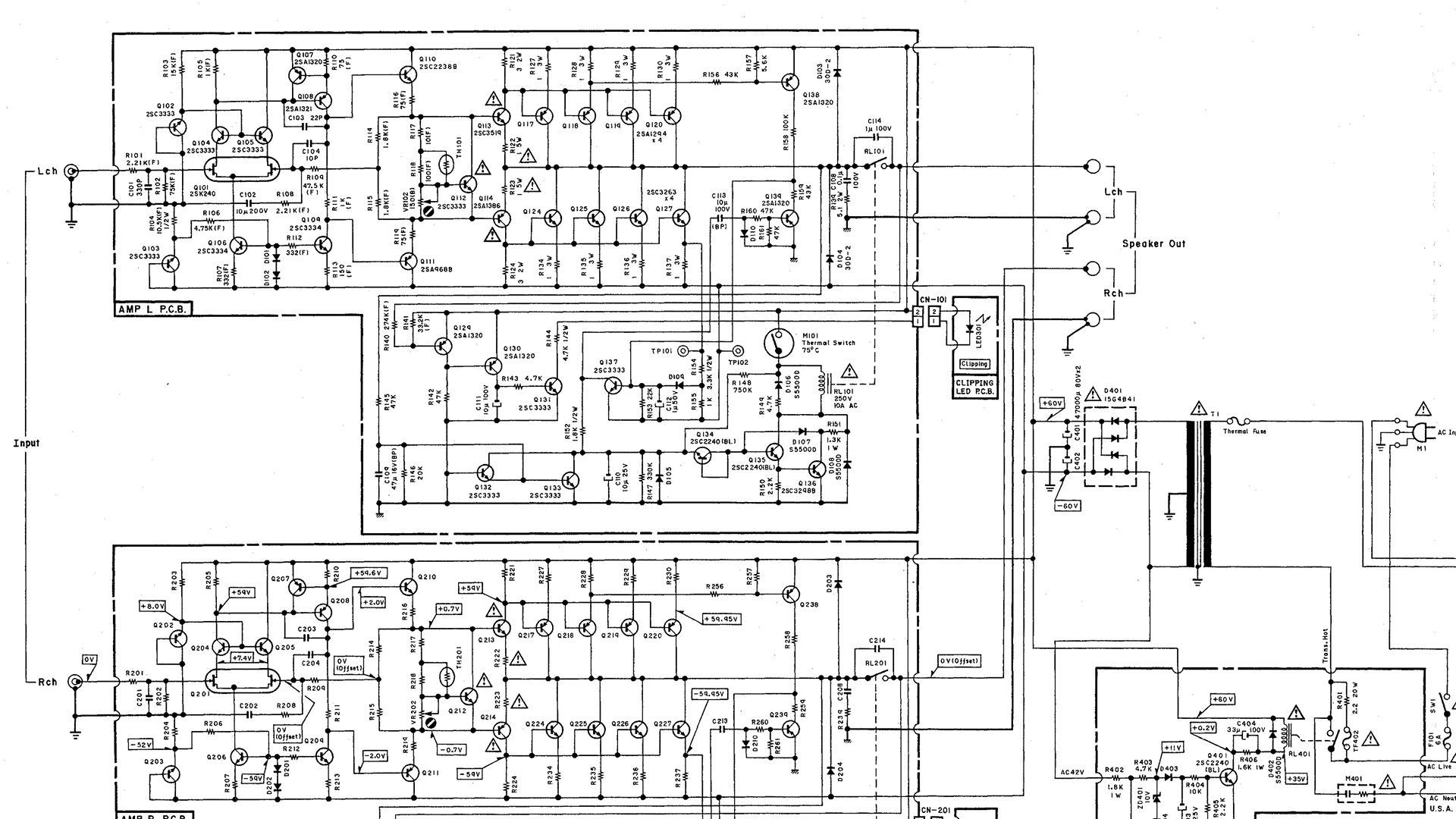

I have attached a screenshot from a part of the circuit plan.
Do you have an idea wich component is maybe broken ?
Best regards from Germany

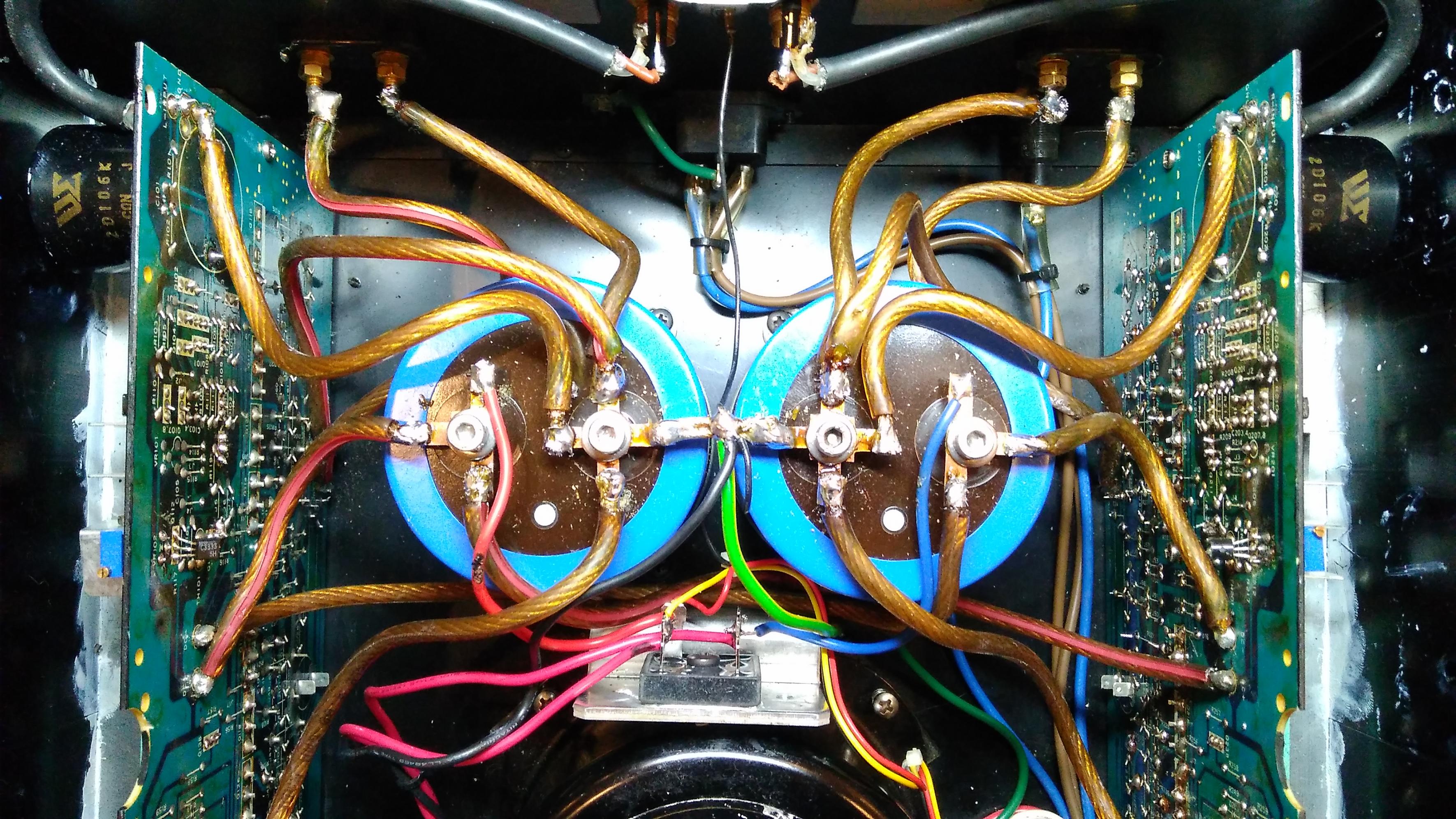

you need to do three things.
a.) read D.Joffe's paper
b.) examine the PCB and see how Signal Return is connected to Speaker Return, on both channels. A continuity tester may help trace the routes/connections.
c.) determine if D.Joffe's HBRR & HBRL can be fitted in the voltage reference link between Signal Return and Speaker Return.

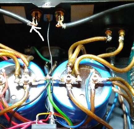

I've no magic answer I'm afraid as it would need a detailed look into how the grounding was configured. I think also that you should probably concentrate on setting the bias correctly and then leaving that alone.
You could try as a 'quick fix' (and with no guarantees) adding a low value resistor in series with the signal ground to one channel. Easiest place to do that is at the input socket. Try a 10 ohm 0.5 watt and see if it improves things.
I replaced the large cap's already some days ago.
Mooly i have read and what i understand is that the input and feedback circuit must be connected via 10 ohms to the ground star. Thats all, right ?
What I am suggesting you try is this. Just desolder the ground wire from the socket and add a series 10 ohm. It will either make a difference or it wont.
I wouldn't like to advise you to alter grounding within the amp because I'm not familiar with the layout of it all, and it would be easy to cause big problems if something went wrong. Its something you need in front of you to see how its all interconnected and what goes where.

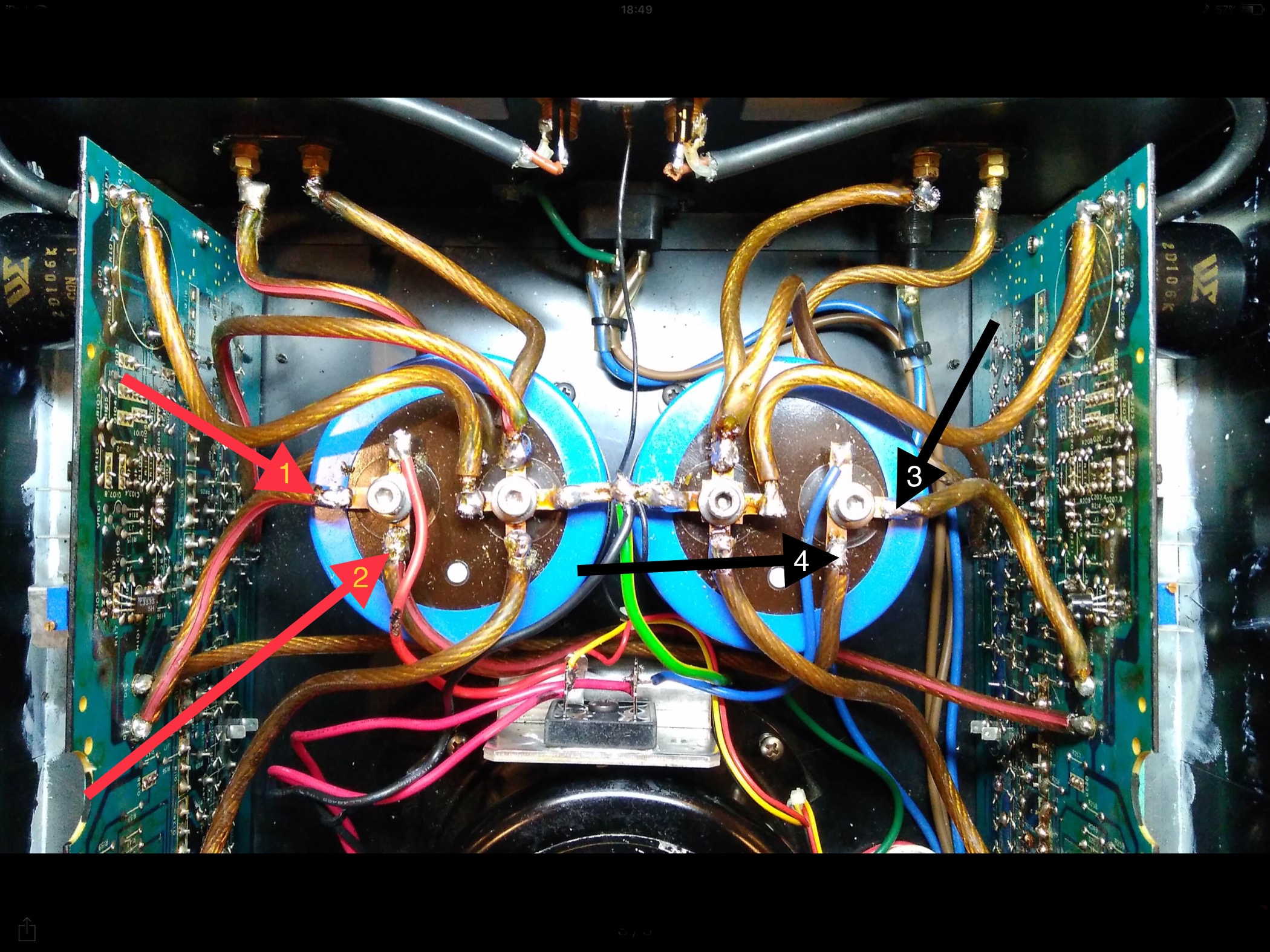

Is it usual that i can measure with a normal voltmeter 274 Volts AC over the plus and minus from the two 47.0000uf filter capacitors measured in one direction only. The other direction 0V AC.
You have to get to the bottom of this 247V a.c. You can make progress in this by disconnecting both channels by removing leads 1,2,3 & 4 labeled here:
Now check d.c. and a.c. voltage across C401 you should see 60V d.c. and a few hundred mV or so a.c. - then check same across C402.
When you have good solid + / - 60V d.c. connect up one channel (1,4 or 2,3)
Twiddle with that channel, setting bias and whatever, when you’re happy disconnect it and do the same with the other channel.
This is a basic binary chop procedure after which you’ll have a much better idea what’s going on.

You think it is safe to remove this cables like you say and turn the amp on ?
