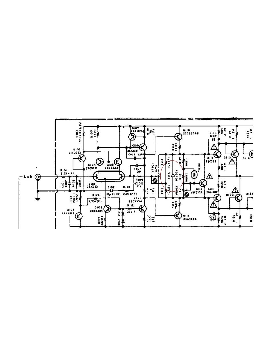

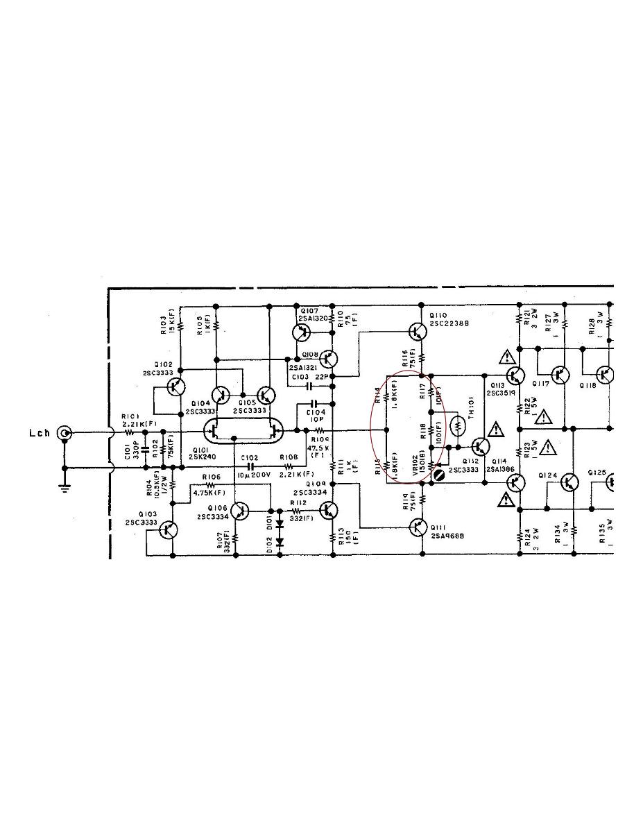

It's the "they can't hurt" part that I was concerned about. Without knowing if it was part of the original Stasis design, combined with not finding it in the other amp, is why I questioned it.
I was just trying to figure out if it was there to make the amp as stable as possible across the widest possible audience at perhaps a slight degradation of the sound vs running it a little more "risky" to get that extra margin of performance.
I would assume that Nak would have tended to lean on the ultra conservative side as they likely wanted the most reliable product possible.
As I mentioned, I don't have the design knowledge, so I didn't know how to interpret its purpose but was looking to eek out the best performance possible. Hence why I asked.
