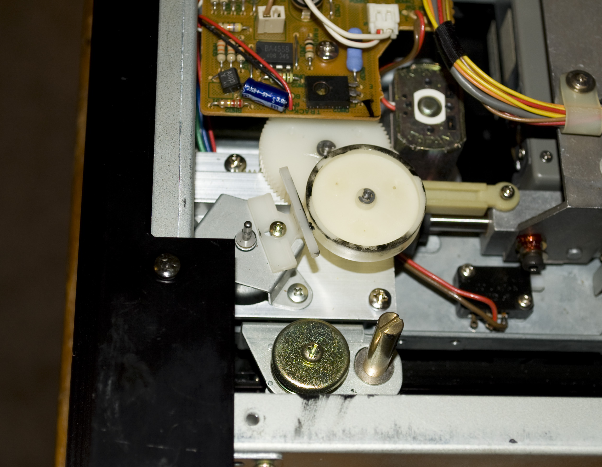

Just want to share my experience in lovely OMS-5 repairing. Some time ago I noticed occasional sound interruptions. Discs and tracks have been recognized without any problems. When I tried to recline and put the player on the side the sound distorted more and finally cut out. Looked like there is some tension in spindle shaft and error recovery system can't recover. And I was right! So I took out the spindle motor and put a small drop of good oil on the shaft between round plate and bearing sleeve. I used a toothpick for this operation 🙂
Now it plays like a charm! I believe original oil been degraded over the years.

It will get clogged with dust. The original lubrication is not oil but fine mechanism grease.
Thanks for reply 🙁
Don't you think "fine mechanism grease" may get clogged as well? Original grease became a black sticky mass like a caoutchouc.
