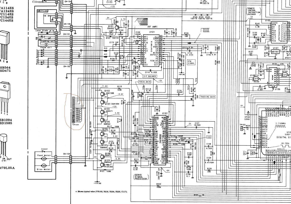

Previously, I had measured all clocks and voltages as specified in the schematic. All clocks looked stable and were in frequency. Voltages were fine too. What is disturbing is that the with the old laser unit, I could see the laser but it was very dim. Not as bright as another Sony CD player that I observed today out of curiosity. It seems that U101 is driving the laser diode and I am wondering if it is a defective IC.
The new laser unit does not light up at all. It did not have a short but has a capacitor that I have not removed. It could be that the removal of the capacitor may do it but I am hesitant. Previously Mooly had suggested too that it not be removed.

U101 Pin 28 is the FOK output pin. This pin I suppose should go either high or low once focus is detected. (Mooly had pointed this out previously)This pin does not change state and is noisy. Given the fact that the laser unit has been replaced and voltages at various points associated with U101 as shown in the schematic are correct, it may be that U101 is defective. Any thoughts.

U101 is CXA1018S. It is not getting hot.
U101 has a output FOK pin which should change state if focus is ok, I think. It never does, hence my suspicion. The FOK pin from here goes to CXA1082BS as well as the MPU. My thought is that if FOK is not detected by the the two ICs, the sequence of operation stops.

You have done all the right things so far... and I'm afraid I've no easy suggestions left. Having got the same symptom with the original pickup and now two replacements (and we had to try those... and think the worse that the first new one could have been suspect) means you are moving into more difficult territory. Complex IC's like the CXA are always always way down the list of suspects in any fault like this. Only when everything else has been checked do you even begin to think of replacing them.
If I was faced this on the bench I would use a scope as a voltmeter and go around all the rails and all the pins on the servo and syscon IC's and look for anything obviously amiss such as an obvious wrong logic level (like a reset input) or some indeterminate state somewhere. Not easy but you can get lucky. Don't assume anything, scope every pin, even the ground... you never know.

CXA1081 is a bad IC. We replaced many in repair service.
