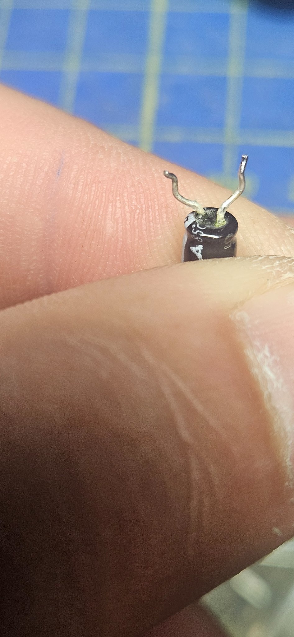

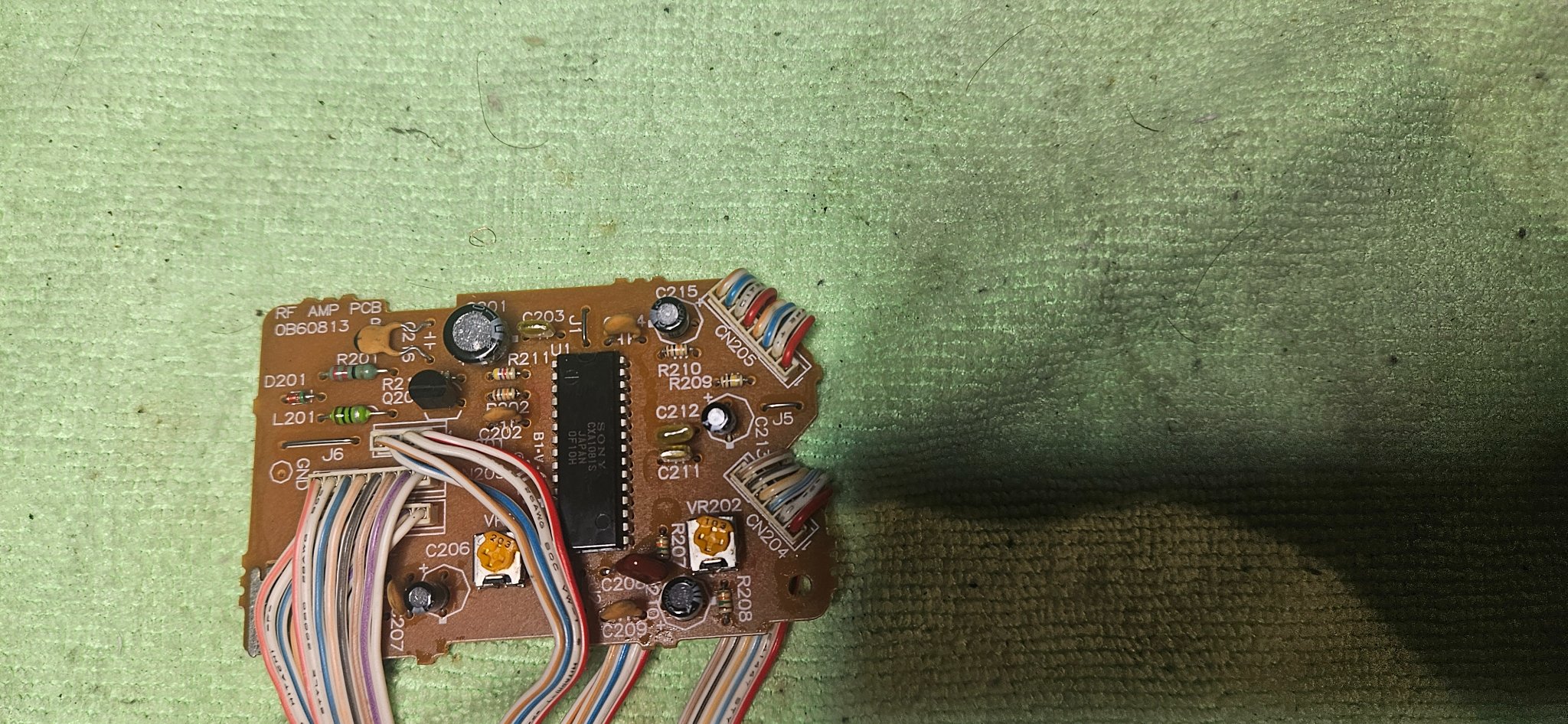

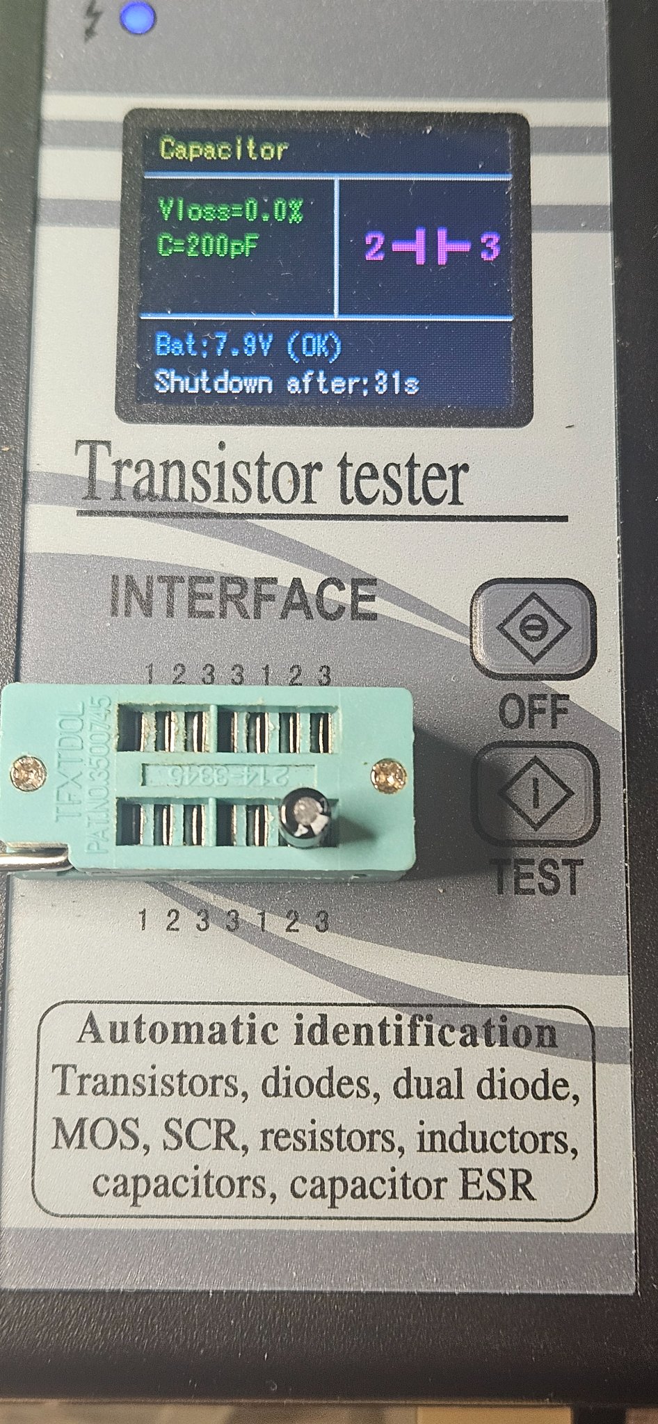

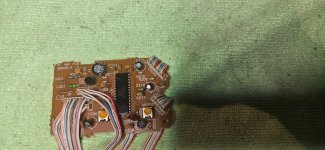

I have a Nak CD Player 3 that was reading the TOC but playing very raspy and distorted sound. I inspected the RF Amp board and found a bad capacitor (C213). This capacitor is 0.47uF 50V. It was reading 200pF. Replaced it and all is good now! The other caps were good but replaced them anyways. Thanks @Wolf Freudenberg !!
