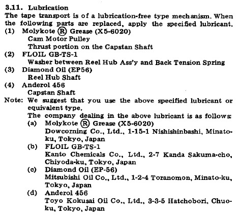

Netlist said: View attachment 1352713 Click to expand... Apply a wee tiny amount less than a drop of some light lubricant to the flush end of the shaft on the flywheel. I used a light sewing machine oil ages ago on an LX-5 with the same symptoms and it did the trick. Good luck
Jan Dupont Member Joined 2003 audiocircuit.dk 2024-09-06 10:53 am #22 2024-09-06 10:53 am #22 Thanks Chris 🙂 All ideas are welcome! Jan Dupont Member Joined 2003 audiocircuit.dk 2024-09-06 10:54 am #23 2024-09-06 10:54 am #23 Thanks Seraph. That I will give a try 😉 Prev 1 2 First Prev 2 of 2 Go to page Go You must log in or register to reply here.
