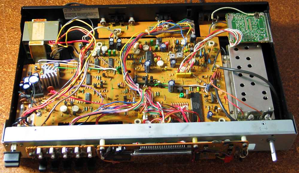

Hiya,
I have a Nak ST-7 here that has no display at all.
All else works fine.
Was hopeing someone here either has a schematic or can point me to the fault.

Hi MadMutt,
Sorry, that's one I don't have yet.
The fault should be easy to troubleshoot.
Firstly, does it work otherwise? If so ....
Look for bad solder connections.
-Chris

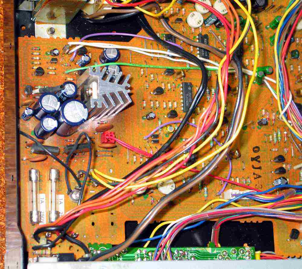

Hi MadMutt,
Normally the 3.3 VAC tap is biased to - 20 ~ 30 VDC -ish. The regulators often go open. Either the digit pins will have a + supply or the heaters will be tied to a - supply with the segments going to + 5 VDC.
Measure around the power supply with your meter. Can you please post a photo of the power supply area?

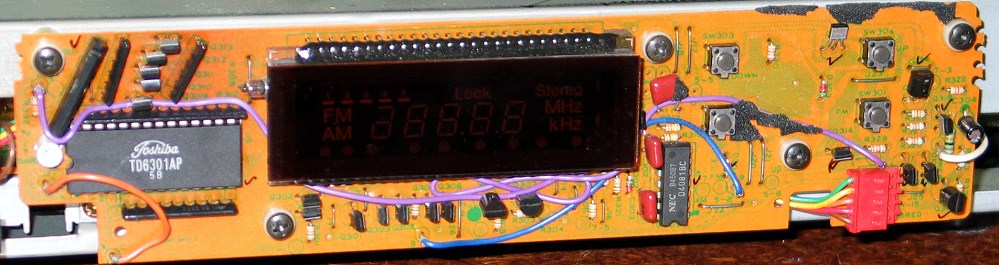

After a bit of playing around (not easy to pull apart in some areas), I think I've narrowed down the fault to the actual display board.
When I use the display board from the 'not spare' unit, it works fine.
Guess that means the vfl is shot.

Hi MadMutt,
See all that dark brown "glue"? Remove it. It can go conductive and corrosive.
-Chris
No, not unless the filament is open. Check for your voltages (compare). Check the display uP is running (need 'scope). It might be fine once you clean it up.Guess that means the vfl is shot.

Any idea which pins on the display are the heaters ?
Wondering if I can check the actual display.

Hi MadMutt,
The two pins on the outside are generally the filaments. Often two are shorted together on each end, look at the leads. If you unplug the board, compare the resistance between those two points on both boards.
