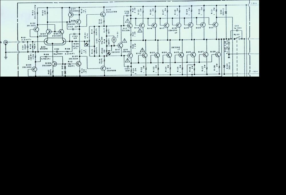

Maybe someone want to clone great Nakamichi PA7?
I do. I have service manual but I have to scan.

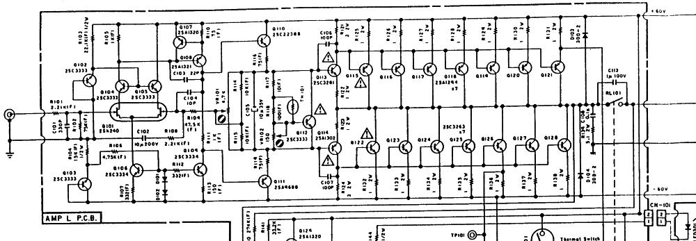

Schematics
Amplifier (one channel) 362k TIFF
Power Supply 156k TIFF
Unfortunately I only have a rather poor quality copy of the service manual, so some of the text is not readable.
Thanks oPossum,
That's the beast. There is still the mod PCB for the current limiter we need to find.
If the text were more clear .... Can you scan the main PCB to give others an idea of the size? 14 outputs per channel doesn't seem to convey the idea like a picture.

This design has a characteristically poor HF PSRR so you will be listening to PS artefacts so best to eliminate those half wave Class AB ones in the most inelegant way possible - by wasting power running such a monster in Class A.

Hi Greg,
Have you had a chance to hear or test these amps? Just curious.
What you say might be true, but they sound very smooth. The front end looks well isolated from the supplies. No worse than many others and better than some.
The outputs were run warm because they are not in the feedback loop and needed to be run in a more linear part of their curves - Stassis you know. I can think of a few other amps that ran at least as warm as a normal A/B with everything in the feedback loop.

Hi anatech,
It uses a typical (albeit cascoded) diff'l input followed by a high gain Vas and miller comp which kills HF PSRR so it needs clean supplies to sound any good. Class A does that (and linearises the outputs). There are far more elegant ways of achieving the ends without resorting to Class A.
I don't see any surprises here - nothing to hunt one down to audition. It should sound smooth - I guess because it faces none of the hard challenges but sidesteps them with Class A.
This is Sooo characteristic of the monster amps that solve nothing really well and can be easily blown away with a sweet little low bias Class AB 1/10th the size.
I guess what really irks me about such products is that they perpetuate the myth that this is necessary to achieve audio nirvana when all it really does is salve small appendage syndrome or a need for excess, neither of which I believe in.

I want to use parts from onsemi (samples) if it is possible. It is AB design - idling current is only 40 mA per one transistor.

just want to make clear:
is there no global negative feedback fo the said amp?
or is it already the one that is through a trimmer res. from the pre-driver with vbe multiplier
stages?

bra said:little better
Can we see where does it go that path going down from the output?
